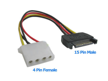

Got the FL1009 today but almost fried my motherboard. The molex adapter that comes with the card will not fit into the standard drive sled connector so I clipped the two ends. I guess that this was a very bad idea !!! Is there a better molex cable out there that I dont need to modify that will fit snugly in the drive bay.I saw a little puff of smoke and I can actually see melted plastic on the connector. Would I have expected to see anything different connecting to the molex connector on my optical drive bay?
Can people comment on how they got the connector to fit. All else on the computer looks like its OK, thank god. I am about to give up with trying to expand my mac pro. I've had zero luck with SATA or USB3 add in cards :(
Now that I compare the pins on a sata drive and the FL1009 bundled connector I see that the pins dont seem to line up. My SATA drive that I am using for comparison has more "longer" pins than my connector.
FYI, I can see the card in System Prefs but I assume that the drive wont power anything until I plug in the molex power? Would I see anything different if using a powerd hub?

I just got this today: Fresco Logic FL1009-200
It came with the SATA to Molex adapter, I installed it by clipping 1 end off, no problems here, it works without installing\hacking any .kext's, and is transferring at USB 3.0 Speeds!!!
The end of the adapter that I cut off would be the left side in this pic of the connector.
the left side is the one with the plastic tab pointing 90* up.
the right side is all flat, that side you can\should leave the connector, that will ensure it lines up properly when installed. I think that's why you fried yours, because with both sides cut off the connector can't center itself, it needs at least one side.
Connectors are keyed for a good reason. By clipping them off you've disabled the built-in safety barrier.
I didn't want to lose any drive capacity, so I used the optical bay power.
The instructions are here:
https://forums.macrumors.com/posts/16621185/
There are two cables involved: [1] The Lindy cable that acts as a Y-cable (so you can still have two drives in the optical bay) AND converts the SATA power to Molex power. [2] The molex extension cable that runs the power from the Lindy cable in the optical bay all the way to the card.
A few other people have used this method and reported success.
If you are having cabling anxiety, you might be better off buying a card that doesn't require external power.
