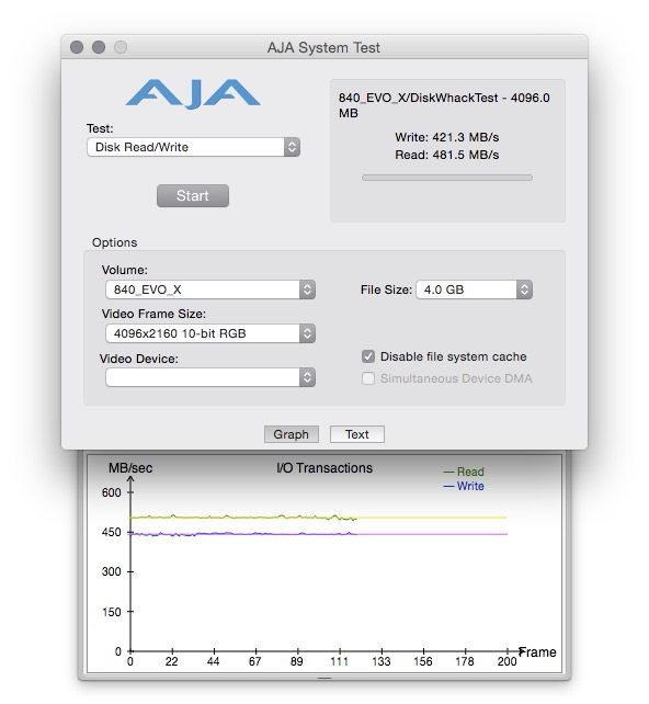

My final shootout testdrive:
2x 840 EVO RAID0
USB 3.0
sSATA
EDIT: Any thoughts about the spikes in the charts?
The StarTech is - for now - a definite to-keep for me and forms a great combo with the CalDigit FASTA6PRO! I choose this model for the boot capability on the Mac Pro. The offline disk-duper is a bonus! :cool:
Cheers...
That USB 3 is slower than eSATA was expected. But only 483.3 MB Write and 505.6 MB Read in a RAID?
I thought one 840 EVO could reach this nearly alone.

That USB 3 is slower than eSATA was expected. But only 483.3 MB Write and 505.6 MB Read in a RAID? I thought one 840 EVO could reach this nearly alone.
As far as I've done my research correctly: Data transfer speeds up to 600 MB/sec.
FASTA 6GU3 PRO
840 EVO (no raid):
Still trying to push this card to it's limits. Any thoughts to accomplish this? TIA!

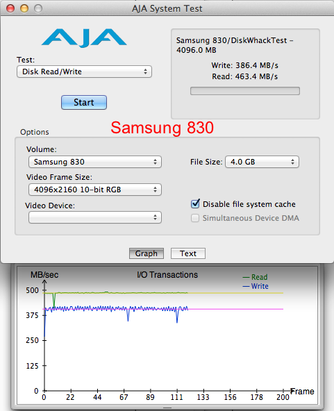

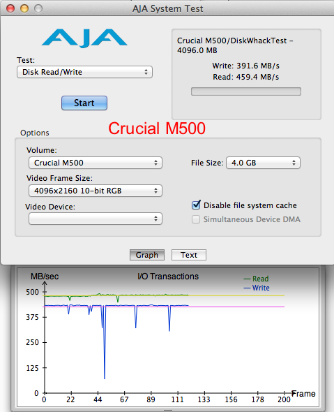

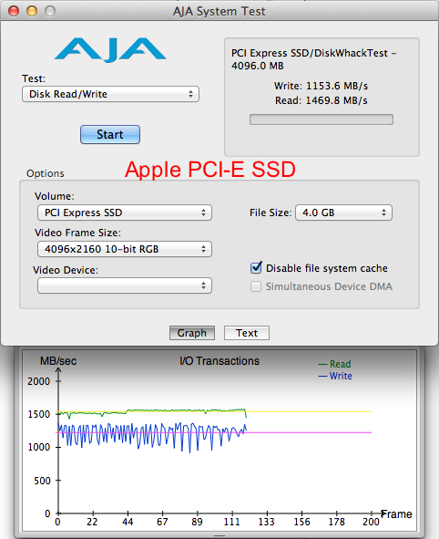

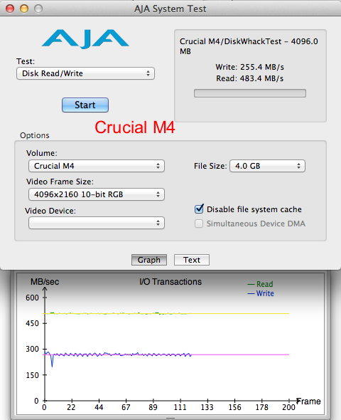

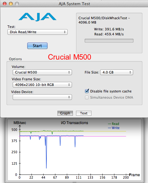

I was planning to install a RAID with 2 Crucial M500 960 GB SSD's, attached to the Caldigit FASTA-6GU3 Pro card.
The only advantage would be to have a real big SSD, but not the performance, i suppose…
Disillusioning. :rolleyes:

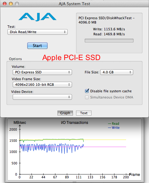

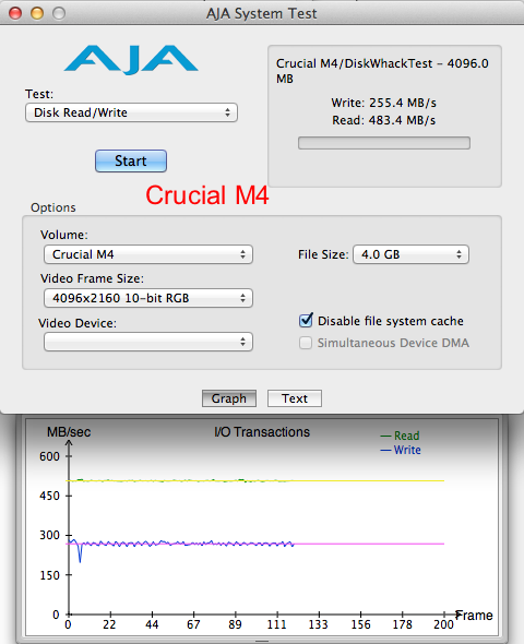

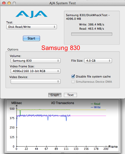

Update: Tested now all my drives attached to the Caldigit FASTA Pro card, i think at least write speeds would benefit in a RAID 0 a little bit.
However, my preferred scratch disk will remain the Apple PCI-E SSD, three times faster than my SATA SSD's.
But still like my Caldigit card, because of no compatibility issues.
My point of view also! No issues so far and a great combo card that uses only one PCIe for USB 3 Photo Card Reader and eSata for my bootable CCC back-ups!
