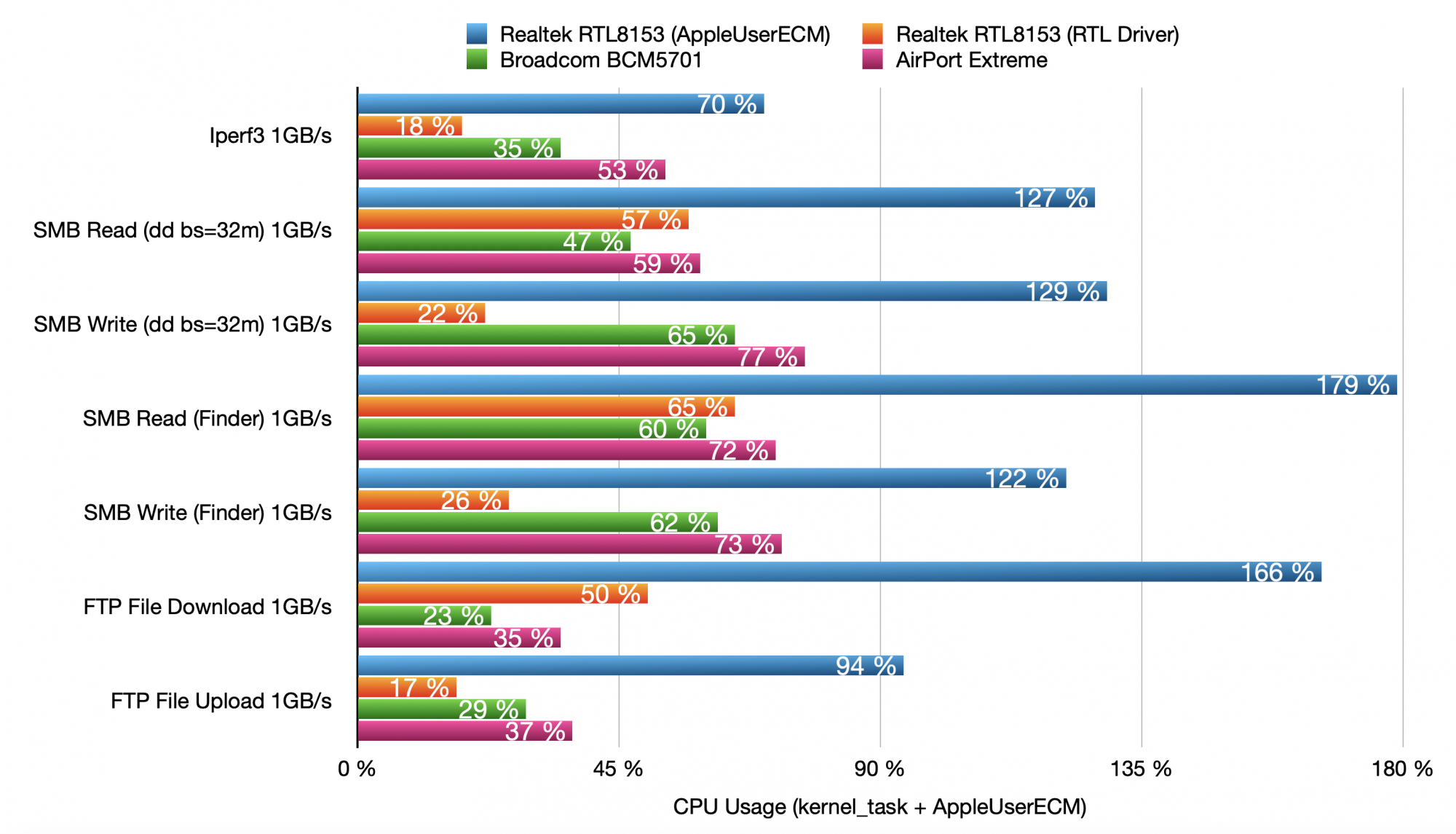

All those adapters (very likely) use the Realtek RTL8153 USB NIC. Apple ships no driver for them. Instead, the NIC also supports basic CDC-ECM mode which macOS does have a driver (AppleUserECM) for. In this state, there's no offloading which means: All the heavy lifting (checksumming,... ) is done by the CPU instead of the NICs hardware which a) causes high cpu load during high network activity and b) can cause instability with some implementations.
Realteak had a driver for macOS up to Catalina. Apple blocked the kernel APIs for USB based NICs in Big Sur (and replaced them with DriverKit userspace APIs). Not sure whether Realtek will rework their driver, or just abandon the Mac platform for their drivers.
Some older adapters used ASIX chips. They must be used with a proprietary driver as they didn't supported the CDC-ECM mode.
There are no other USB based GbE chips that I'm aware of on the market. Only solution is thunderbolt, but that's expensive (either Apple's Thunderbolt 3 -> Thunderbolt 2 -> Apple GbE adapter) or one of the various 10GbE adapters that use the Aquantia Chips. macOS includes several drivers for Aquantia Chips (at least the Intel version of macOS). Some vendors say that they will not work with the M1 (yet).

It does.. That's why I still use the old Apple GbE TB2 dongle. Yeah it's clunky with the double dongle but it at least works without causing insane CPU load for just copying a file to the NAS.
I made a simple test last year about that. Using USB NICs in ECM mode on a Mac is crazy. That's not an Intel/ARM problem. That's just a lack of proper drivers thing.

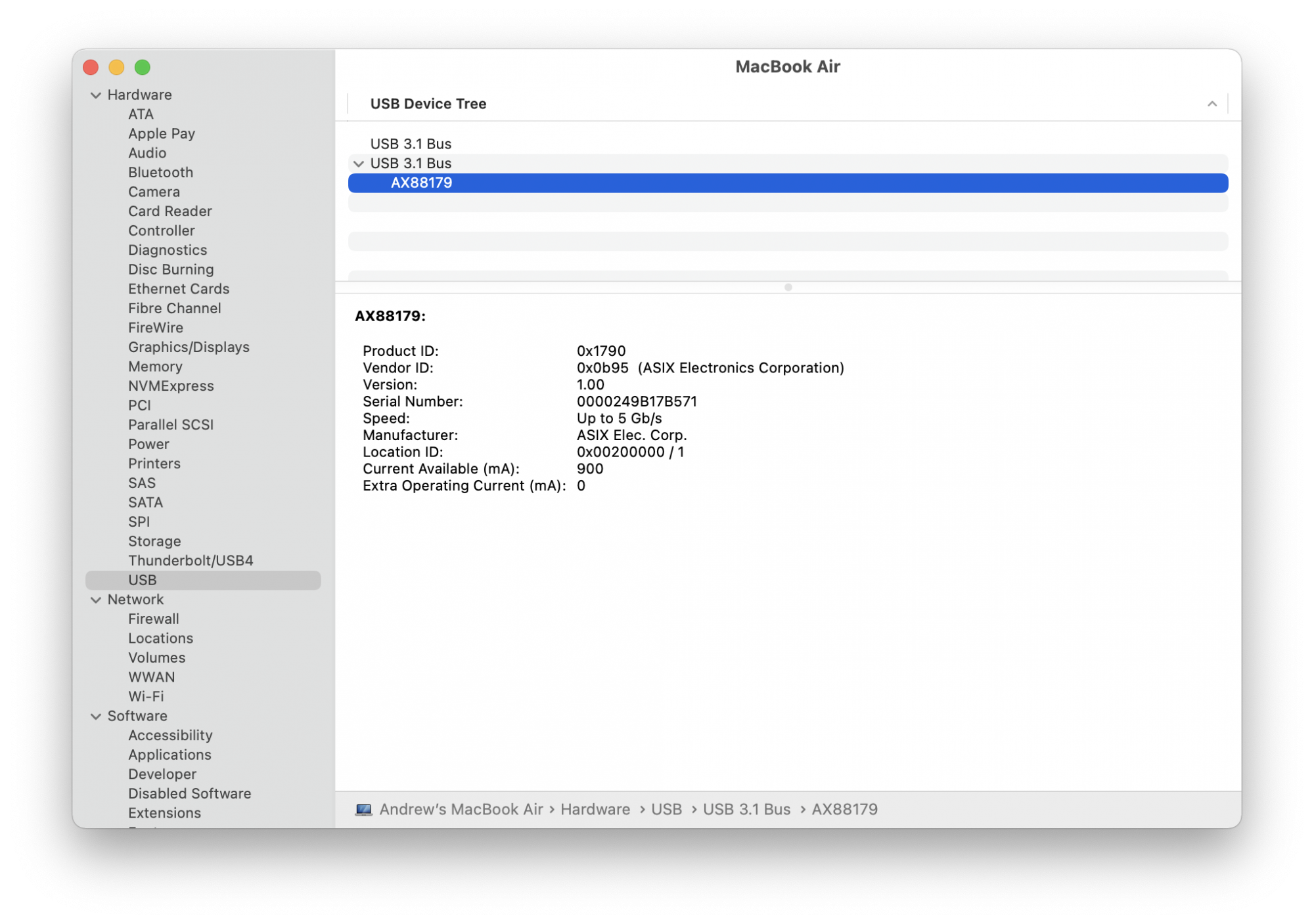

Any idea on how to make ASIX-based adapters work? I have a whole bunch of StarTech USB31000S that don't work on M1s. I'm not too thrilled about it
Edit: Actually, it looks like the latest macOS driver on StarTechs website is Version 2.16 (2020-02-21), which says it supports macOS 10.15 and above (obviously not true). When installing on Big Sur on M1, the system extension is blocked. It looks like I just need to wait for a (hopefully) updated driver.
From what I read online, there is only a beta driver for Big Sur from ASIX. It's for both Intel and Apple Silicon.
This is the official direct download link directly from ASIX:
ASIX_USB_Device_Installer_macOS_11.0_Driver_v1.0.0d3.zip
You can also find it here: https://www.asix.com.tw/en/support/download
But: You have to do some steps to get it working that you might not want to do:
From their README:
Code:
This is a beta driver.
The following steps are necessary to enable Develop mode.
1. Disable SIP in Recovery mode then reboot.
2. Enable System extension develop mode. Open the Terminal and issue the following command.
   $ systemextensionsctl developer on
Reactions: AppleTO
