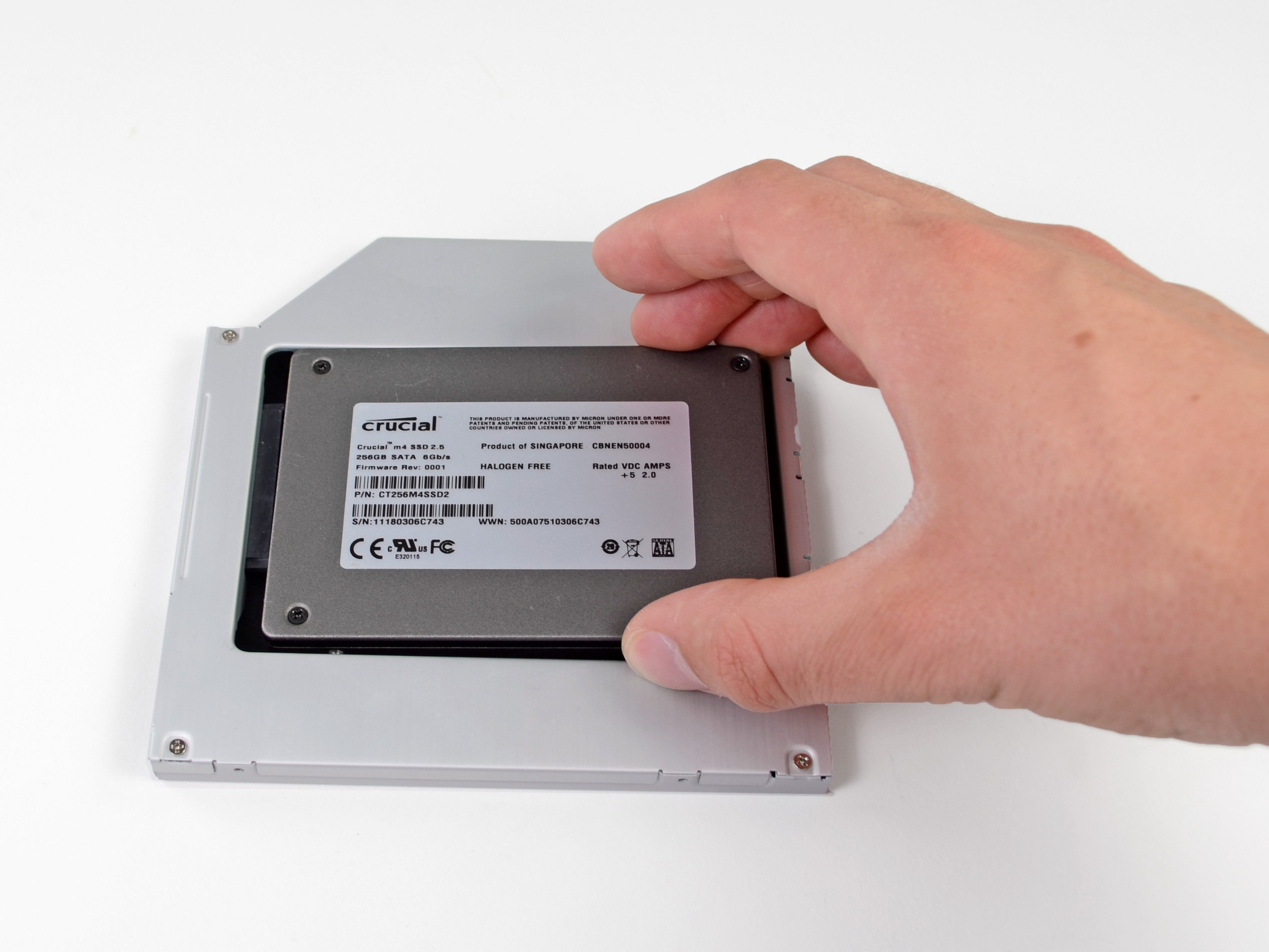

I have a 2009 iMac 27" with a Core2Duo 3.06 that still gives great service as a basic email/browser/MSOffice computer as well as external screen for my wife's work Toshiba laptop. Its has 12GB of memory and an 240GB SSD and is still faster in real day use than the much more modern Toshiba.
I went the route of putting the SSD in the CD/DVD slot with an easily available kit. I found it had two big advantages:
- Leaves you with the original 1TB HDD for backup and storage
- Is a much easier job, as you only need to unplug one of the screen cables to access it to make the swap. Though some guides say you must, I found that you can hold the screen open with two chopsticks, or similar, while doing the work.
This is the iFixit guide:
If you go to Step 5 and click on the blue '25 comments' you can read half way down what I wrote in. It is a very easy change and you do not need anything to pull the screen off, a sharp knife and a couple of old credit cards do it very easily and you do not have an issue with the HDD thermal sensor, as the HDD stays in.
When choosing the size of SSD do remember that with this computer you do not have the option of adding fast storage later, as USB2 is NOT fast and sourcing old FW800 is not cheap, nor will be of any use in the future. That said, mine has 240GB and need no more for our usage.
Long live the 2009 27" iMac!

The caddy you need is one like this:
Your iMac is different though - you have the C2D model whereas the OP has the i7 version which I think is build differently? I think it's quite similar to the 2010 which I have - in this model it is easier to just do a swap of the drive; removing the superdrive is more involved. I might be wrong though.
[automerge]1593009098[/automerge]

It is possible that the HDD is in a different place, obviously the DVD is in the same place in all the models.
All I can say is that doing the DVD swap is easy and needs only one cable removed.
And the clone can be done on board.
At least now he has two choices.
I would recommend him that he reads that iFixit guide as well as the comments we all have added in, as it makes it easier knowing the possible obstacles.

Yes, I agree. If I were him I would probably spend the extra US$25/€25 and go 500 GB, that should mean no need for external storage.

Thanks for suggesting this option as well. It would be nice to not have to deal with the thermal sensor. I just have to decide if I think I’ll need the optical drive in the future.
Two good options — thanks to you and r6mile — either way I will be preserving yet another ‘09 27” iMac. This should hold me over until the Arm iMac arrives.
I’ll definitely be reading the guides and caddy link you sent — thanks for that.

The dual drive kit that I purchased at the time came with a USB external enclosure for the DVD drive. I have not now found any that do include it, probably because less of these changes are being done and there is less need for a DVD drive anyway. But I did find this caddy:
Fitting the DVD Superdrive in is very easy. I haven't used mine since I added all my CD's to iTunes more than a few years ago.
I did not know there was such a thing as optical drive caddies — pretty neat. Probably wouldn’t need it though, because as you said music could just be imported into iTunes.
The iFixit link showed a comment that made it sound like the optical drive bay connection would lead to a slower data speed than, presumably, the current internal hd connection. If this the case, it would make sense to stick to the original hd location. Does anyone have a thought on this?
