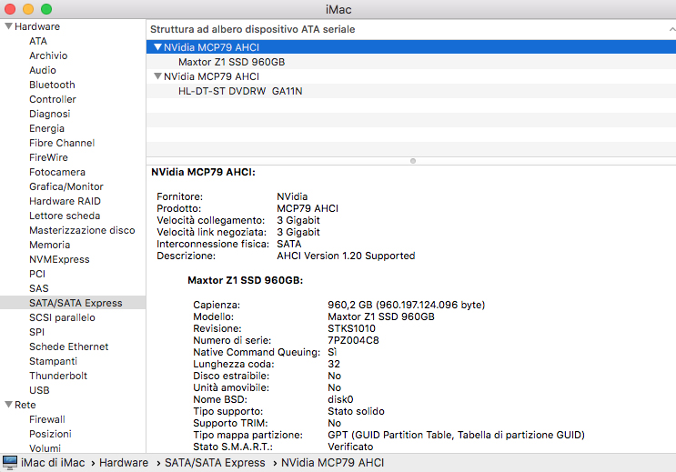

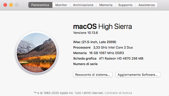

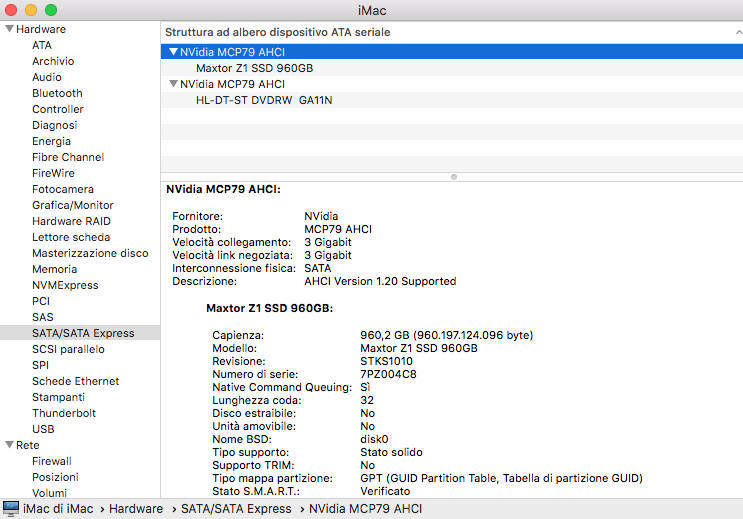

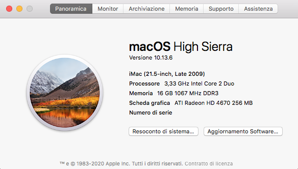

I'm here with an iMac 21.5-inch late 2009.
It works amazingly after SSD and Ram upgrade.
It runs macOS High Sierra without any problem.
Boot up 25 seconds.
Here my specs:
Best regards

Hi, Andrea
Wonder if you still uses the old temprature sensor of the old HDD after install the SSD?
This is not possible as the sensor is integrated into the hard drive, just accessed with a separate cable.
Boot up 25 seconds.
Here my specs:
Best regards
Andrea Filippini
