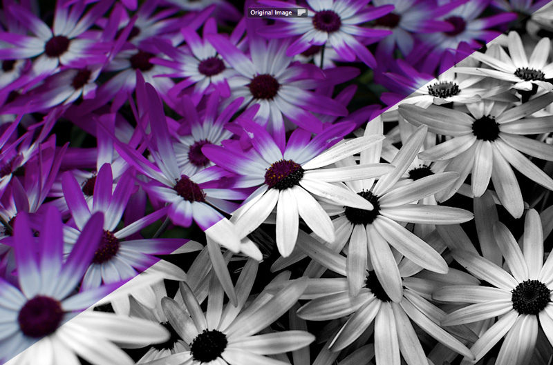

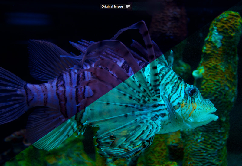

bringing this post back a bit from some time but have a few more shots to post.
These were all edited in Aperture based on a RAW file.
Some are more artsy than simply corrected/edited as I switched some to B&W and perhaps some of this could have been done to a JPG photo.
Here's the top link:
https://flic.kr/s/aHsjVFcneX
fixing a color cast in an aquarium shot:
taking an OK shot and running it with B&W process:
I've split the photos to see how they compare.
