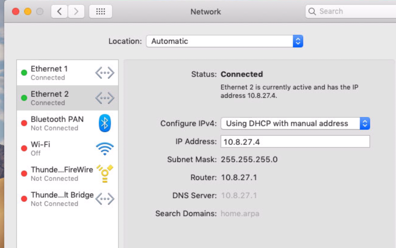

No...not in my network...I, as the network administrator, tell MacOS what, which DNS to use ON THIS network and go as far as ensuring that firewall rules are in place so the MacOS has no choice. You can see that in post #14 in the second pic, DNS 10.8.27.1
YES, that's my case...as I had stated before that here, we are speaking of two separate networks 10.0.8.0/24 and 10.8.27.0/24 each with their own single DNS server...with caching.
I'm still struggling. Maybe you're saying that the Mikrotik DNS server on Ethernet 1's network forwards to 10.8.27.1 for certain zones? That's unrelated to specifying 10.8.27.1 as the DNS server on the interface. From my testing, I've confirmed that specifying a DNS server on other than the first interface has no effect. And your doing that is the only thing that's ever confused me in this thread.
