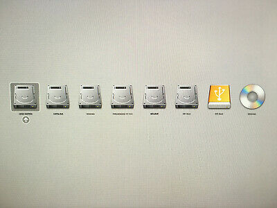

Don't bother with a flashed card, Flashed cards are a thing of the past,
just install OpenCore, read this Thread.
https://forums.macrumors.com/threads/opencore-on-the-mac-pro.2207814/
open core supports a boot screen Even for UEFI cards.

Since flashed cards are on their way out now due OpenCore coming into being,
it makes sense to just go with a PC UEFI card, and use OpenCore as your OS boot loader,
since it supports UEFI Bios cards,
Save yourself $80.00 to $150.00 by just spending 10 minutes installing OpenCore,
and never have to chase around for flashed cards, or flashing services ever again.
Seriously it only took me 10 minutes to install the config i used,
and that included reading the instructions on how to install OpenCore.
Also OpenCore has NVRam protection for people like my self who have a UEFI Windows 10 installation,
so the Windows boot.efi can't brick your logic boards NVRam.

I don't know if you have read up on OpenCore, its like ReFind, it sits in the EFI partition,
No OS changes at all.
