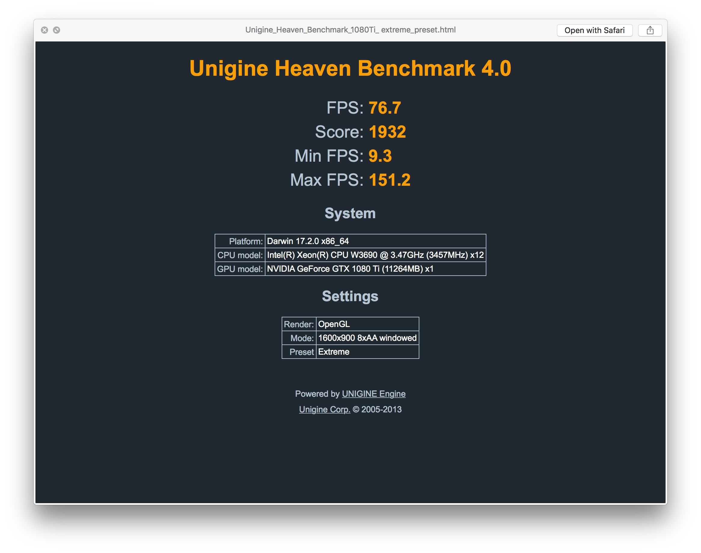

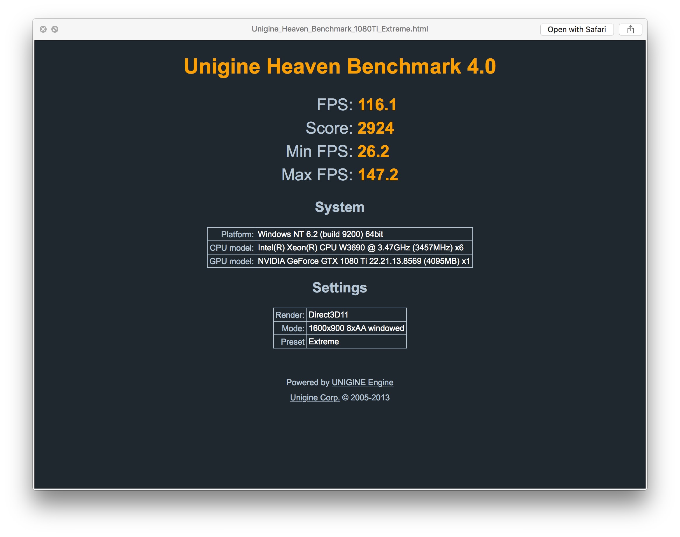

Most likely just poor driver performance in macOS, it's been like that for many years. For just 60FPS, PCIe 1.0 x16 should be more than enough. My 1080Ti also running at PCIe 1.0 x16 in Windows, and it can achieve way more than 60FPS average.
The same card in the same computer in macOS which can utilise PCIe 2.0 x16 can only achieve 76FPS.
Therefore, it's the API or driver performance issue, not bandwidth issue.

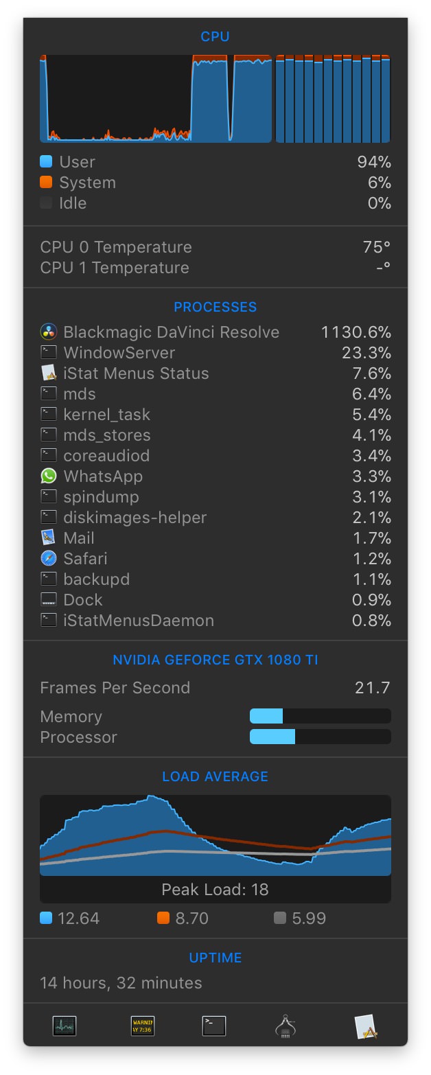

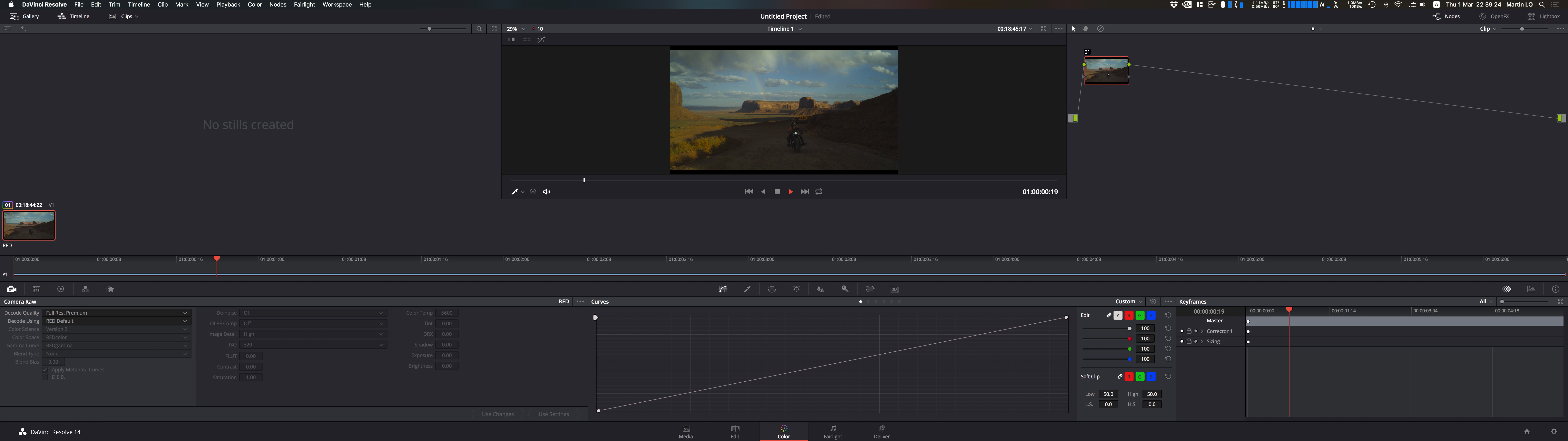

Interesting, I tested it on my 5,1. It seems the test is very CPU limiting.
I follow the steps above, and achieve about 10FPS with my 1080Ti.
However, that already used up my whole CPU
I am with the latest 10.13.3 (17D102), and web driver 387.10.10.10.25.158.
Reactions: itdk92
