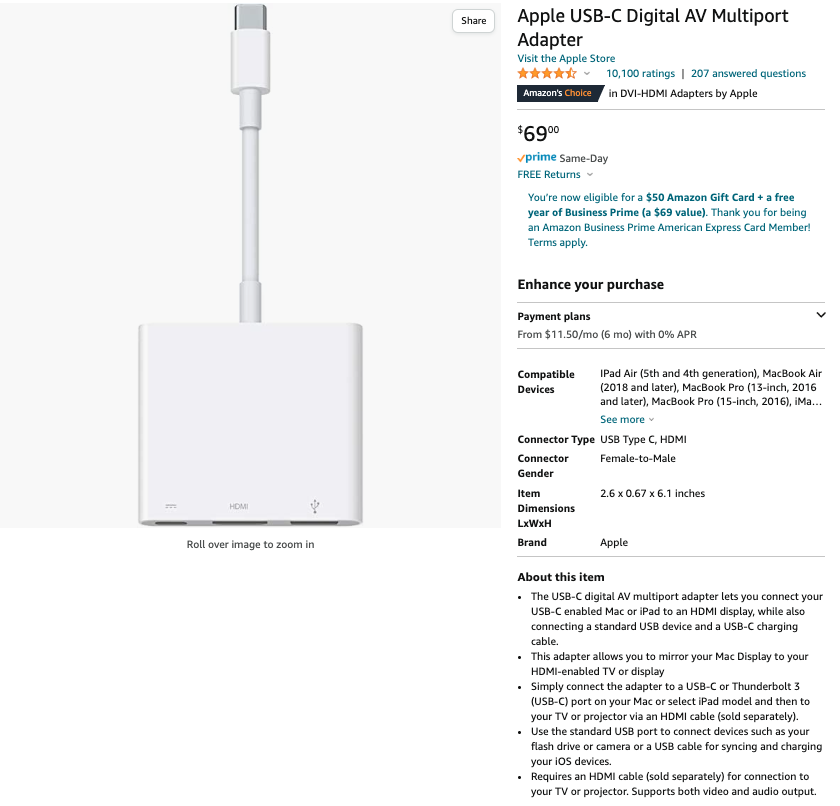

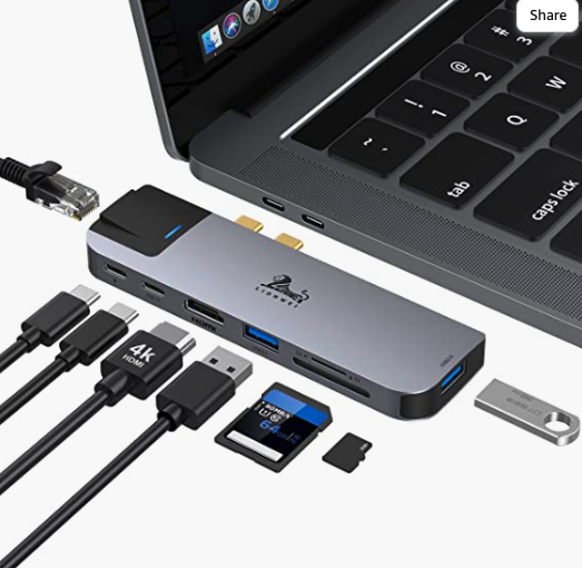

I have been using the above device without issues prior to macOS Ventura. After I upgraded, nothing can be displayed anymore on my external display via HDMI. I tried plug/unplug and whatever stuff I can disable on the config following instructions I read online and not a single solution worked.
I then tried to use the oldie Multiport Adapter built by apple of course and my External Display now worked.
Looks like apple just want us to use only apple products. I hope this will also work for others who are suffering the same predicament without switching back to Monterey.
