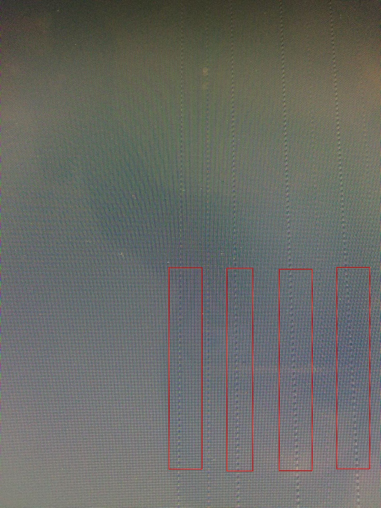

I read throughout the thread and it seems that vertical lines could be a graphic card, lcd panel, vertical sync cable or heating problem. But I need to confirm with someone that have the exact same lines pattern as my screen (see attached picture) to narrow it down a bit more. What I know about the iMac is that the previous owner replaced the Optical Drive with an SSD Disk and to avoid using the Optical Drive by mistake he sealed the opening with tapes. I mention the tape here because when I remove it, I can feel the hot air coming out of the opening so I guess it is also used as heating exhaust.
So anyone with the exact same line pattern, please let me know.
thanks
Sounds to me like a cable issue. I had a monitor that would exhibit the same issues if the cable was wiggled.

I have exactly the same lines on two Imacs i currently have. (2009 and 2010)
First of all this lines are not gpu related. I had a chance to swap everything from a working machine (no lines at all) and came down to a conclusion that this is only lcd issue.(also because ppl with cinema displays have the same issue it kind of narrows it down to lcd ?)
Also this issue shows up only on older imacs (2006-2010)
2011 models do not have this issue.
At first i thought it has something to do with vsync cable. but i did experiment with it on a machine without this issue and it has nothing to do with vsync cable. YOu can unplug it at all on a working machine and it will not develop this lines
Iim still working on explaining why in the hell the lcd fails on us this way....
