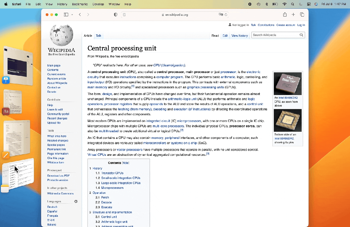

You can in fact do this with Stage Manager, you just need to make sure all of the apps you want to position are on the same stage. Have one app out front, then move your mouse to the left of the screen to show the other apps, and drag the one you want out. Then they will both display at once and you can arrange them as you please.Stage manager was the problem! Thank you all again for the help on this!! Kind of lame stage manager causes you not to be able to do this. I like stage manager a lot but will not be turning it back on bc of this
I tried that but if I select an app that isn’t the same as the one out it just replaces it. Makes no sense to meYou can in fact do this with Stage Manager, you just need to make sure all of the apps you want to position are on the same stage. Have one app out front, then move your mouse to the left of the screen to show the other apps, and drag the one you want out. Then they will both display at once and you can arrange them as you please.
Did you make sure to click and drag the app window out instead of just clicking it?I tried that but if I select an app that isn’t the same as the one out it just replaces it. Makes no sense to me
No I did not. You can resize and put it wherever you want if you drag it?Did you make sure to click and drag the app window out instead of just clicking it?
Yes. If you drag the window out from the shelf along the side of the screen and drop it in the middle, then it joins whatever windows are already out. See below:No I did not. You can resize and put it wherever you want if you drag it?
Awesome didn’t know that!!! Thank you!Yes. If you drag the window out from the shelf along the side of the screen and drop it in the middle, then it joins whatever windows are already out. See below:
