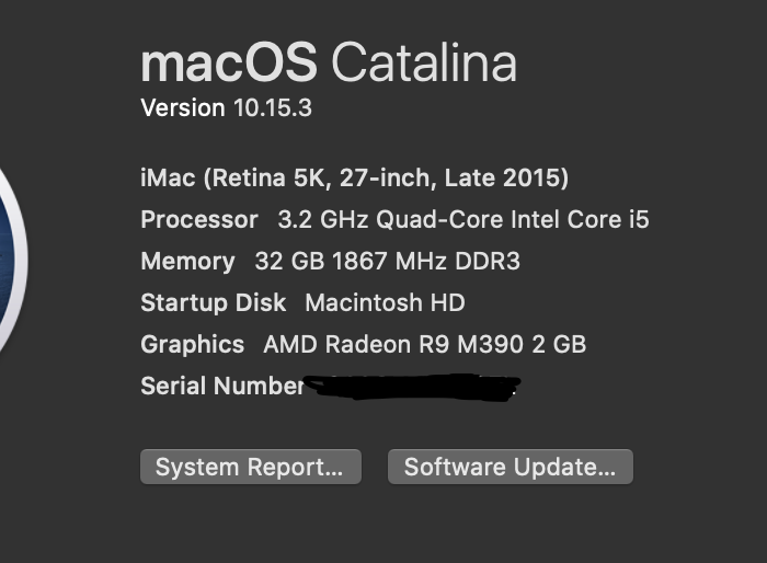

I've got a mid 2015 27' and have upgraded memory to 32GB and replaced the HDD with a 2TB SSD. The SSD perked up the system. My video card is a 290.
I have an eGPU on order - PowerColor Red Devil 5700XT; it's a beast. I'm hoping to keep the old system going for as long as possible. I got the 5700XT because it should also be useful in the future on another machine (laptop purchase sometime this year). If it was only for my mac, I'm not entirely sure I would have bought it. There are driver issues with this card but I'm counting on Apple updating drivers to fully utilize it. Frankly I don't want to shell out more $ Apple for a new mac. And (only ½ joking), I could always dump Apple and put the card in a Ryzen computer.
For the price of an enclosure and card, you're a good chunk of way to a new computer. So it's tough call.
Because our systems are thunderbolt 2 we can't take full advantage of the eGPU but I'm thinking (hoping) there will be a noticeable improvement. My internet "research" indicates that others have gotten +ve results. I don't know about games, I use FCPX and Davinci Resolve for editing and rendering is slow.
Once it arrives and I've set it up, I'll post on it.

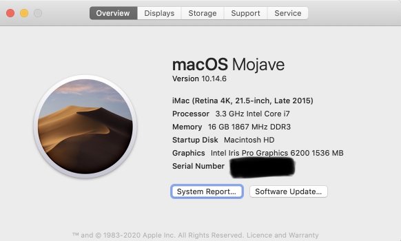

Sounds lke youve had some decent success with this - i'd like to do something similar to my 2015
Looks like a couple people have (almost) similar specs to my iMac but have managed to squeeze a bit more out with an eGPU. ive attached my specs as im pretty rubbish at this stuff - does anyone have any advice as to whether i could improve my machines performance (for video editing) without buying a new one?
RAM is possible bottleneck.
Don't know if your startup disk is HDD/SSD or Fusion.
Would look at those two first.
Believe this is TB2 ports only? If so, not really worth looking into NVMe as external boot drive.
RAM is likely soldered and cannot be upgraded further.
Personal opinion - if you want to or are even willing to crack this thing open, look into SSD upgrades. If you do not, deal with the "numbers" you're getting now. Your money would be better invested in a machine with TB3.
