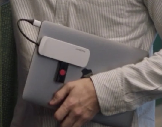

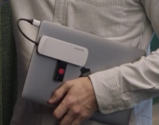

It's kind of hideous and seriously expensive. I'd rather have a GaN Power adapter and one of those 30$ docks that's super slip and sticky-taped to the back of the MacBook screen at all times.
