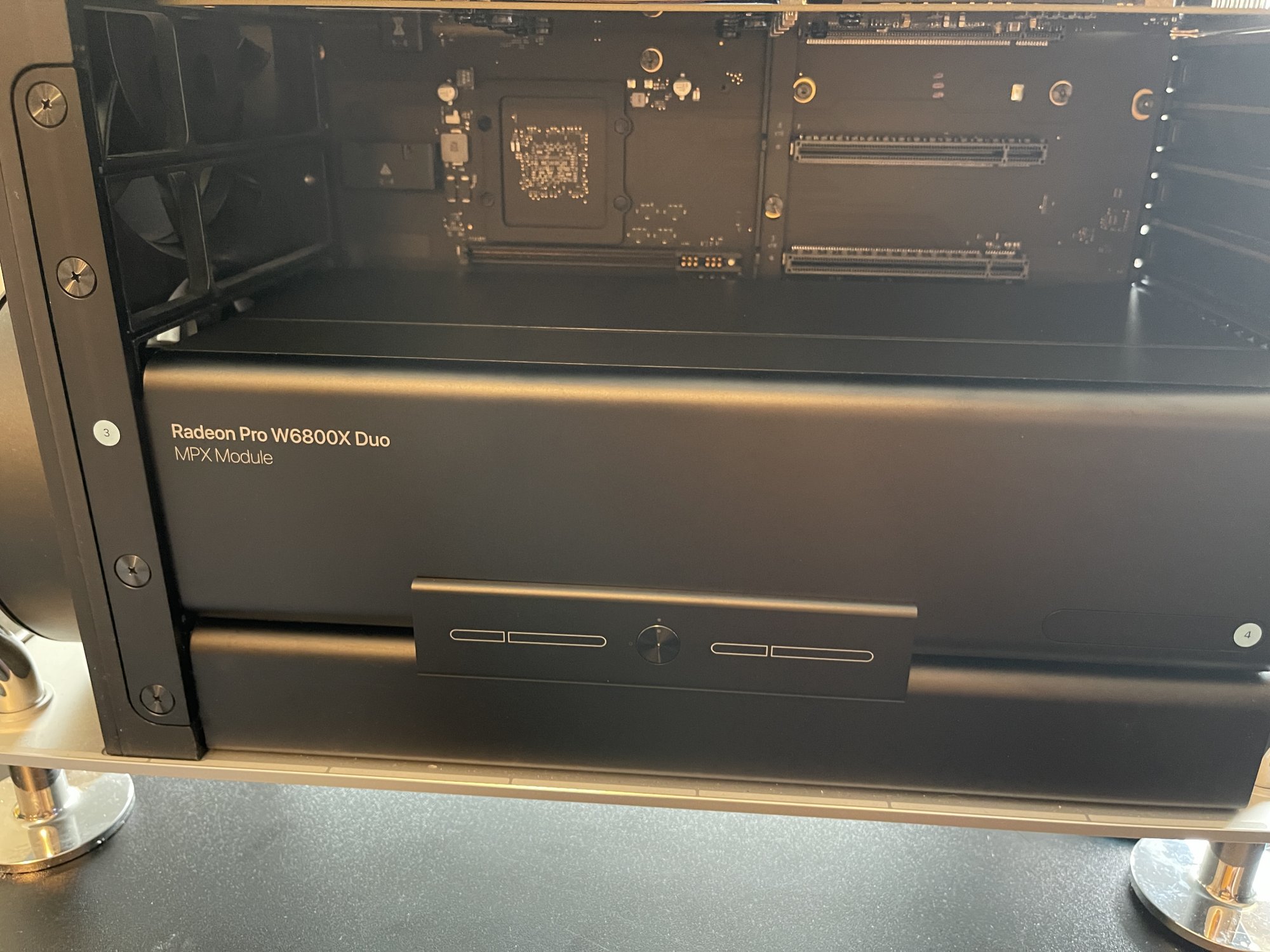

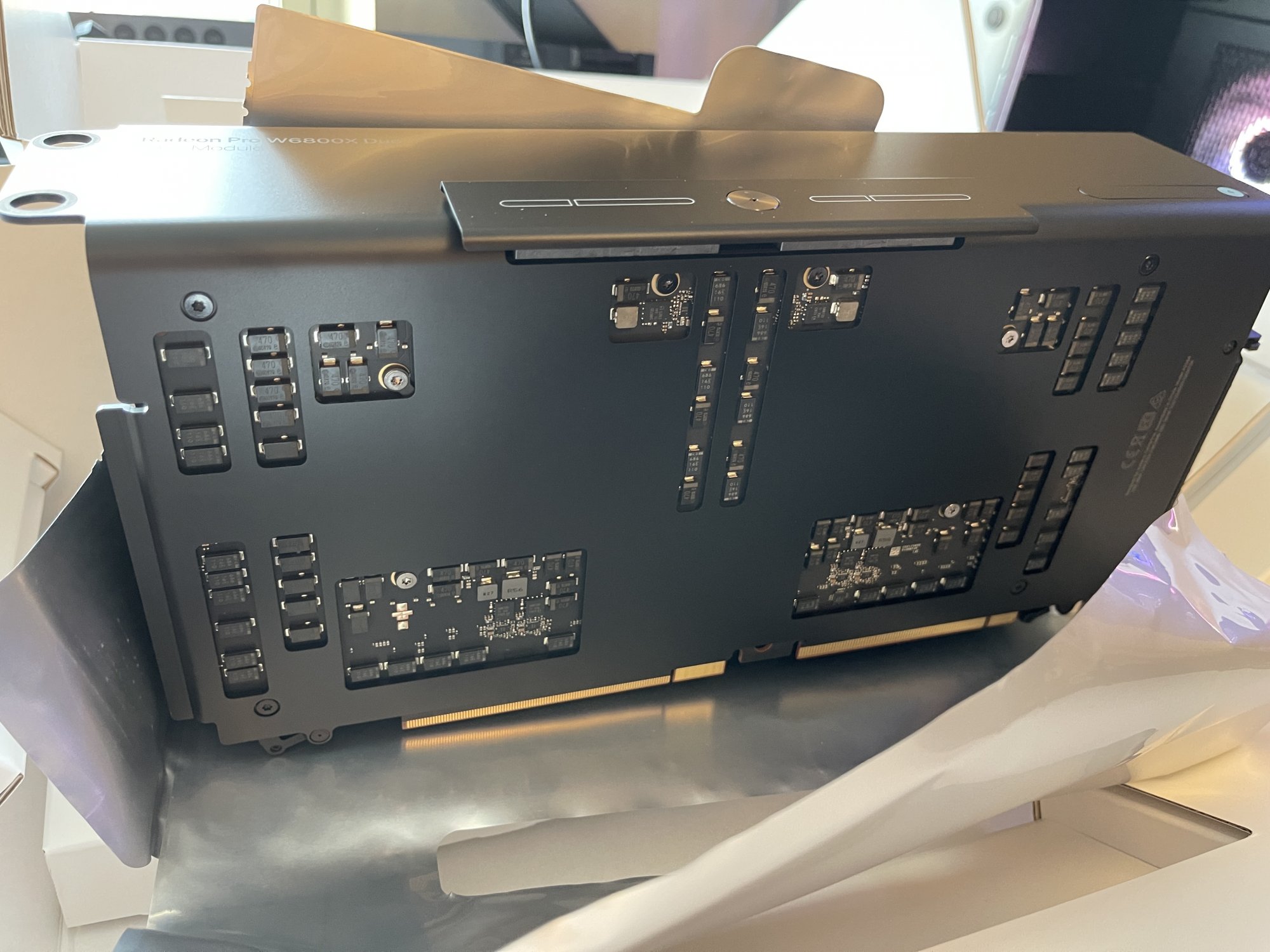

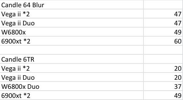

Received the w6800x Duo today, ran some tests vs other gpus I had benchmarked. 28 core Mac Pro, 96gb ram
geekbench 5 metal: 144,910
hash rate for those interested: 58 mh/s each, around 600 watt total system draw, 175w-200w each gpu
Will benchmark more as well, if anyone has a specific request let me know

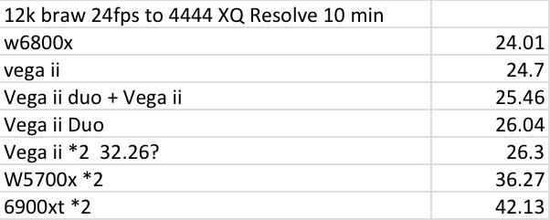

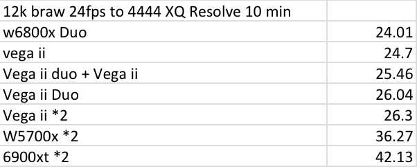

vram limitation explains the 6900 xt and w5700x in 12k most likely

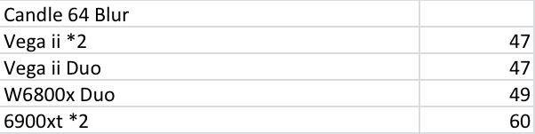

candle FPS benchmark in a resolve :

I am curious too - I do have a 6900 XT, so far the W6800x Duo is faster than a single 6900xt where multi gpu Is used such as Resolve or FCP. By a fairly big margin too - the single W6800x is already not a massive gap from the W6900x, So a Duo is certainly faster as 2 vs 1.
I am assuming also the w6900x will be faster than a 6900 XT in some tasks due to more Vram, but it may also be slightly slower in others due to the decreased clock speed
Rocket benchmark test, similar to the candle test:
Middle Test, UHD Pro res
W6800x Duo
09 Blur: 59 fps
18 Blur: 51 fps
30 Blur: 31 fps
66 Blur: 15 fps
1 TNR: 59 fps
2 TNR: 39 fps
4 TNR: 20 fps
6 TNR: 14 fps
To compare to the dual W5700x:
2x W5700X
09 Blur: 59 fps
18 Blur: 30 fps
30 Blur: 19 fps
66 Blur: 9 fps
1 TNR: 51 fps
2 TNR: 26 fps
4 TNR: 14 fps
6 TNR: 10 fps
Reactions: kwansheungchi

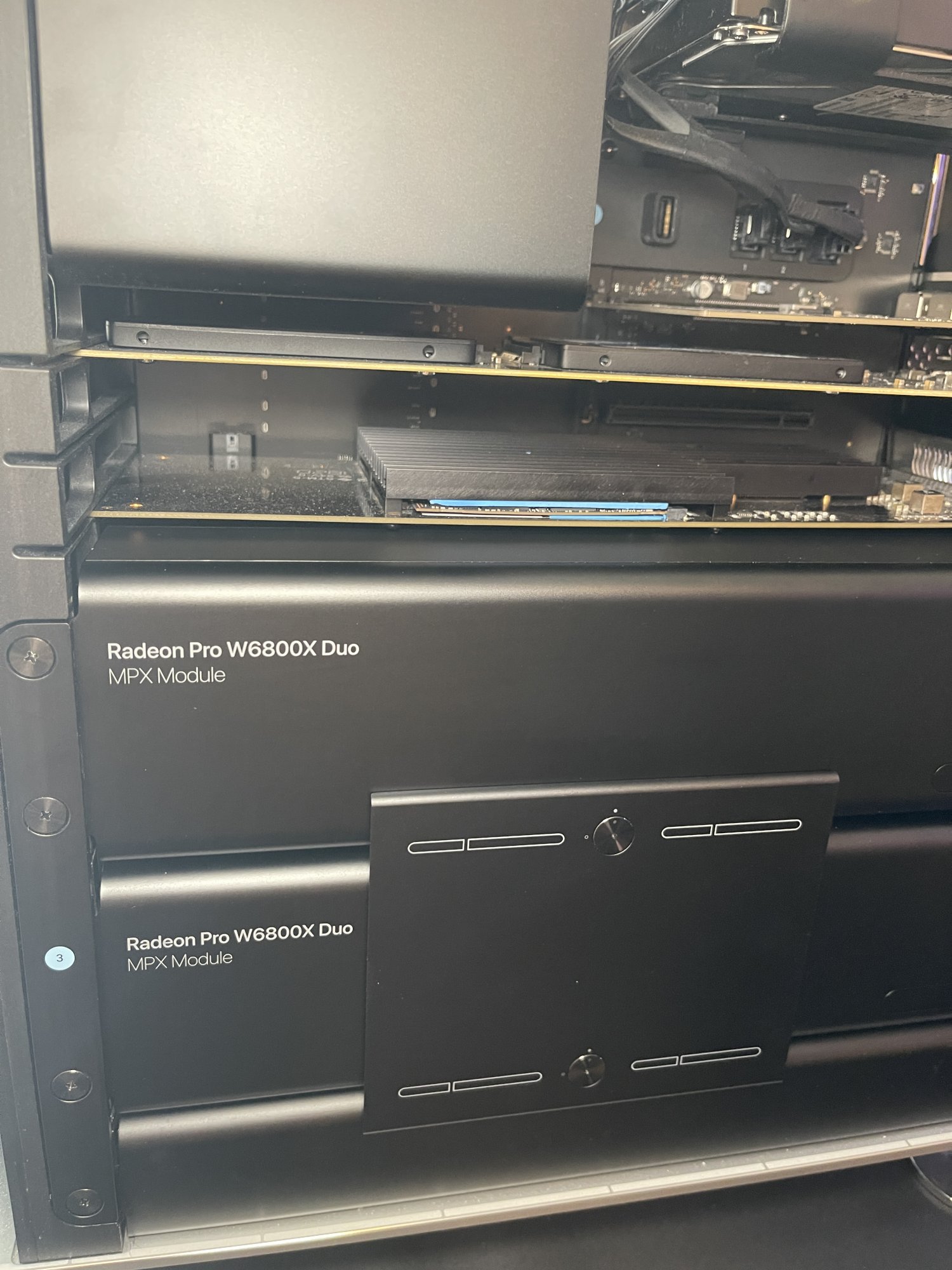

If you guys have any other test ideas let me know - I am also getting a 2nd duo, so I will test 4 GPUs as well.
If you're so inclined:
I'd love to see how many hardware h.264 encoders your system reports with that Duo in. I'm assuming it's three.
Wonder if there is enough power (and room) to install a 5th Retail W6800 above the 2 MPX modules....lol.
