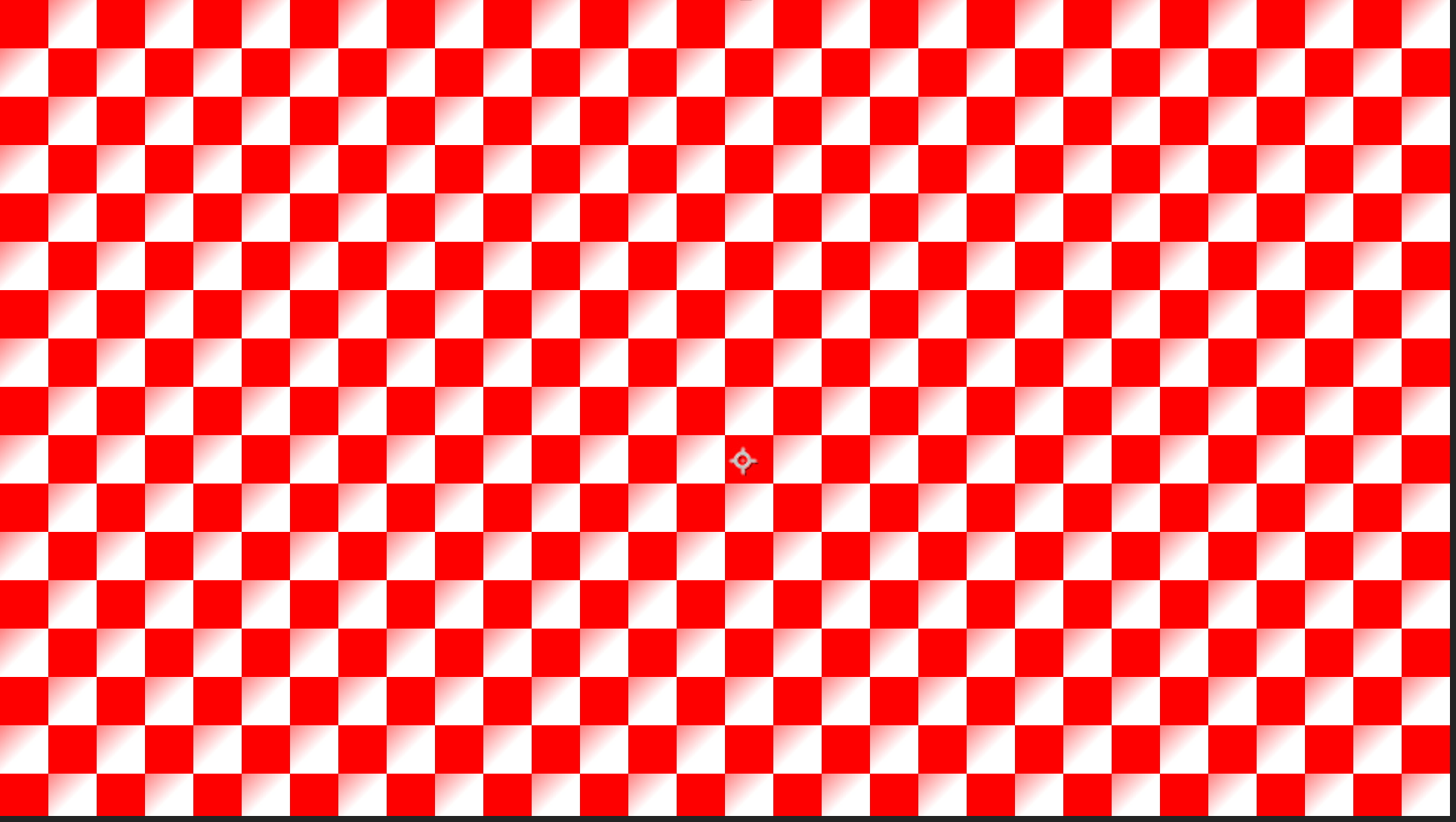

I'm in the waiting line with Adobe Support...
After effects stopped displaying anything again and Premiere won't launch with this video driver issue.
I restarted, now it's displaying stuff again, but in my comp, the video footage is displayed like this:

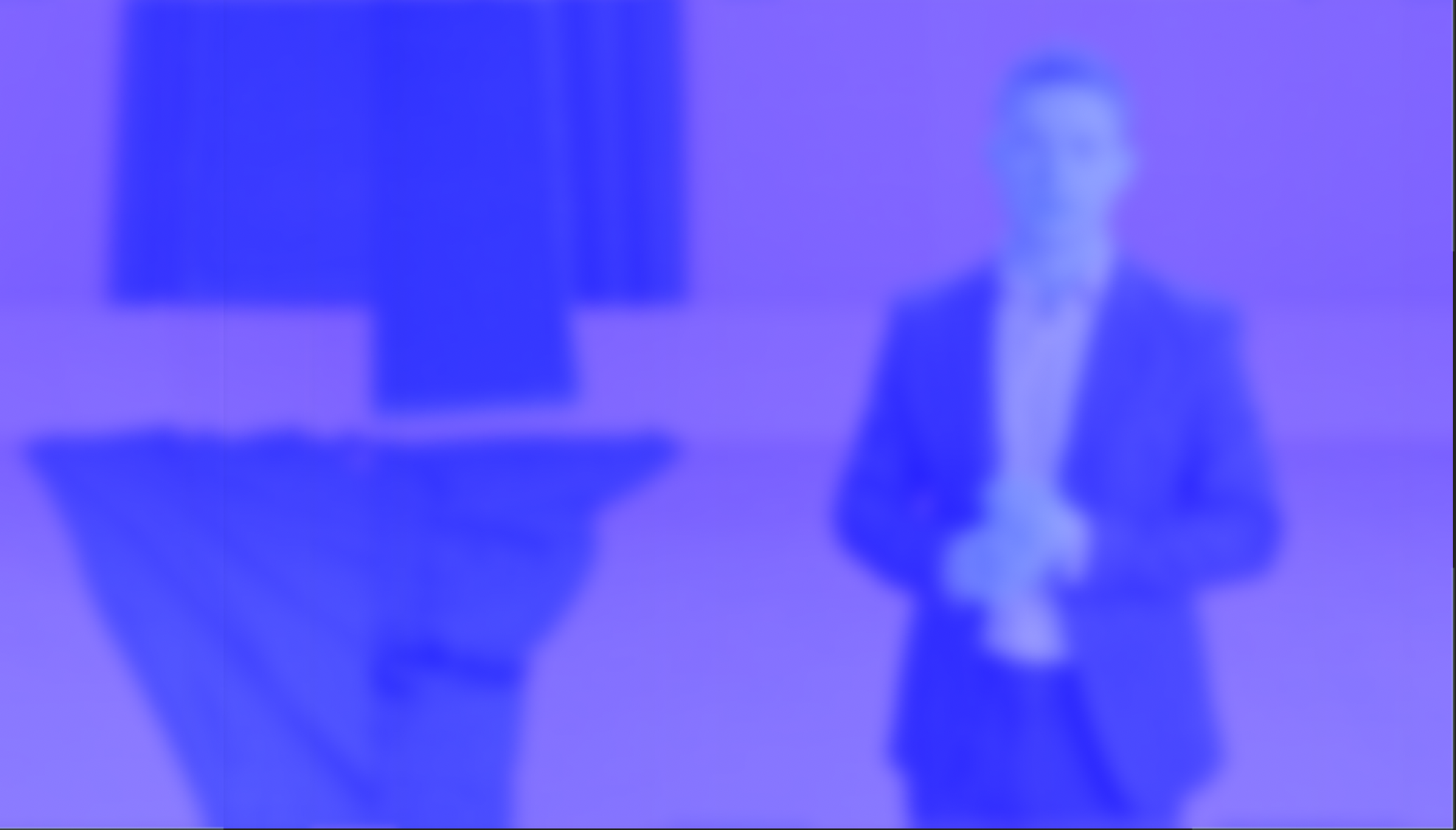

If I double click on the source video I can see something but it looks like this:
This is supposed to be a guy in front of a greenscreen, and now, it was not shot like this ;) It looked normal this morning.
Can this really be a corrupted file system? This footage resides on an external drive. I purged all caches a thousand times already.
Maybe my Vega II is broken?

First of all I spoke with my man from Apple business and he suspected it might have something to do with the T2 chip, but wouldnt want to go into any details until he could speak with his colleague tomorrow morning.
In the meantime I'm on to another lead:
In the email from Adobe, the lady asked if I was using any Promise Pegasus Raid and had recently installed drivers from them. She said there are some known compatibility issues and I should downgrade those drivers/their utility.
IN FACT I have installed a new version of the Promise utility two days ago and had forgotten about it as it seemed so unrelated. Actually the promise support made me install this tool while we were trying to detect why one of my raids was kinda slow writing and the old tool couldnt generate a log file.
I have now deleted this tool and for now actually for the first time since yesterday could complete a full render.
That's so bizarre, if really this driver caused all this. I don't understand how it could have an influence on the graphics drivers, but well, here we are. It's too early to call this a solution yet, need to observe it for the next hours, but at least it's a trail.

In a situation like this - systemic failure - it's always best to go into a minimal configuration mode ( remove all components except for the ones necessary to get the system basically running ) and then add components one at a time and observe when the instability returns . With earlier Mac models , Apple would have guidance on rebuilding a Mac one component at a time even if the Mac was not really usable in any particular configuration . The goal was to find the culprit systematically . But we don't have those service sources yet for the MP7,1 .
Do you have any explanation on how this promise utility couldve caused all this havoc?

Reports of Promise RAID Utility issues in Mojave:
And seems to have lingered into Catalina if the end of this thread is accurate:
So far nothing you're mentioning has documented even an attempt at a near barebones setup to test/troubleshoot. You still have not reported answers to any of this:
JUST your video output window (not the entire screen) that shows issues?
Have you turned Mercury Transmit off everywhere?
What exact version of macOS Catalina is installed?
What were the results of the Apple Diagnostic test?
What does your RAM report as in about this mac?
Have you tried only ONE MONITOR connected directly the GPU without TB adapter/converter involved?
Have you contacted Promise?
If you did a full clean install of Catalina, why did the issues linger through that clean install?
Was the Promise utility installed as part of what you considered a clean install?
Did you fully erase your hard drive before clean install of Catalina or as part of that clean install?
AFAIK, no special drivers/utility are part of the standard Catalina installer so they should not be present unless you actively took steps to instal them.

No those drivers are not part of the installation, I just reinstalled them because I always had them and never did they cause any trouble. I didn’t assume that this could be the cause of all of this...
-like where? In afx it was never on, in Premiere it was on but premiere wouldn’t launch an
10.
- ADP000 - no issues found.
- nothing unusual, my Mac contains 6x32gb 2933mhz dimms
I tried one monitor, but not without the adapter, don’t know how u could do that. They only have DisplayPort or Mini DisplayPort and neither attaches to the new Mac Pro.
Promise is looking into the issue, of course I have contacted them.
