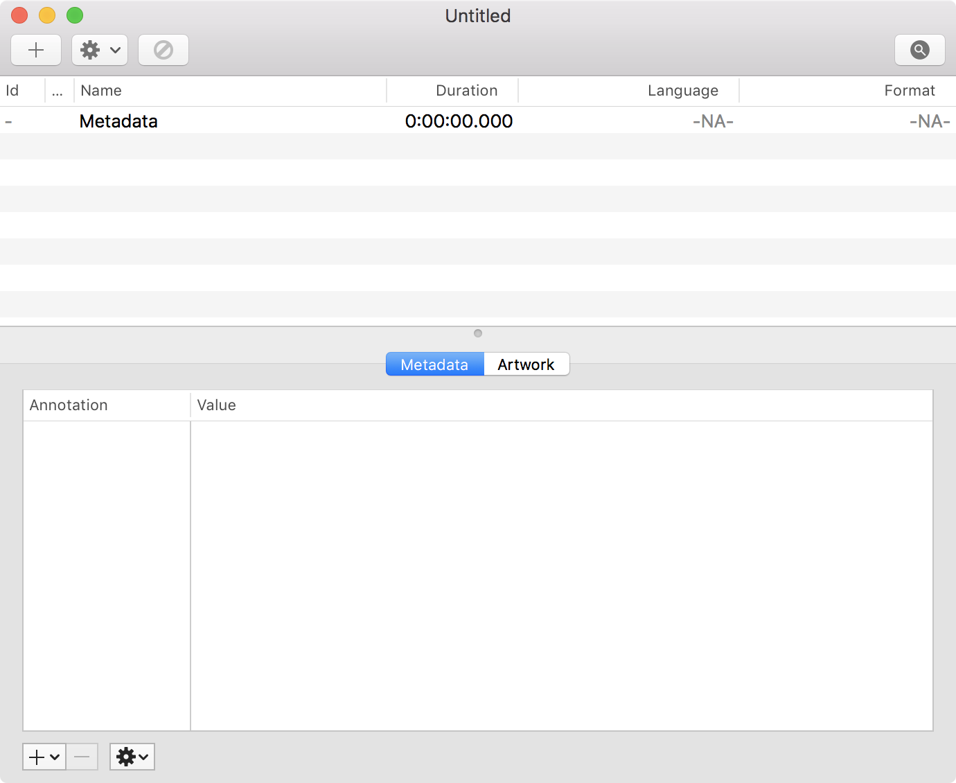

I tried FFMpeg and Subler. Im not very savvy yet and I can't figure out how to use either of them. (laugh if you must, its just where Im at)
1) Download Subler and run it. No window will open automatically. That's normal
2) Go to the upper left corner. Select File -> New

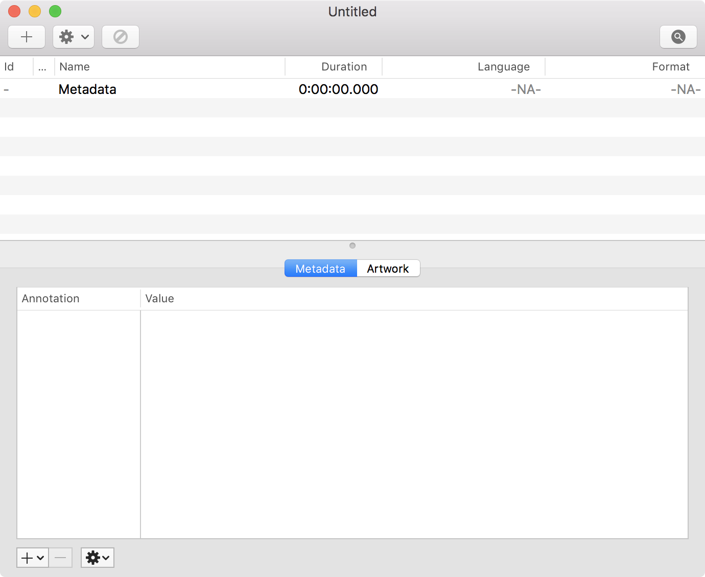

3) Now, you will have a GUI to work with

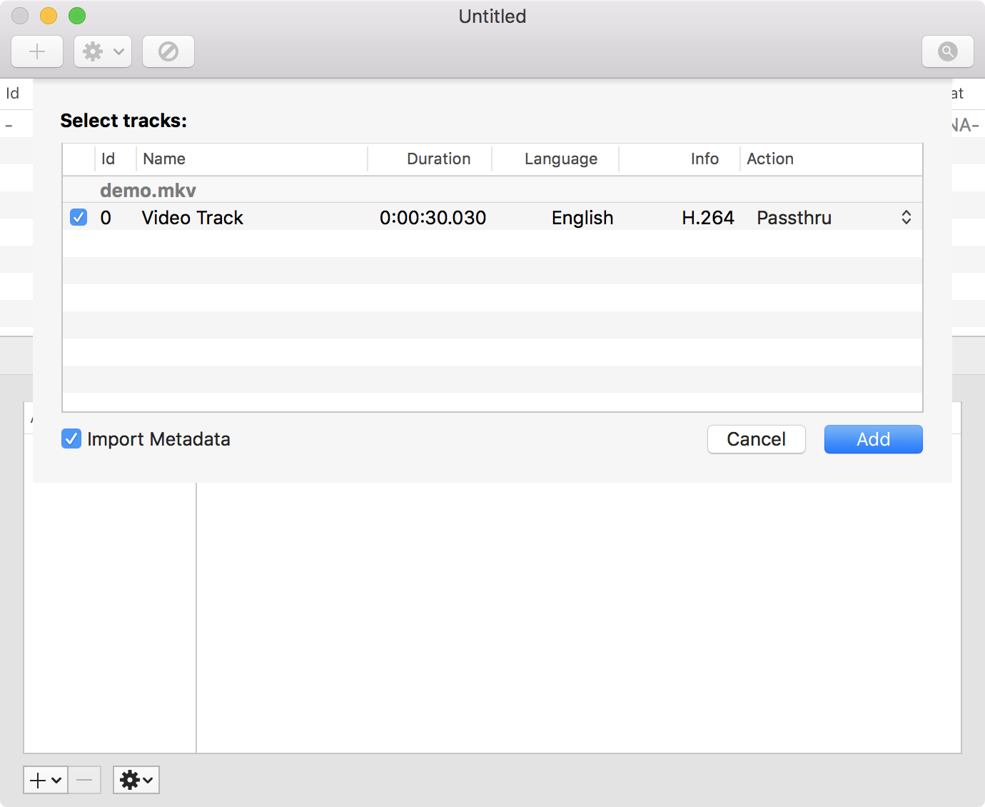

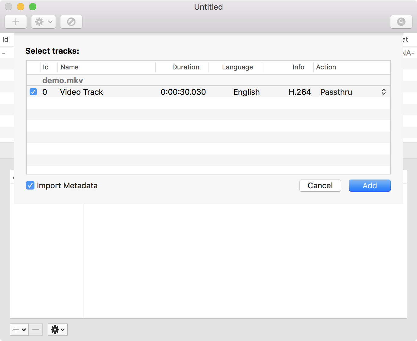

5) Select which track you want, and make sure the action is "Passthru" if you only want remux that into MP4. Then click Add.

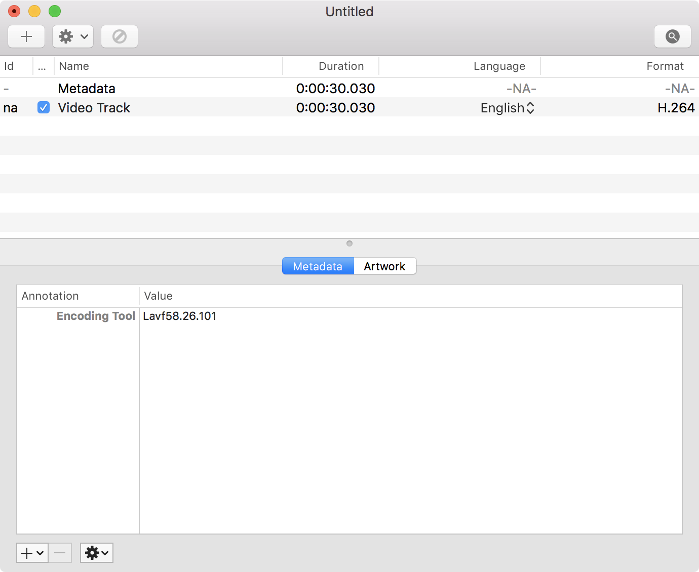

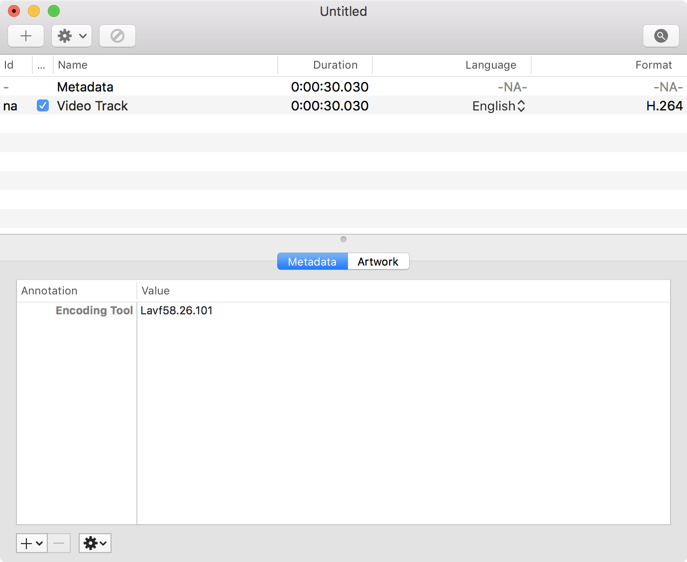

6) Now, you should see something like this

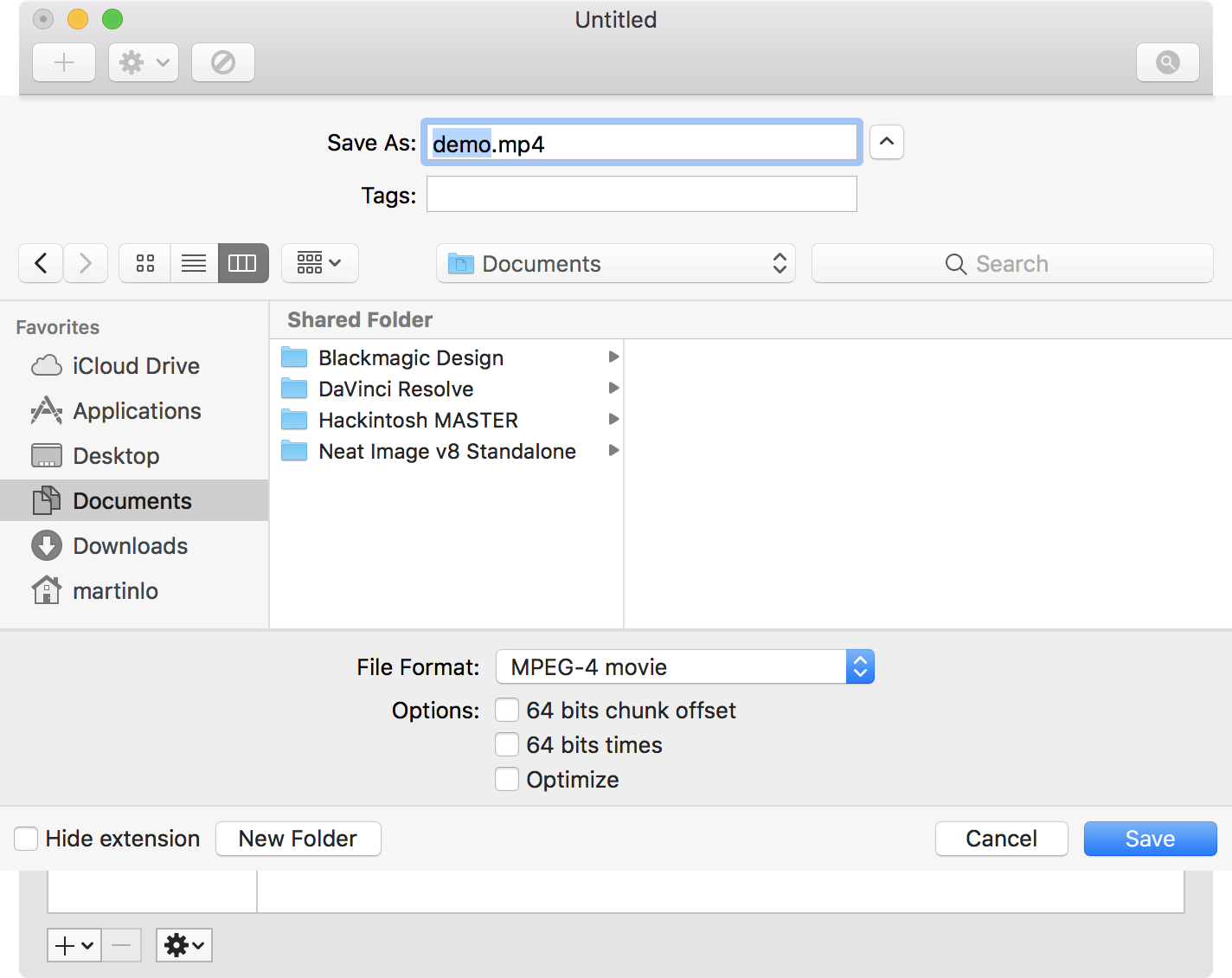

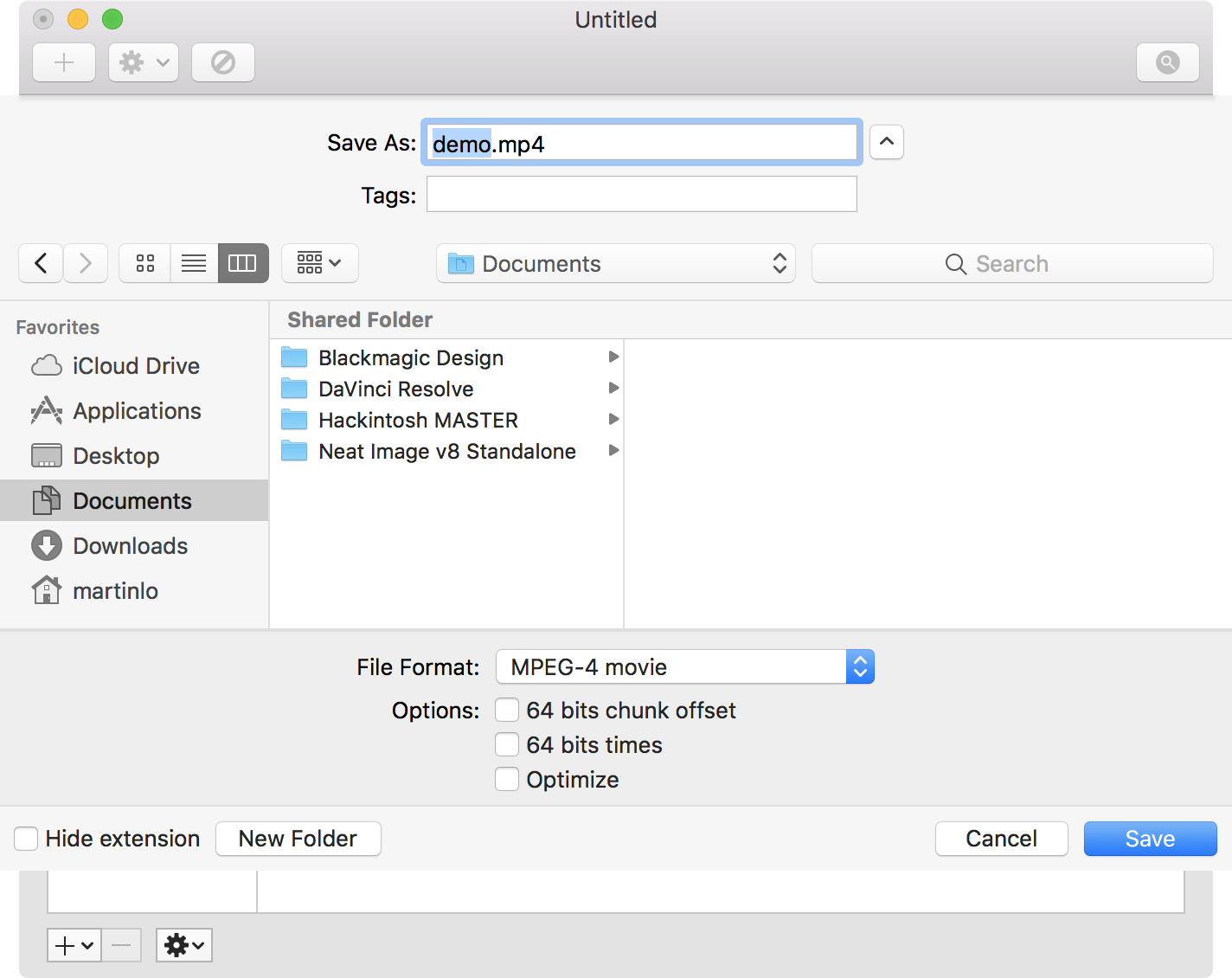

7) Now, go to upper left corner again. Select File -> Save As. Pick a destination, set file format to MPEG-4 Movie, make sure the file name end with mp4. Then click Save.
Then you will have the MP4 files in minutes (if that's a huge file). Otherwise, the remux will finish in seconds (assume your storage speed is not super slow). Since this operation can easily be storage speed limiting. Avoid read / write to the same drive may also help to speed up the process.
e.g. original MKV in SSD 1. Destination MP4 to SSD 2.
Of course, if you have to copy the MP4 back to SSD 1 to work with, then no point to save that on another hard drive. It all depends on your actual workflow.

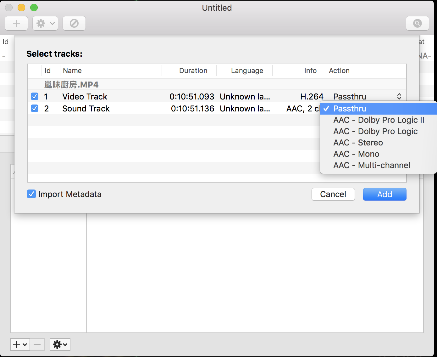

Well it was really fast and perfect quality. But no matter what audio tracks I use or dont use, the audio, when imported to imovie, is wacky. Its reverby and echoey. Cant seem to fix it. Doesnt happen after conversion with any other tool. Any idea what that is?
I bet your conversion tool re-encode the audio part. You can try only re-encode the audio part. e.g. AAC - Stereo.
