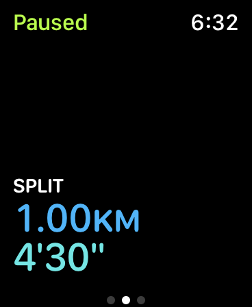

Same here. During the 1 mile split announcement the average pace announcement and the screen that displays the metrics are incorrect. Announcing and showing the same pace as the split pace.
But on the actual workout app after the announcement the correct average pace is displayed.

I’ve recalibrated, unpaired and re-paired my watch, restarted both my watch and phone and the average miles are still not being announced correctly. I also noticed that in the Fitness app on the iPhone that it is showing incorrect average miles when viewing the splits.

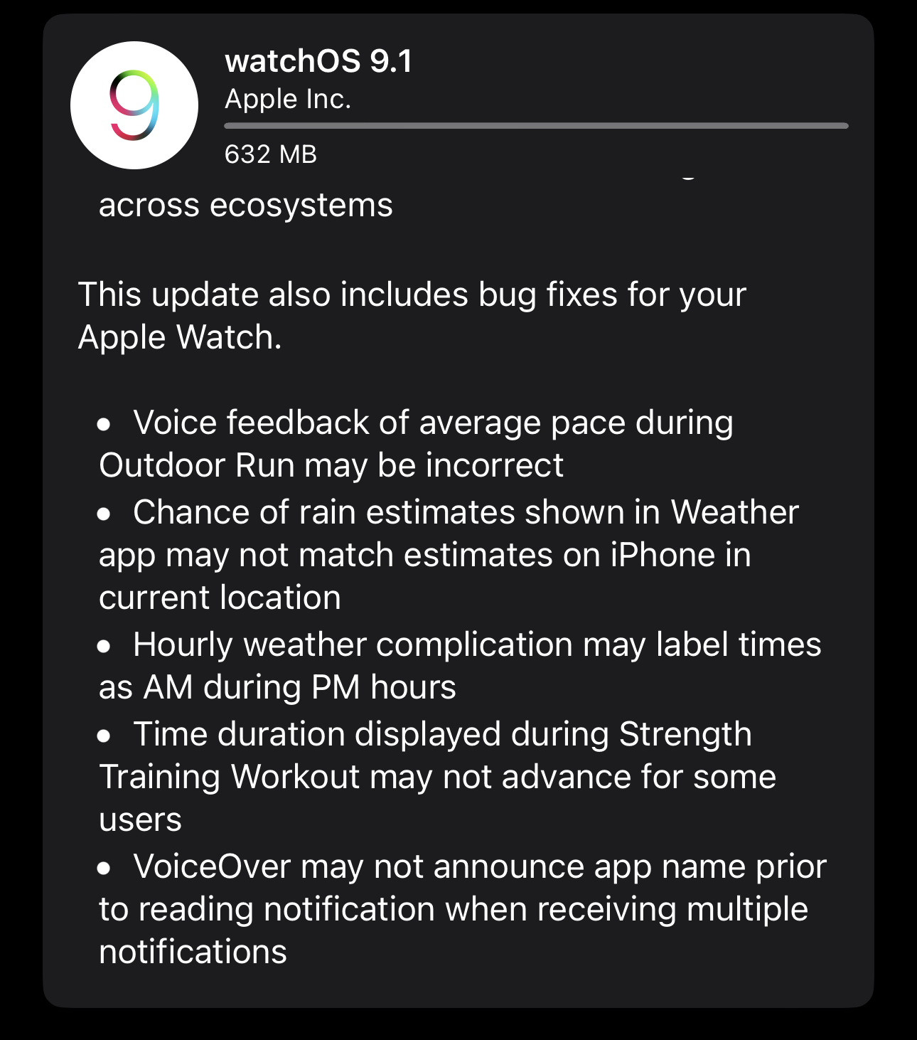

I just installed watchOS 9.1 and I can confirm that you now get voice notification for each split only. No voice alert for overall average pace 🙁 that’s a bummer for me
Yeah, it's not not incorrect anymore because it doesn't even try to calculate the average now 🙁

I submitted a bug report using this form “https://www.apple.com/feedback/watch/“ and wrote that the overall average pace voice notification is gone. I consider this as a bug because overall average is one of the most important metrics for me as a runner. I really hope they fix it
