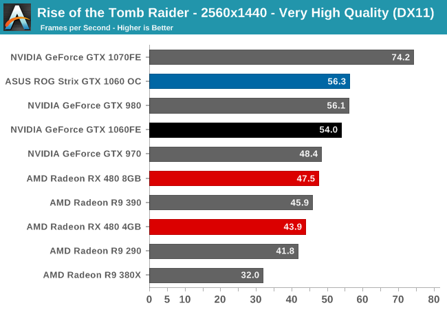

Again, my fundamental point relates to the comparison between the 1060 and the RX 480. On paper, the RX 480 should destroy the 1060, but in nearly all game benchmarks the 1060 wins (and often wins by a significant margin). How do you explain this?
Delta Memory compression can help, in Memory constrained environment. But GTX 980 Ti has the same amount of it as GTX 1060 and has much higher memory bandwidth. So it will not help here.
Asynchronous Compute would help. But what we have seen to this day is that GTX 1060 is loosing performance with Asynchronous Compute turned on in games using DX12. Secondly, for Pascal GPUs the difference is within 1-2% of performance when this setting is on.
And again. The difference in performance of both GPUs is 4.4 vs 5.9 TFLOps.

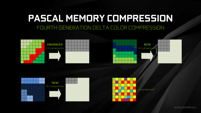

That's not how NVIDIA's memory compression stuff works. If you're rendering to a 4K surface, Pascal can do 4:1 and 8:1 compression (i.e. reducing bandwidth by a factor of 8x). Maxwell is limited to 2:1, so Pascal can get 4x better throughput in ideal cases. It doesn't magically make your 4GB texture take up less space in video memory, it's just that the contents may be stored in a compressed format that requires significantly less memory bandwidth to read and write.
So, in the case in the bottom right, the GPU only has to read 8 pixels in order to get the full 8x8 pixel grid's worth of data. This can obviously (or maybe it's not so obvious?) have a massive impact in real-world performance in games like Gears of War.

Okay, two points:
- Raw TFLOPs will not help you when you are not constrained by shader horsepower. Thus, just because GPU A has more TFLOPs than GPU B doesn't mean it will run any faster for certain applications. Right?
- Again, this has nothing to do with memory footprint, though that can be an issue. If the working set of a game does not fit in video memory, then as you point out, the game will run very poorly. Pascal's memory compression has nothing to do with the overall working set size. It has everything to do with the GPU reading from and writing to resources in that working set, which is generally a very important aspect of a modern game engine.
Let's take a concrete example. Let's say you have a post-processing pass in your game engine that is ROP limited. Maxwell has 2:1 memory compression, and so for a given 8x8 or 64-pixel tile, it can write out only 32 pixels (e.g. 128 bytes for RGBA8). Pascal can get up to 8:1 memory compression, which means for a given 8x8 or 64-pixel tile, it can write out only 8 pixels (e.g. 32 bytes for RGBA8). So, Pascal is capable of writing out 4 times less data for the same shader pass, which might translate into an overall 4x speedup for the given shader execution. If you apply this kind of speedup to a bunch of different ROP-limited shaders, you might see a 10, 20, or even 30% gain across the whole frame.
Oh hey, this kind of lines up with the real-world benchmark data that you were posting, where Pascal is performing better than the raw TFLOPs suggests it should. That indicates that the game in question is not simply limited by raw TFLOPS, and many other things (including a reduction in the amount of memory that needs to be read and written via Pascal's 4th generation compression) can improve performance.
