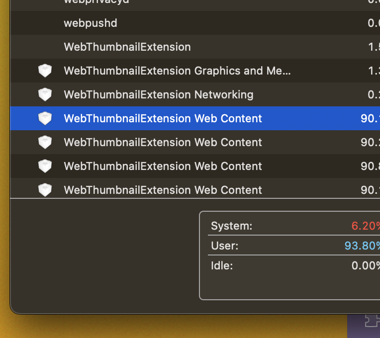

Hello,
After upgrading to macOS Sequoia on MBP 16 inch M2 MAX with 96 GB RAM, occasionally CPU and RAM is eaten by 10 to 20 process named and starting with WebThumbnailExtension waiting is not solving the issue, I need to open activity monitor and force quit. What is the reason behind this?
I have two studio displays attached to MBP in Clamshell mode with Apple Thunderbolt 4 cables.
Regards

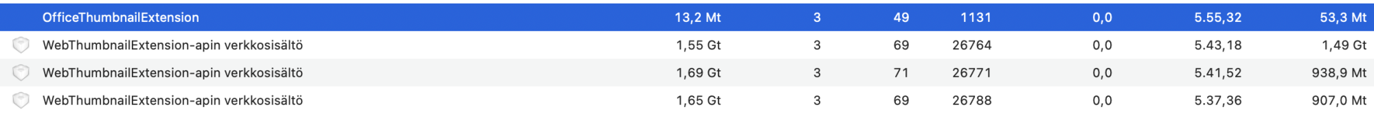

Guilty one is most likely OfficeThumbnailExtension..
(/System/Library/ExtensionKit/Extensions/OfficeThumbnailExtension.appex/Contents/MacOS/OfficeThumbnailExtension)
Open files
