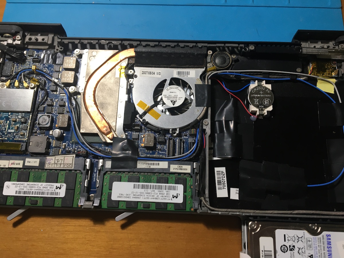

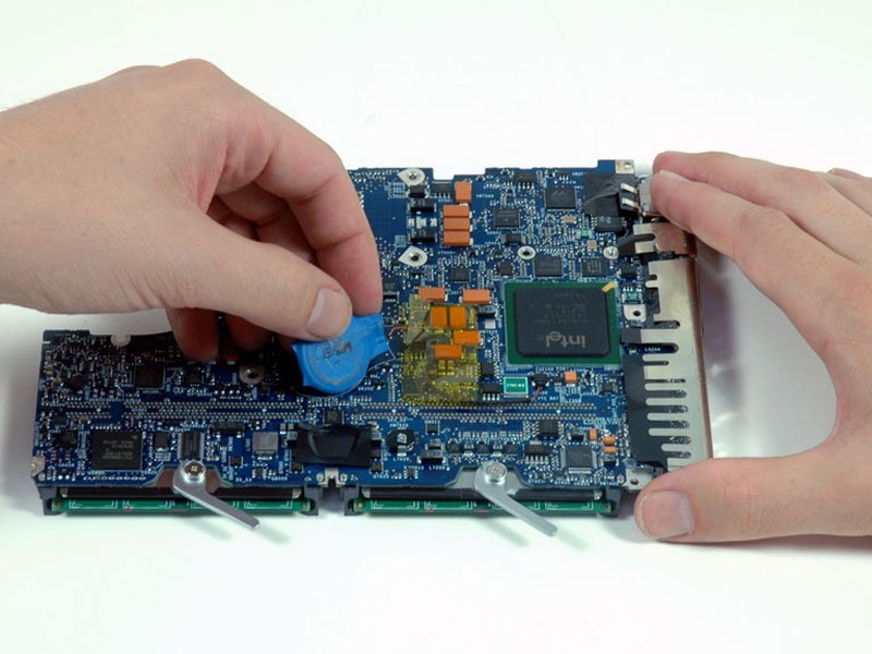

Some A1181 have replaceable PRAM battery, some A1181 do not. Could be PRAM battery. One battery holds charge while the other does not.
The PRAM battery was dead. I had my suspicions and they verified after turned off the WiFi and noticed that the clock was resetting after removing the power.
I didn't have a battery with tabs but I had a lot of space when I removed the damaged optical drive. I also removed the LCD which I don't need (I have an external connected).
I connected extension cables with the old battery connector and used a CR2032 battery holder. I also relocated the WiFi antennas. Of course I cleaned and replaced the thermal paste.
I still had issues with boot. The first time it started fine but then I could hear only the fan spinning at very low speed. I boot into recovery again and cleared the nvram with 'nvram -c'. Now everything is working fine with both HDD (OS X and Mint). I also used the bless command (posted above) to fix the 30" delay in white screen. Hope it will last and the battery was the only problem.
So for anyone interested this MacBook works fine without LCD, optical drive, camera, mic, battery.
