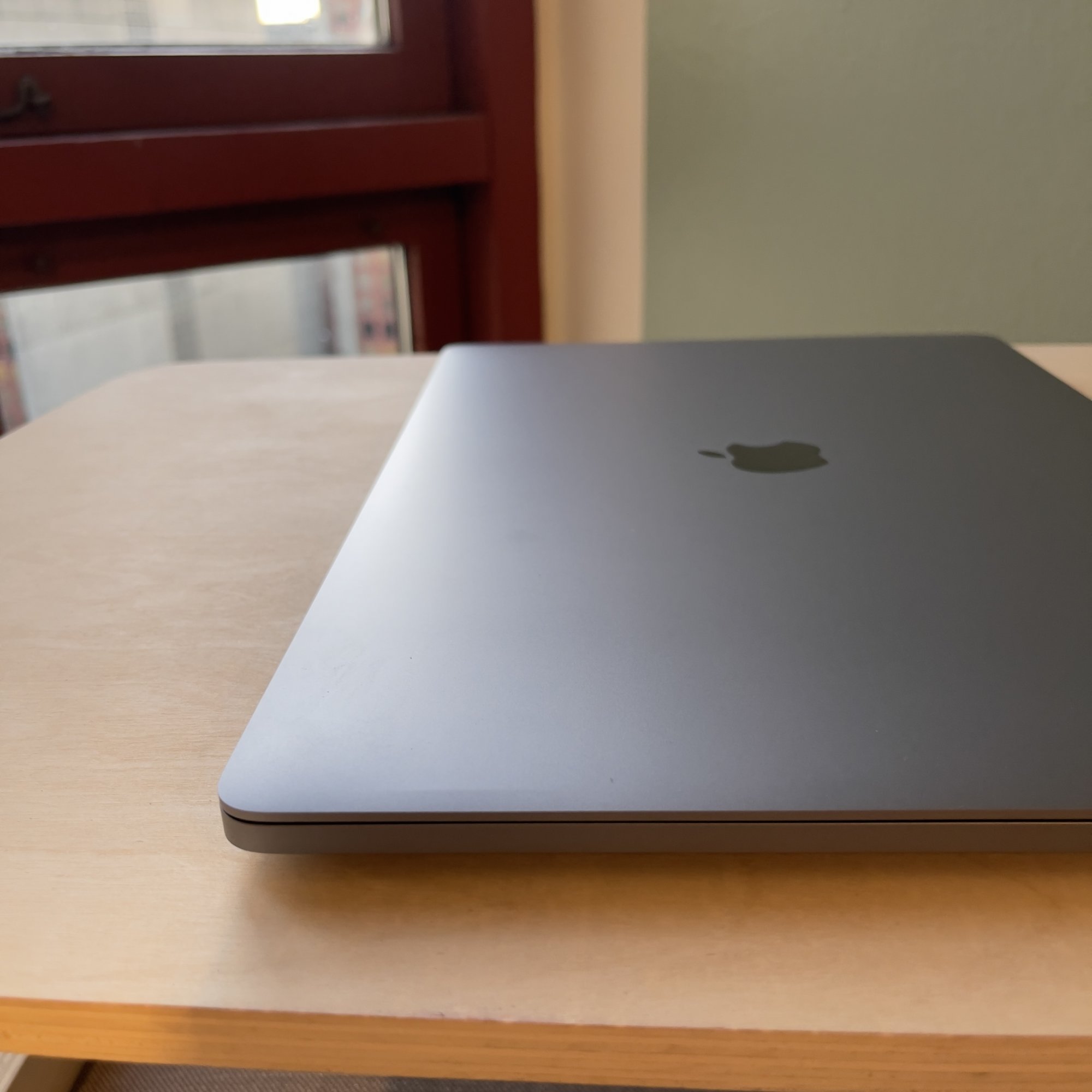

Hi guys! Recently I noticed this weird bulge on the right side of my laptop and I’m not sure what it can be. Some inner parts could be swollen, right?
Quite long time ago (about 2 years) my right speaker stopped working and I know that that’s a hardware issue.
Should I be worried? Right now I need it for work and unfortunately I'm not able to get it checked by professionals.
Thank you.
That bulge coincides with the edge of the speaker driver housing, not with the battery.
I suspect it is therefore not a coincidence that your right speaker no longer works.

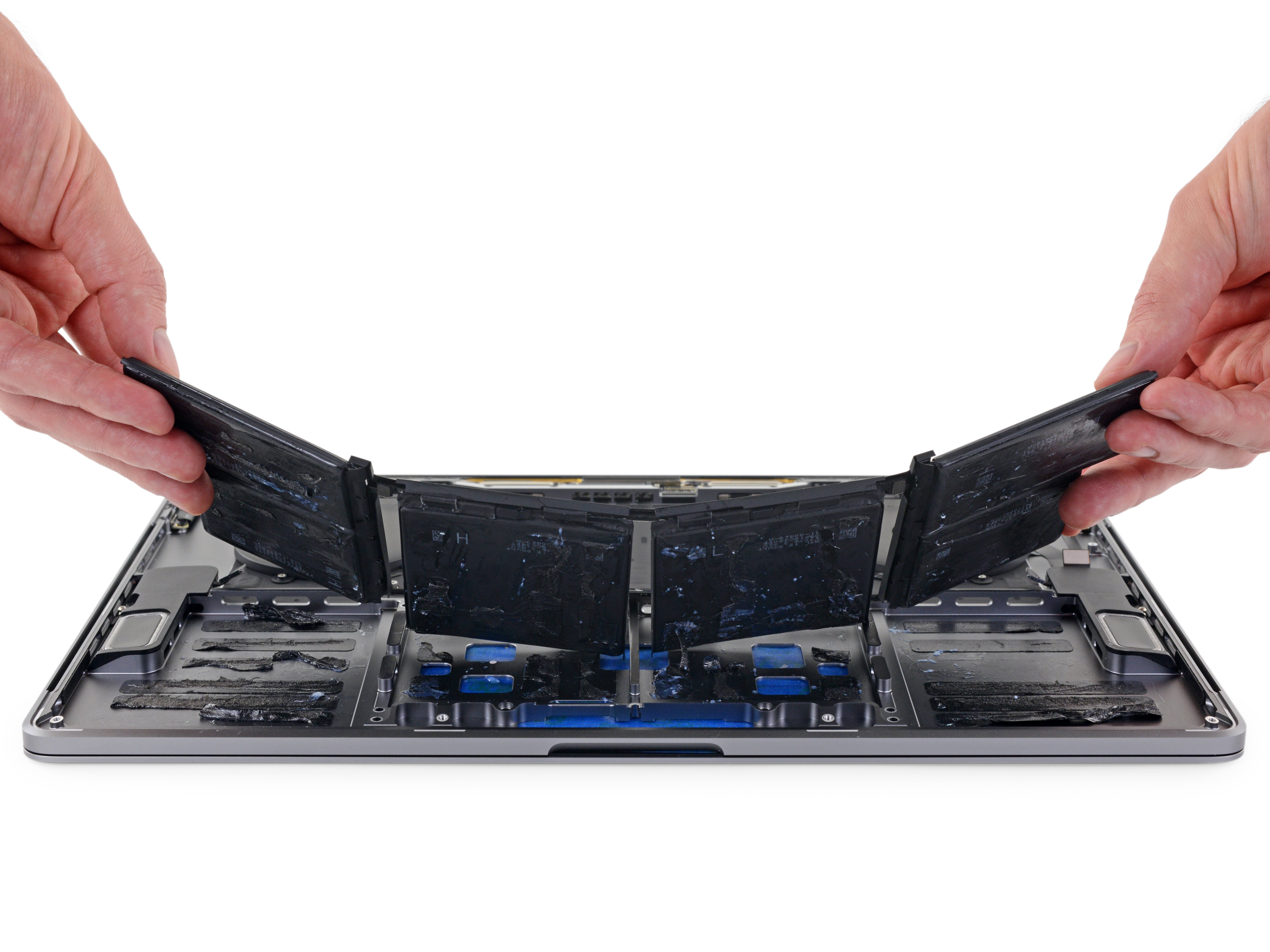

if the battery was swollen, there should be evidence of a slight doming of top and/or bottom of the case in the area of the trackpad, or either side of the trackpad. Try putting a straightedge on these surfaces.
Having had an MBP battery that has swollen, it is not very obvious unless you know what to look for, or it has got really bad. Sometimes the MBP rubber feet will not sit flat in contact on a table.
Take a look at these photos of where the battery cells and speaker driver housing are (he is holding the battery) in this iFixit site:
A possibility is that some sort of pressure has been applied to the underside of the case in the area of the speaker driver, breaking the speaker driver and forcing the speaker driver housing upwards and resulting in that local crease. It would be interesting to see a photo of the underside and side of the case in that area.

It's just weird that that's the only thing that is swollen/bulged is this line.
Path of least resistance...
This is most likely the weakest part of the laptop that is "under pressure", wether that is a design issue or due to a prior impact is hard to tell. If that little extra space created here is all the swollen battery "needs" atm there is no reason for it to push the bottom out.
If anyone is interested in the results 🙈
Apple guy told me that's a physical damage and not a battery thing. They will replace for free my keyboard with top case, including speaker and battery as well... But the parts are not available and they will order them. Gonna stay in Istanbul for couple more weeks.
