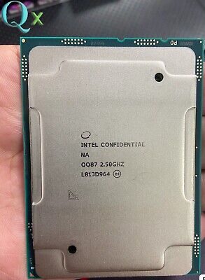

I also just found these the 28-core Xeon also as a "confidential" CPU, however I found a seller from China that sells these QS CPUs for around ~350USD. Why are these so cheap and why should you avoid them? The prices are really cheap so I'm wondering why these are so cheap. I also found a non-QS CPU for around 1,300$.
But I'd really like to know what's wrong with the QS CPUs as I never heard of them before and the prices are insanely cheap 😅
Here's one of the CPUs I found:

These are test CPUs, called ES (Engineering Sample) and QS (Quality Sample), for pre-production of the final product.
It is also illegal to sell those. And there is no guarantee they will function properly.
So I would also avoid those CPUs, as avro707 said.
Xeon Platinum 8280 Processors are different, and only boost to 4GHz anyway.
Cascade Lake Xeons are going to be the final LGA3647 Xeons for workstation and server Systems . It's end of the road and no upgrading will be possible .
Some PC boards support both the Cascade Lake and the earlier Skylake Xeons , so it's possible to go backwards in the PC space .
Your best bet is to wait the three to five years from date of first deployment for data centers to muster out the old Systems and wait for used Cascade Lake Xeons to wind up on eBay when liquidators / recyclers part out these Systems . Then , you'll get some affordable silicon .
But only the W-series Cascade Lake Xeons will work properly in our Mac Pro 7,1 machines and those chips are rarer than other Cascade Lakes . Other installed Cascade Lake Xeons will not survive a NVRAM refresh .
The W series chips are so rare I sold the very first one on eBay . It sold at full Intel MSRP for a new processor in four days and was a previously used chip to boot . And , the buyer pleaded with me to sell him some more chips if I had them in inventory . I had only one .
So , these W series chips are going to be in demand for some time now ... which will push up the price higher than normal even for used processors .
I would avoid the Platinum CPU

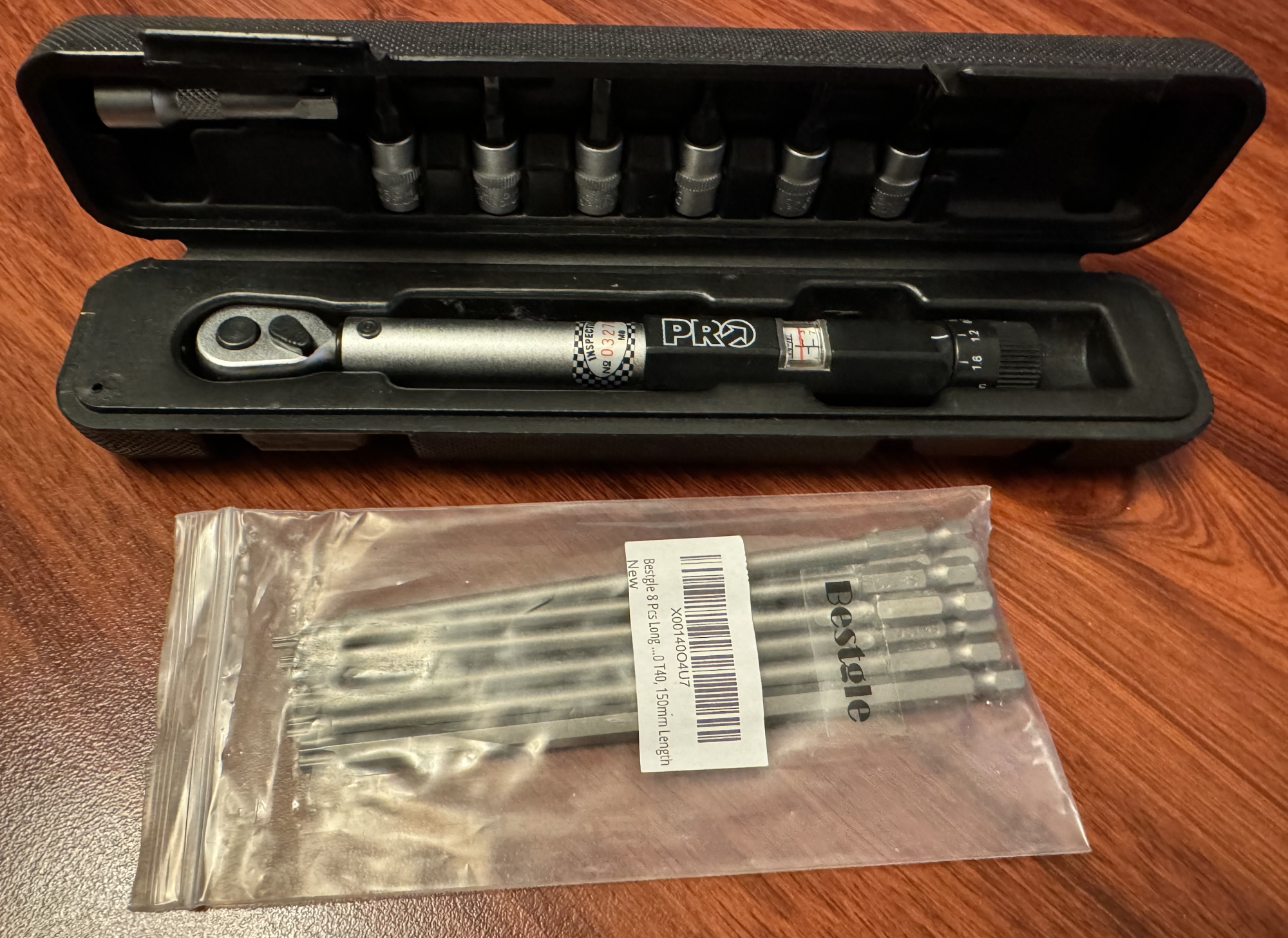

If you haven’t done the CPU upgrade yet, don’t be scared. Just follow Apple instructions to the letter and you’ll be fine.
Make sure you use a small adjustable torque wrench or the special Wera adjustable torque driver to tighten the heat sink screws.
The 7,1 is a beautifully designed machine that is very easy to work on.
This was the torque wrench I used for tightening the heatsink screws, straight from bicycle toolbox.:
From "Pro" brand which I think is within the enormous Shimano empire these days. Mine has adjustability from 1.0 to 15Nm.
The Torx bits were from Amazon and I used an adaptor to fit them. They are 150mm long, which is important. Also useful is a very bright light so you can see the tops of the screws - they are deep inside the heatsink and hard to see otherwise. I just used a 1600 Lumen bicycle light for that.
That process of fixing the heatsink back in place seems pretty crucial that it is done to specs.
