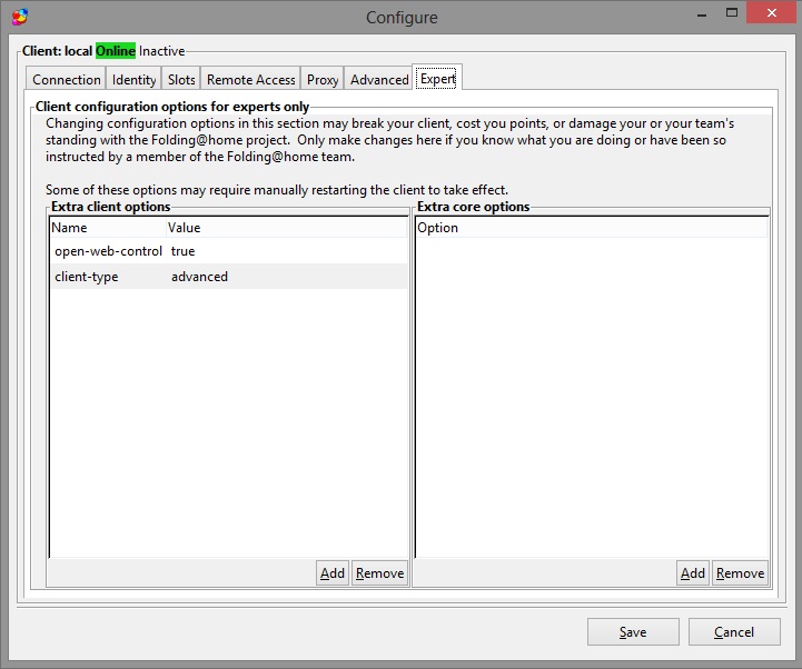

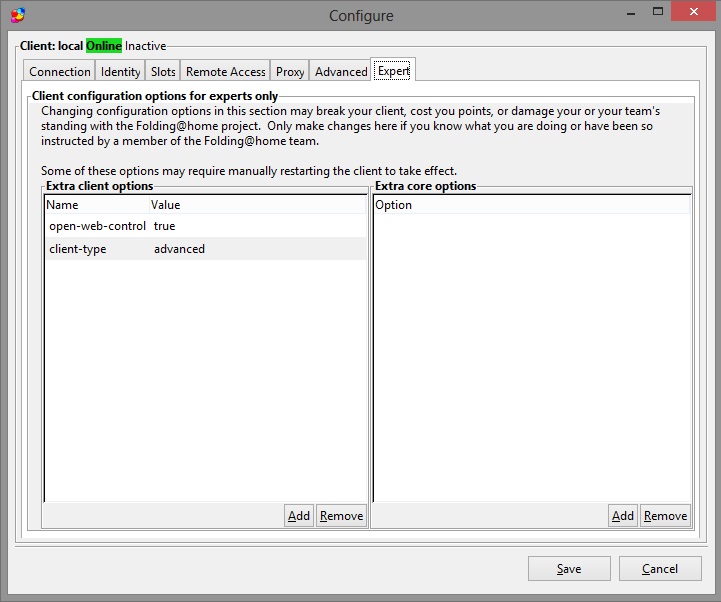

I do have a passkey, not sure what this client-type=advanced is or where it should go.
I may be getting a Titan in the next few months... I do 3d rendering and have been contemplating one. It'll probably fold nice too.
it's under configure, then expert, then you add an option, the name is:
client-type
and the next field put in:
advanced
and save the configuration and you should be good to go.

But what's it do?
setting that "advanced" flag enables you to pull in Core17 GPU work units (if your card is running under windows 64 bit, with a client 7 and is eligible for it. then if your card can finish the work unit before the preferred deadline then you get bonus points in addition to the base points... (can also do nVidia cards under Linux but not AMD)

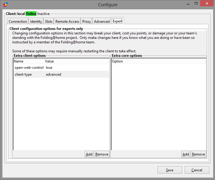

client-type
advanced

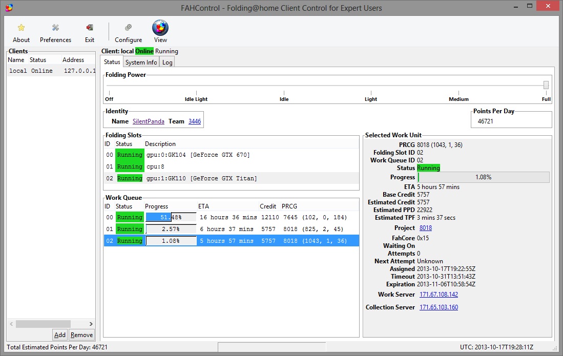

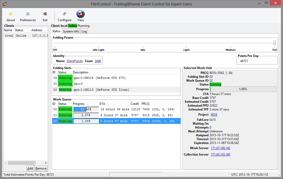

All cylinders firing now! :D
I literally just started it so I expect the PPD to increase a fair amount as it figures out how fast it can go.

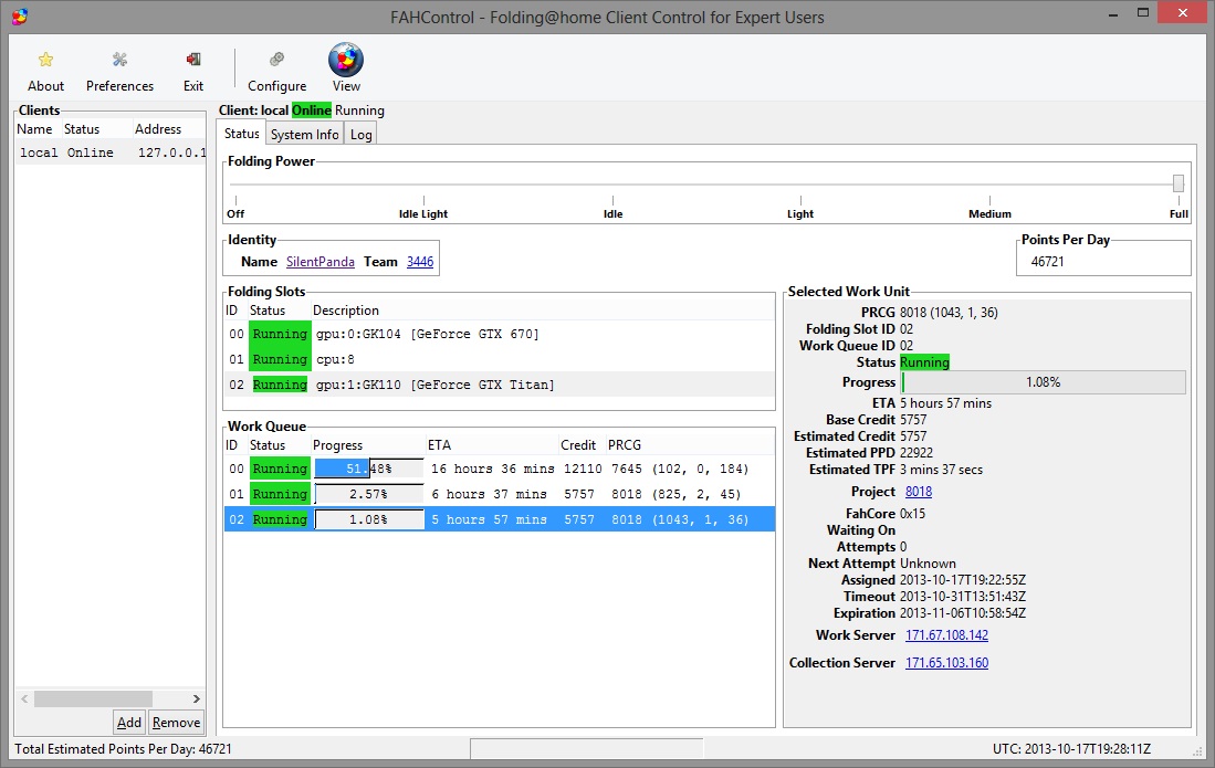

Nice !!
Seems you didn't configured client-type = advanced for the Titan-slot. You fold with a core 0x15 project. That a nice, legacy but not bring too much points. You see only a boost and bonus points (QRB, quick return bonus) with advanced project (project 8900, 7810, 7811).
Nice !!
I've had client-type advanced in extra client options since you mentioned it. The client has definitely been restarted since I had to shut off my computer to install the new card.
