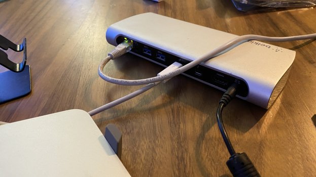

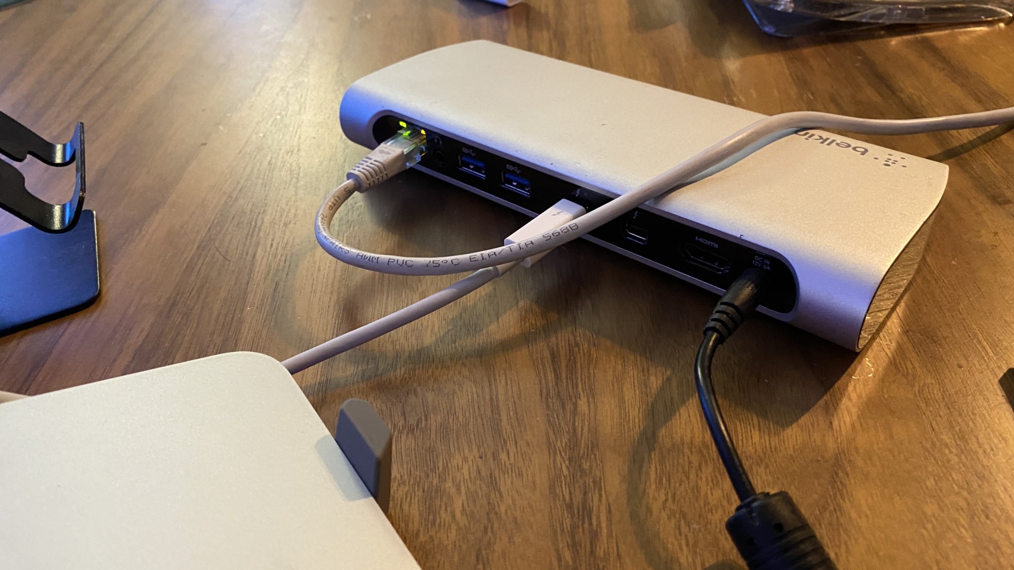

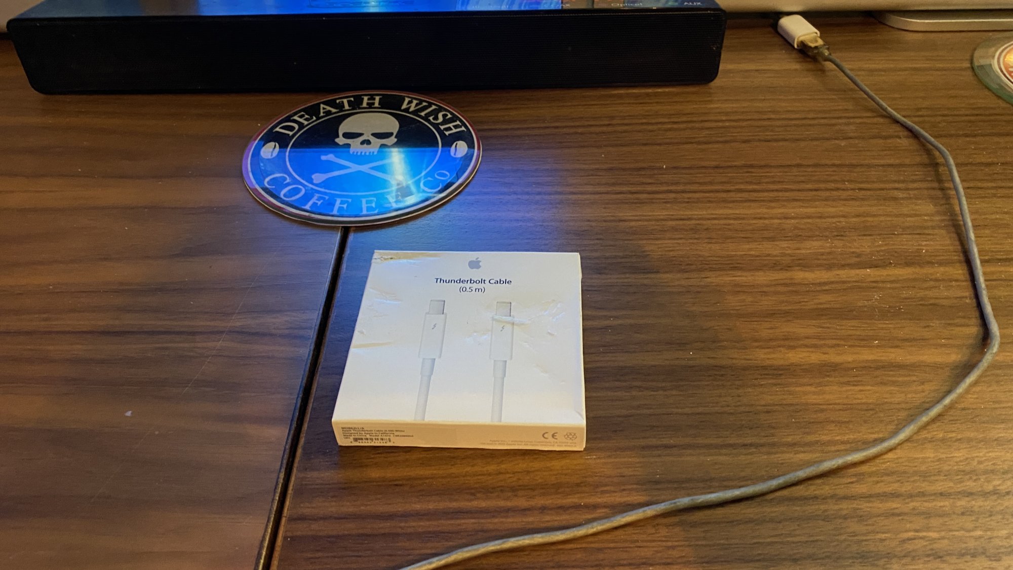

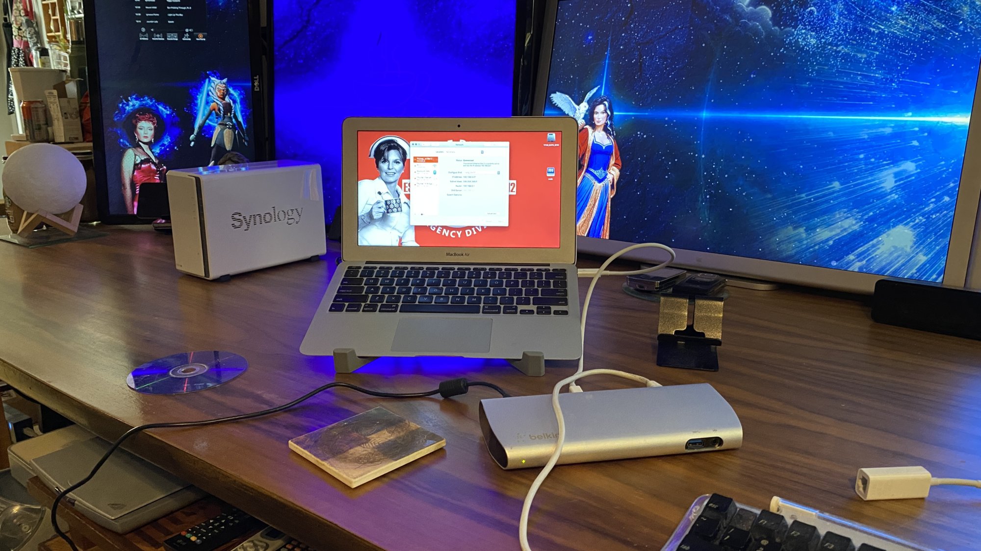

Synology NAS finally arrived - 6TB, came with the drives. Will be working on that quite a bit later. It's going to replace the PowerMac G4 'NAS'.
But, what I was testing when I took the pics was the Thunderbolt 2 dock. I bought it based on the picture the seller used, which showed a Firewire 800 port. Sadly, the seller used the WRONG picture and I got the device with the HDMI port. Had I known that, I would not have bought it. The seller did refund 1/3 of the price because of that though. So while I'm not happy, it's acceptable. There are two versions of this dock it seems. One with the HDMI port and one with the FW800 port. Guess which one is the hardest to find?! Yeah, Firewire.
It's like the seller I bought the black denim pair of Dickies shorts from. That guy sent my shorts off to China and sent me a box full of Happy Meal toys! SMH!!!
Anyway, I still have use for it. But I needed a TB cable. That finally arrived today and I could test the dock. It's working. :D
