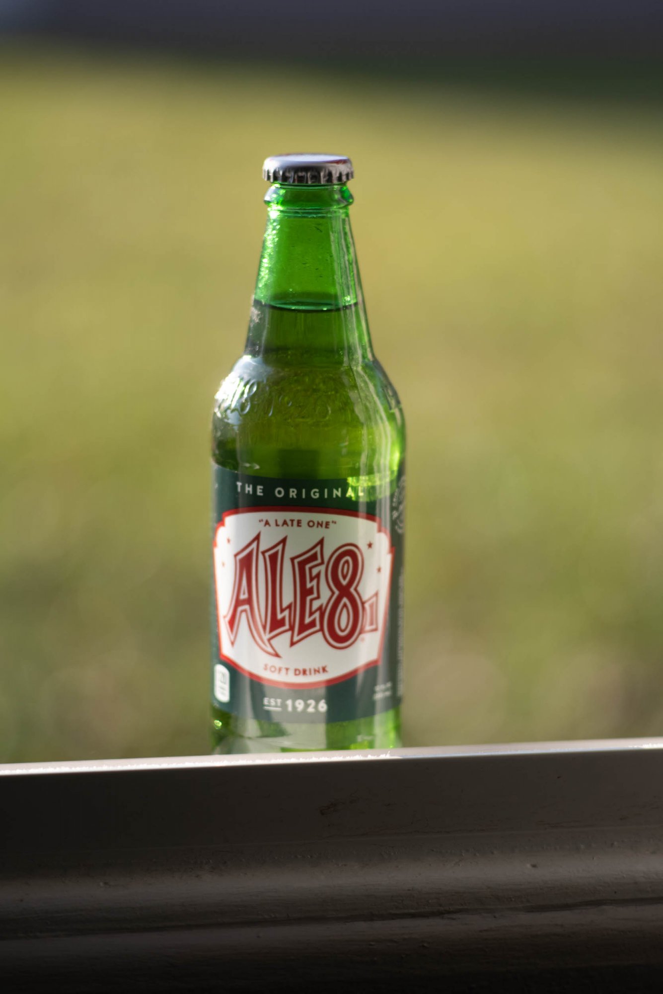

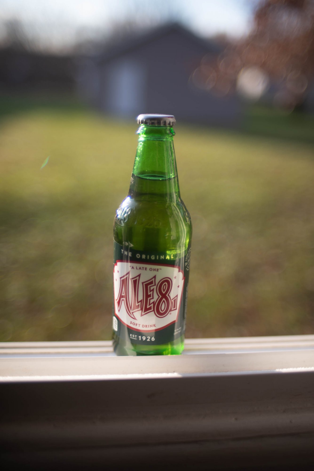

I took several photos this afternoon with varying lenses with different properties to try and illustrate this. Since it was cold outside today, you get to see a boring photo of Kentucky's finest soft drink, Ale-8-1, sitting on the windowsill with my back yard in the background.
In any case, here's a sort of classic example. This is a manual focus Nikon 105mm f/2.5 lens, a staple of the line-up for years. As a minor point, there are two different optical formulas for this lens. This is the older formula, which is in a "chrome nose" body-I slightly prefer its rendering, although in these examples I couldn't see a difference so you're only getting oneView attachment 1916374

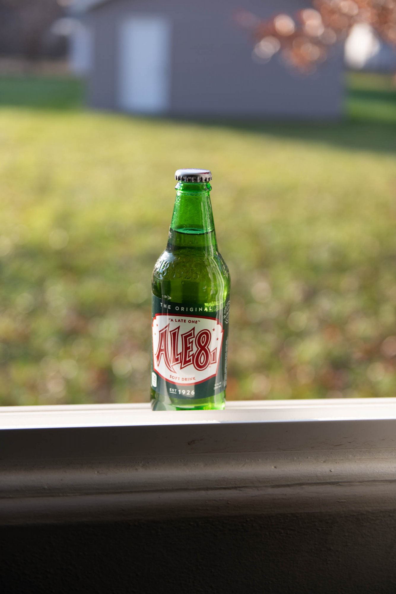

With that said, there are areas where it could be called a bit "busy" so let's go to something different that might render a bit smoother-this is my 70-200mm f/2.8 AF-S VR, a fairly complicated lens but one that still retains really smooth bokeh thanks to its large aperture and long focal length. Notice how the background essentially melts into just a smooth, even rendering of the grass and a very blury transition to the shed outback.

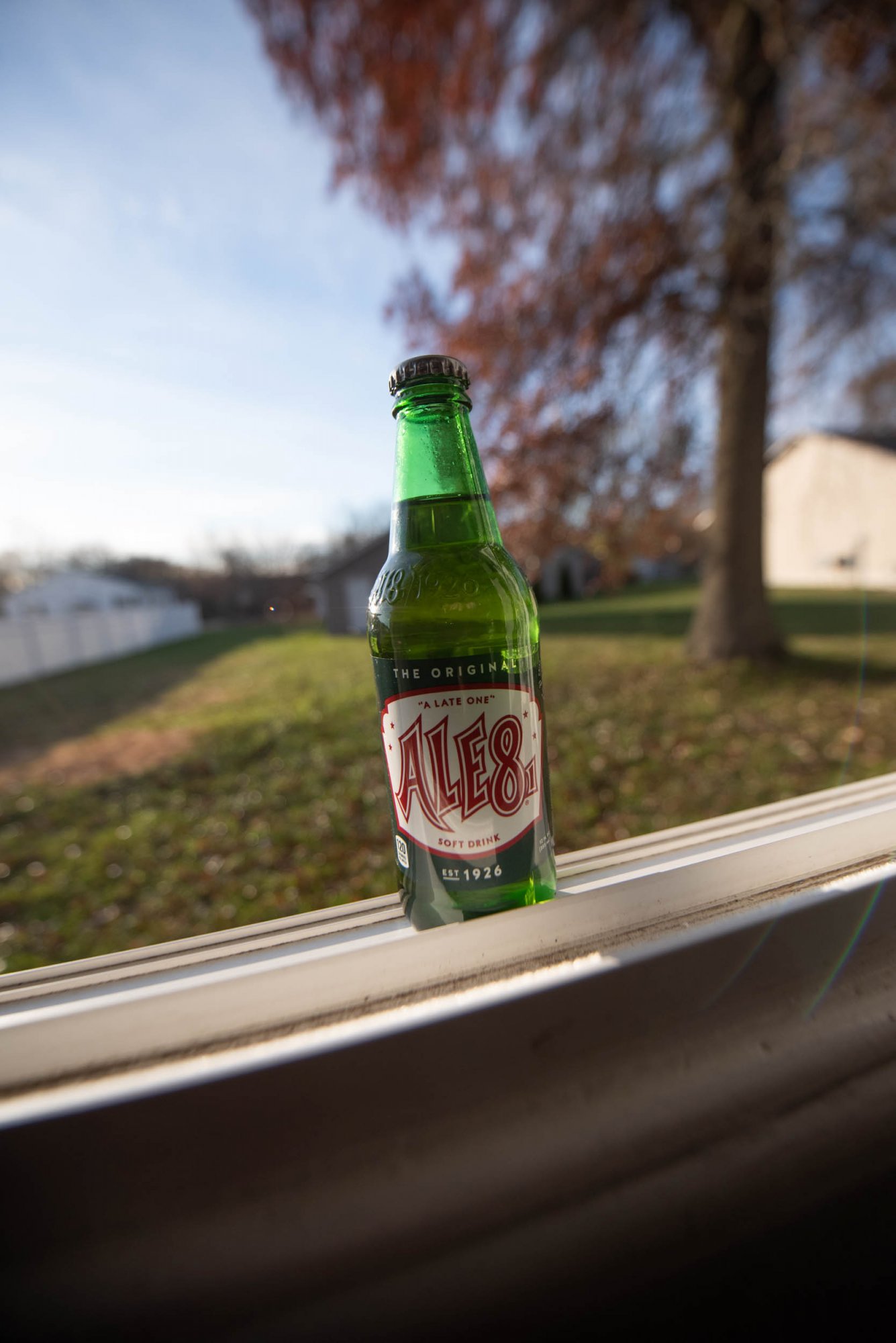

To go the other way, though, let's look at a couple of other modern f/2.8 zooms-the 24-70mm f/2.8 AF-S, and the 14-24mm f/2.8. Often, wide angle lenses in particular are not as pleasing

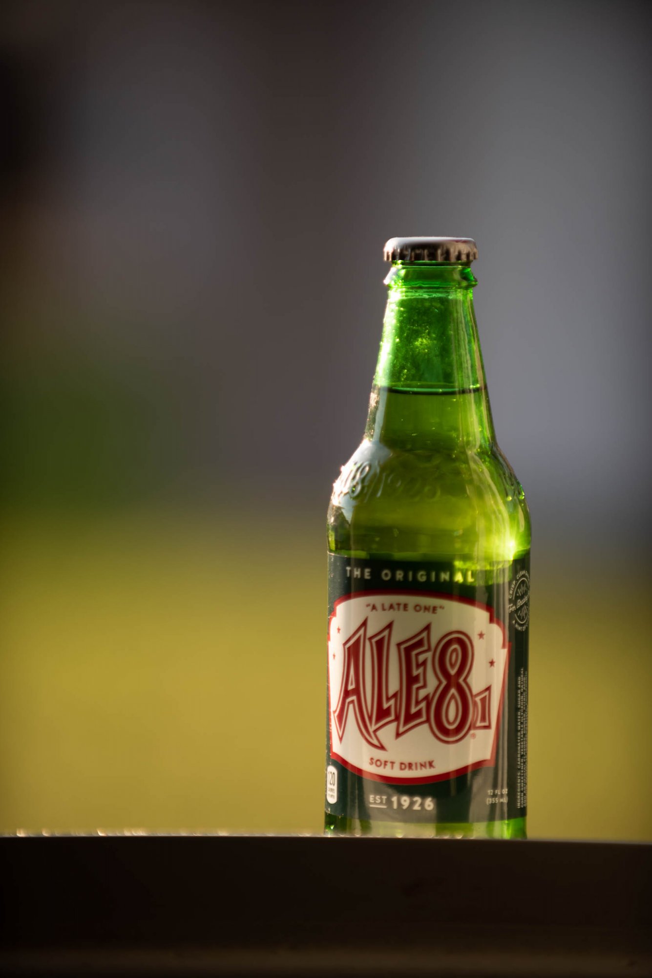

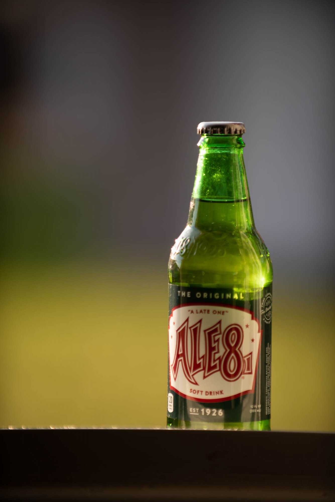

Even wider primes aren't immune to "busier" bokeh. Here is another Nikon legend, the 35mm AI-s f/1.4. This lens has a large aperture and loads of uncorrected spherical abberation, but it's still not particularly great. I suspect that some of Nikon's advanced tricks-in particular the floating element("close range correction") play into that somewhat.
Although the background is nicely out of focus, the bokeh of this lens has one fatal flaw. Notice that OOF highlights are rendered as bright "rings"-often the opposite is desired where the light has a more Gaussian type distribution toward the center of the disk. This can make the bokeh of this lens somewhat distracting.

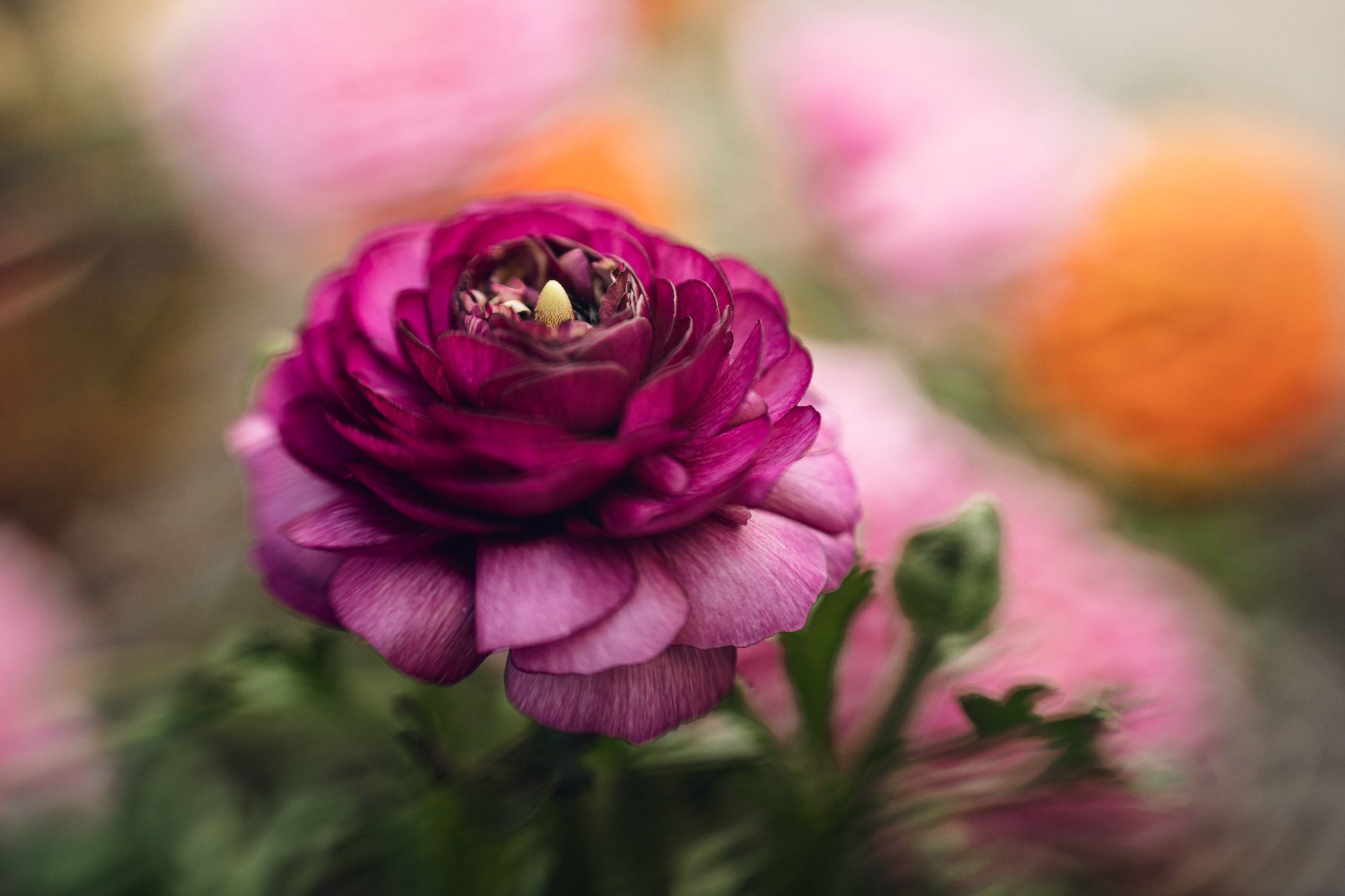

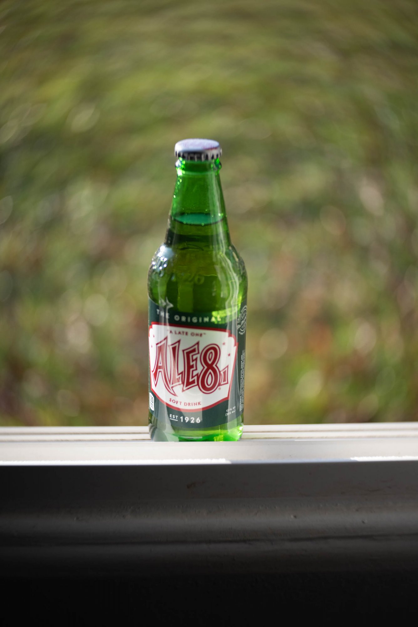

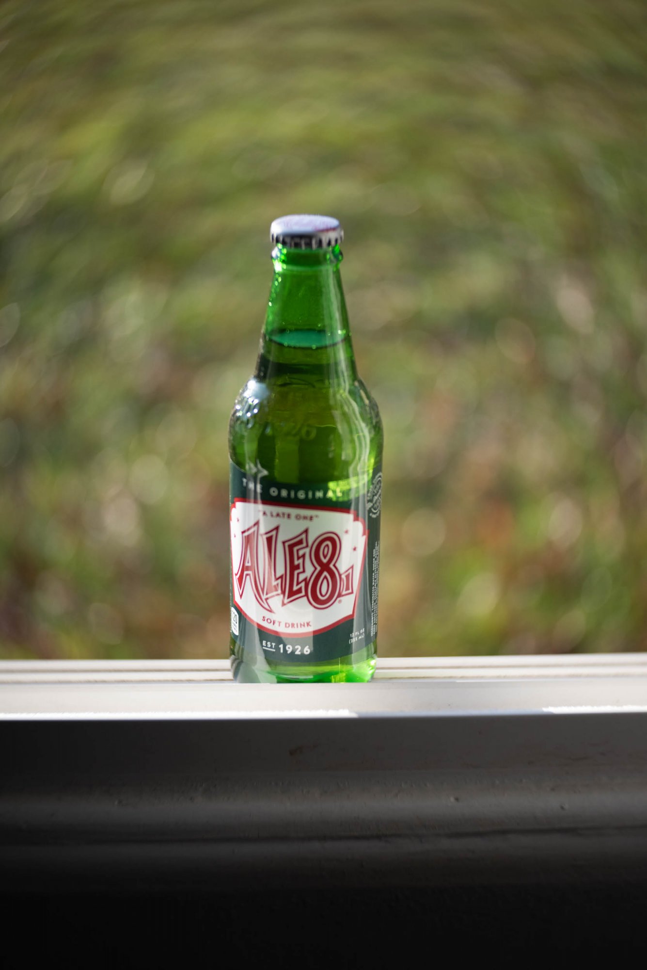

I'll wrap this up though with an example of a lens that has what some might call distracting but I call interesting Bokeh. This is a Lensbaby Twist 60, which uses one of the oldest computed(rather than trial and error) lens formulas called the Petzval. When these lenses first came on the market in the ~1890s, they had some of the best center sharpness around, but not a particularly flat field. What's more of note, though, is that they tend to render what's often called "Swirly" bokeh-I think you can see it clearly in this photo. This is something of a signature of Petzval lenses(although I've also seen it in a few other more advanced formulas, like the Auto-NIKKOR-S 5,8cm f/1.4) although there are other designs with their own signature bokeh.
The same swirly effect can be achieved with a Fujian 50mm TV lens and suitable adapter, in this case at f/1.4 ;)
An extreme effect can also be given with an old Helios 44-2 58mm, especially if the front element has been reversed, but this may be one step too far...

@Hughmac , your examples show how a skilled photographer can use the 'interesting' bokeh to enhance a photograph. In your first example the swirl draws your eye to the rose and creates a frame.

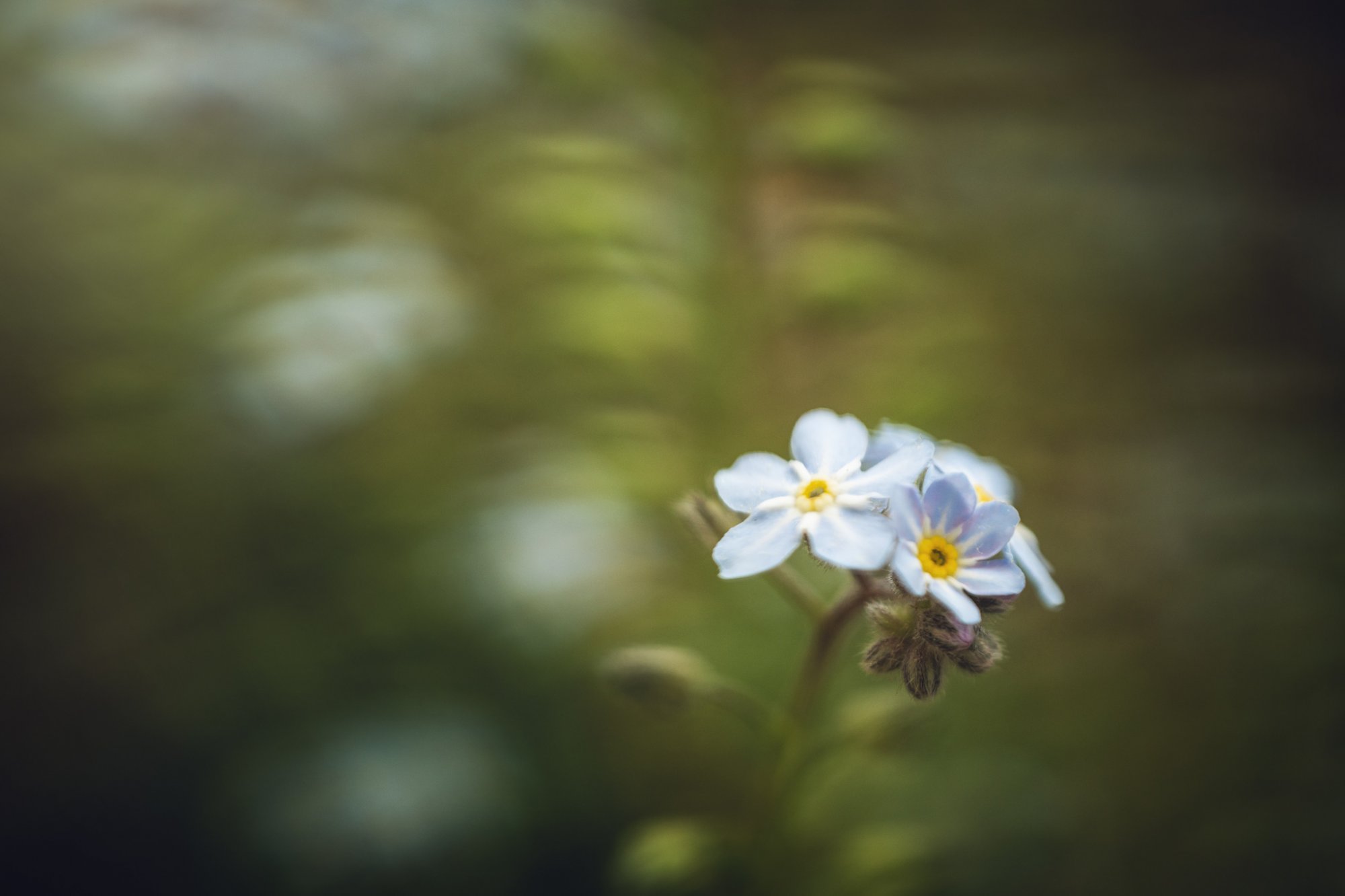

Okay, I said I'd be back with some of my own samples. I know there are those among us who don't like Lensbaby images, but the fact is part of their appeal/look is the blur pattern they can make. Feel free to skip over my post if these offend you in some way. There are other Lensbaby users who might appreciate this post, and I mention other traditional lenses as well.
The first two are the Velvet 56. The leaf one is stopped down a bit, I would guess probably f/4-5.6. Unfortunately because they are manual lenses the apertures don't get marked in the exif, so unless I add it in as a keyword, I never actually know looking back where I shot it. But the leaf one is interesting to me becaue it has both circular (further back) and hexagonal bokeh (the headlights). I know we aren't supposed to like hexagonal (septagonal??) bokeh, but sometimes I really like the effect.
This second one is shot wide open, probably at 1.6. Notice the ring/circle shape of the water drops. This is a hallmark of this lens (and the other two Velvet lenses in that line).
