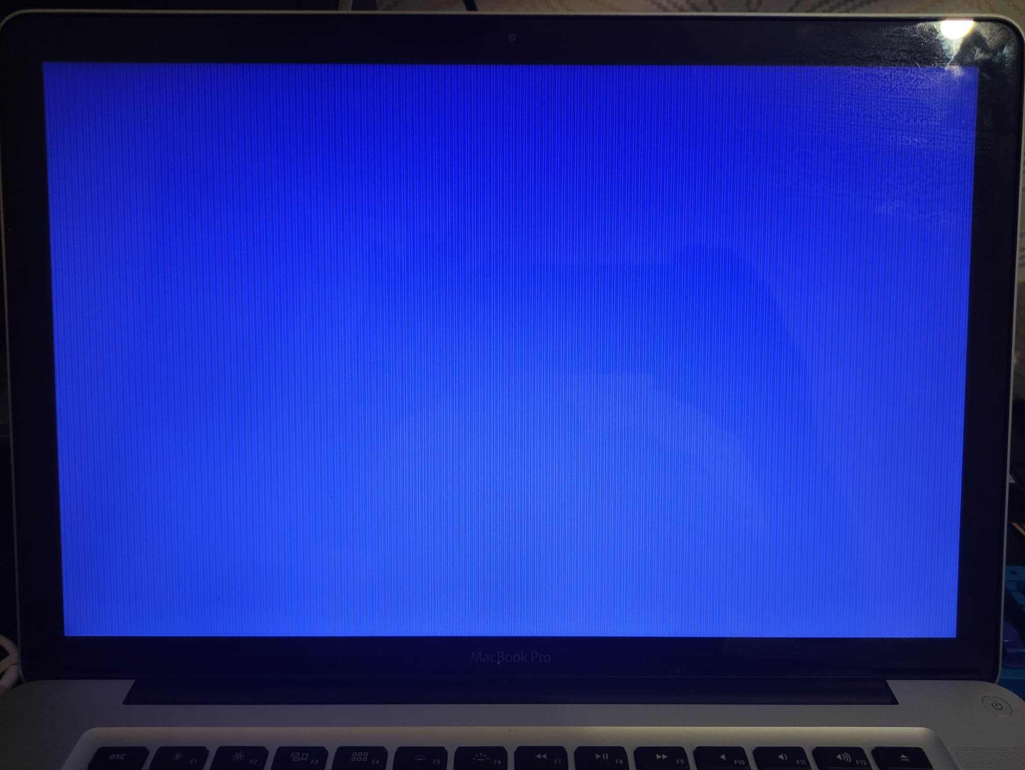

When I switch my 2011 Macbook Pro with High Sierra installed, I cannot boot into normal, safe mode, recovery etc, I just get the apple logo for about 2 minutes then goes to a blue screen (see pic)
I've reset the PRAM and the SMC.
All I want to do is reinstall the OS back on but I cannot think of a way to do it :( 438254951_1075604550209562_1902313223365360316_n.jpg

Blue screen can indicate a software incompatibility. Have you installed anything recently?
You may have to start up from external USB media.
First I would triple check you are using the key combinations for different start up modes.

It looks like you need to have the solder reflowed on your GPU. This is a known issue associated with the 2010 & 2011 MBP laptops.
This is the typical fix for a failed GPU issue found on these laptops . . .

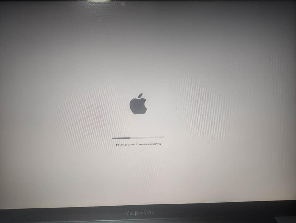

Anyway, UPDATE, Managed to get it to reinstall, well sort of. At the end of the installation it says "MacOS cannot be installed on your computer. The installer resources were not found. Quit the installer to restart your computer and try again.
So I did and this same error keeps coming up.
So now I want to start with this brand new hard drive i've got just incase the one in the MAC is faulty. How do I get the Mac to recognise it when I press the power and press the OPTION button?

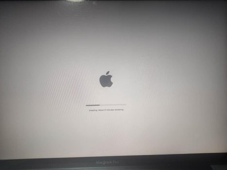

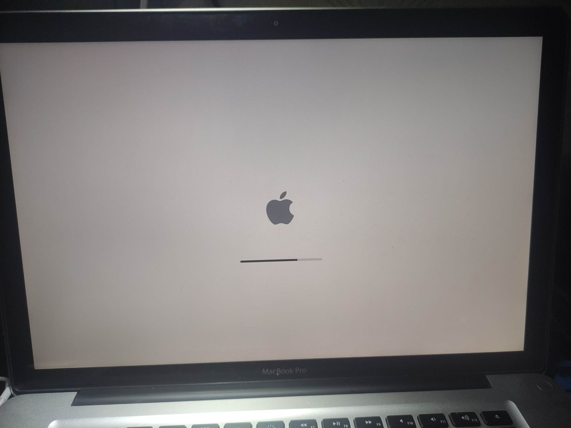

It installs in the first picture, then it just stops and nothing happens (second pic) 440150760_1075779370192080_105044187478880615_n.jpg 440431225_1075779466858737_3731319249220894549_n.jpg
