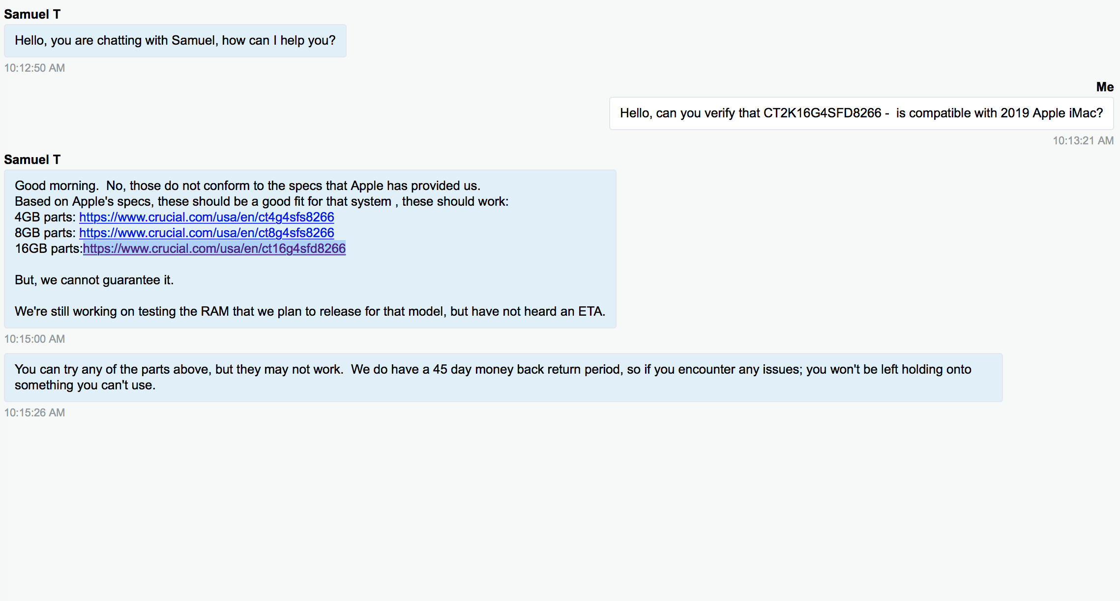

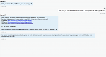

FWIW I had a chat with Crucial (attached)
I asked about the 2x16gb kit -
CT2K16G4SFD8266 and they said no - but then they turned around and recommended what looks like exacrly the same part in single 1x16 RAM. DOH!
Their 1x16gb recommendation -
CT16G4SFD8266
Shopping that part online I found that buying Crucial direct was (in some cases significantly) less expensive than via resellers. They recommended Macsales - apparently a dealer of theirs - but $140 direct for 32gb vs $205. No thanks.

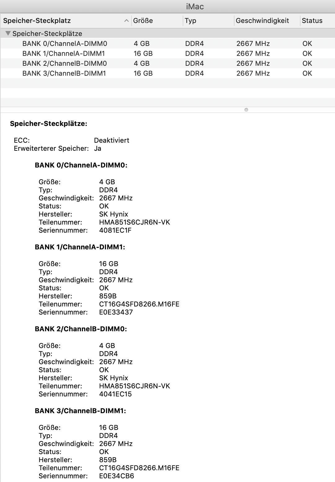

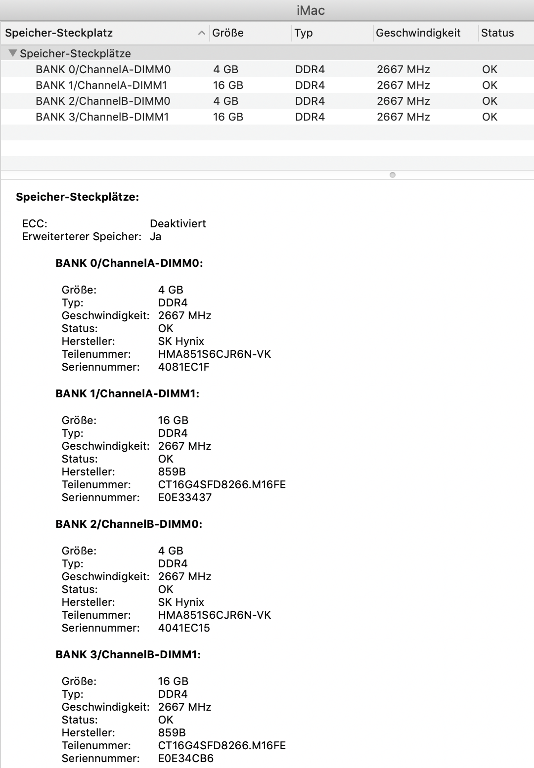

I use the Crucial 2x 16GB:
Crucial CT2K16G4SFD8266 32GB (16GB x2) kit (DDR4, 2666 MT/s, PC4-21300, Dual Rank x8, SODIMM, 260-Pin)
The combination with the pre-installed 8GB (SK Hynix) works fine, with the right clock frequency (see screenshot).

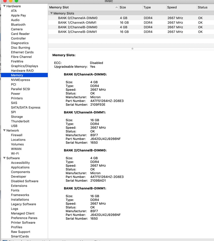

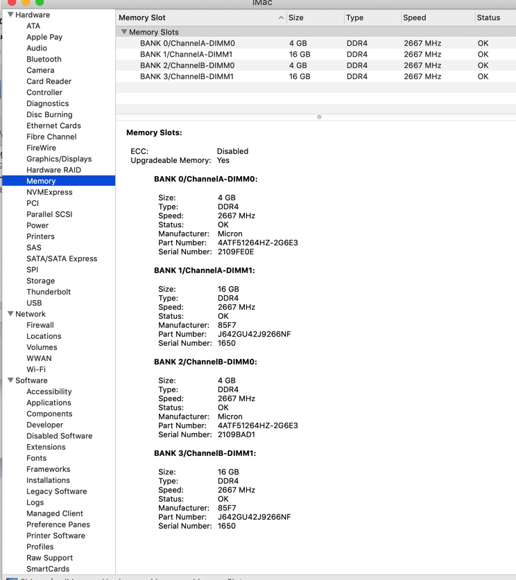

Hey
I Bought 2*16gb ram directly from OWC and After I installed them, I viewed the System Profiler, and it shows that the two Rams have the exactly same serial numbers..How come??
Serial (and other) numbers are just strings returned by the RAM in response to specific queries. One of my OWC modules has Manufacturer: 0 and Part Number: Unknown. What you and I are seeing reflects, in my view, that OWC is packaging memory from wherever it can get it cheapest - there is no consistency apart from the OWC sticky label.
