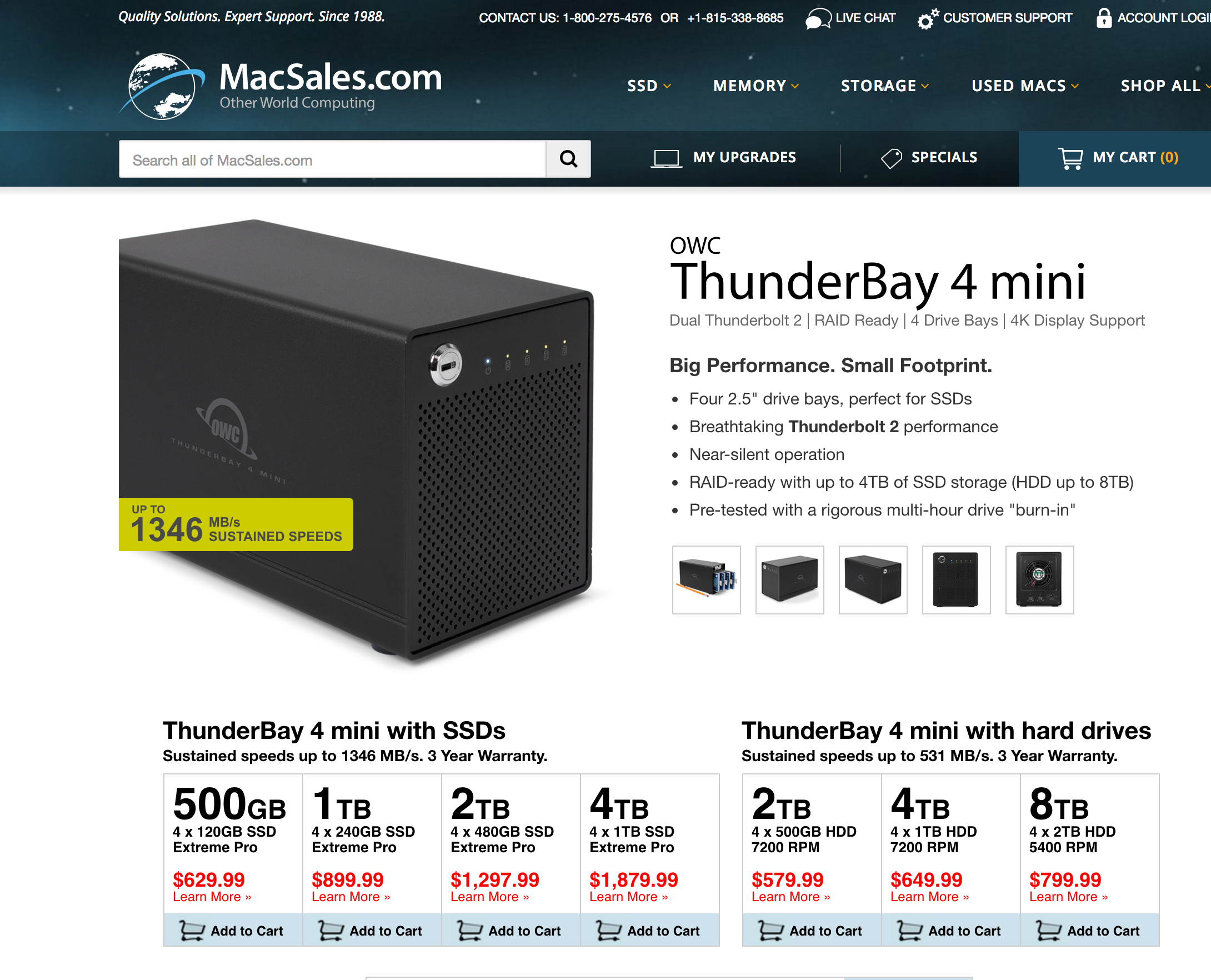

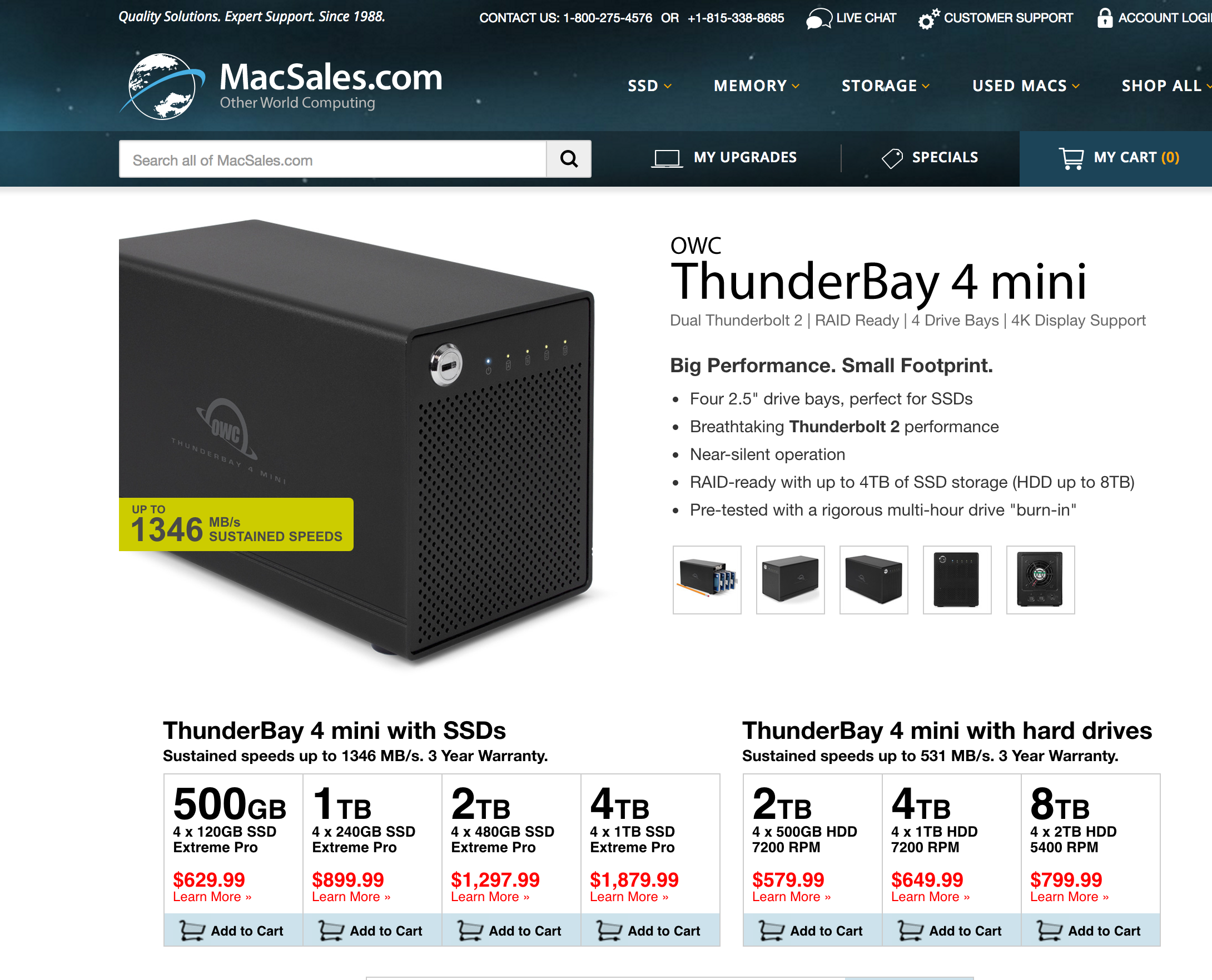

I have 2 of these with 4 Samsung SSD. One with 1T x4 in Raid 0 and 1 with 4 1tb in 2 raid 0 arrays...smokin fast
[doublepost=1504571224][/doublepost] upload_2017-9-4_18-26-6.png
The
the latest is thunderbolt 3 - no good for an iMac 27 inch late 2013
[doublepost=1504571224][/doublepost]View attachment 715883

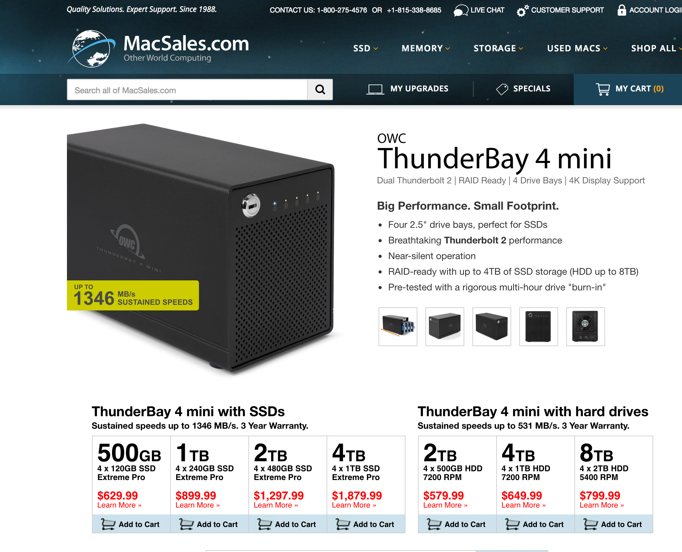

Just out of curiosity. Are you a professional making money out of these machines? Your setup looks wonderful but I'm just thinking if it would not be an overkill for a guy that just wants a faster computer? I'm going for opening my iMac late 2013 and installing a 256 GB flash blade SSD and a samsung EVO 850 500 GB for around 700 USD(with the OWC kit with thermal sensor) . The SSD comes from a Mac Pro and is capable of 1500-2000Mb/s transfer rates I dont know if the PCIE in my iMac late 2013 would actually support those speeds. Thank you for your answers!.
