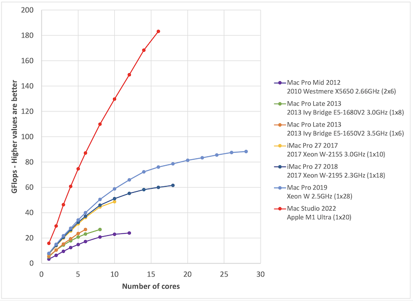

Unless the software is specifically written to make use of the CPU/GPU cores, you aren't going to see any impressive iStat charts showing your system humping all the available resources (which as noted above can be perfectly normal). Even then, simply adding more cores does not scale your results as expected. An exception I did note elsewhere (sorry - can't find author's name to give proper credit) one Studio Ultra user who was doing Fluid Dynamics simulations and saw totally jaw-dropping performance gains over previous Mac hardware options. See:
I found an application that absolutely takes advantage of all the cores in the M1 Max... Handbrake...
Run Handbrake converting video files, and all cores are maxed in the most beautiful way. The two Efficiency cores take care of all the other stuff, and the eight Performance cores are all focused on handling Handbrake.
