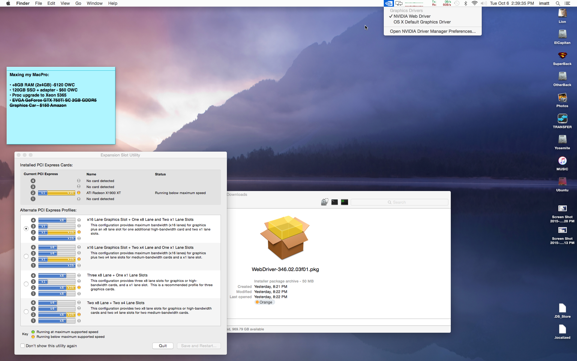

Radeon X1900 in slot 1, GTX 750 recognized in slot 2, nVidia drivers enabled.
Then I shut down, swapped the cards (GTX 750 in slot 1, Radeon x1900 in slot 2) rebooted and got:
Login screen ?
