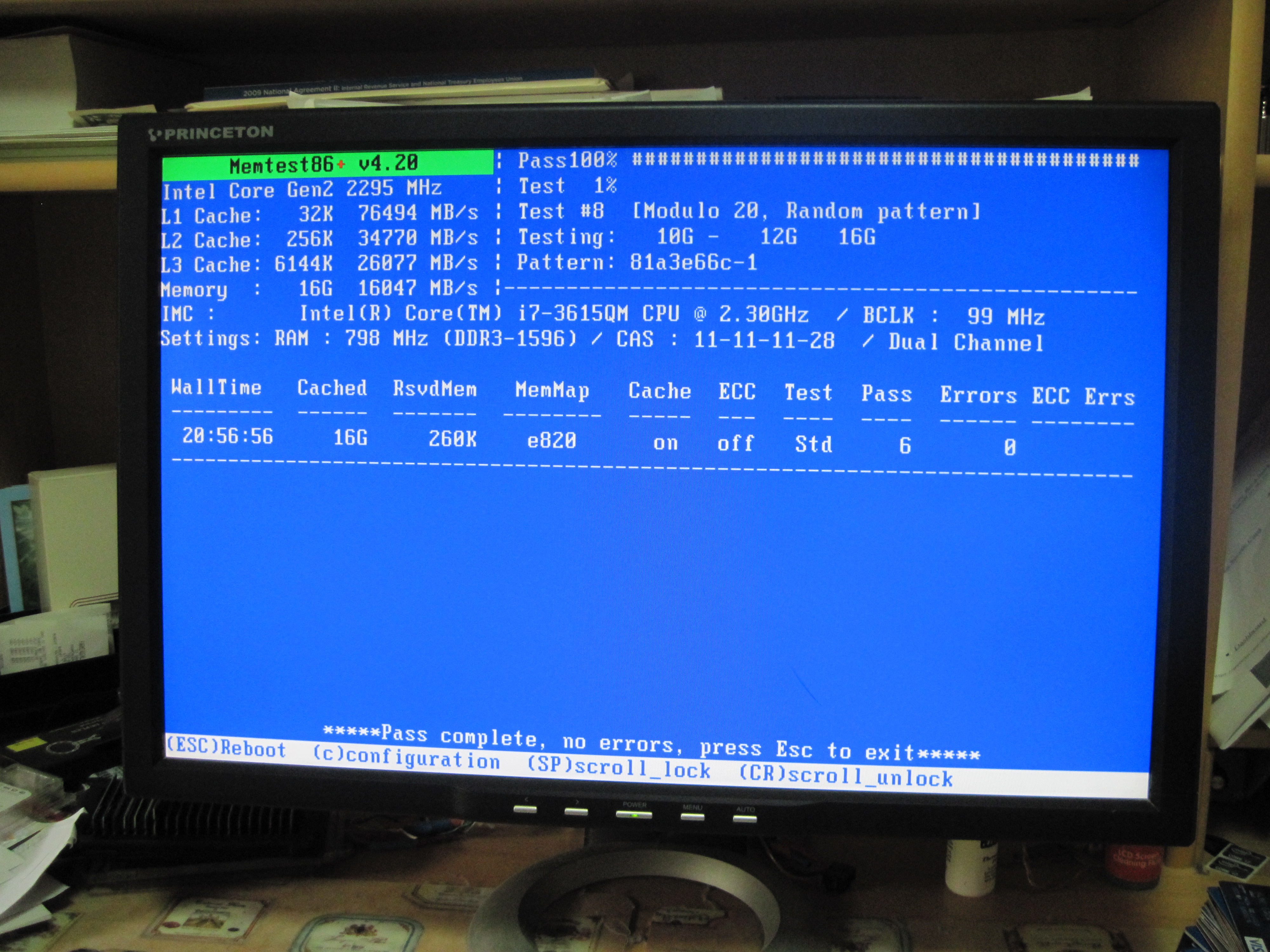

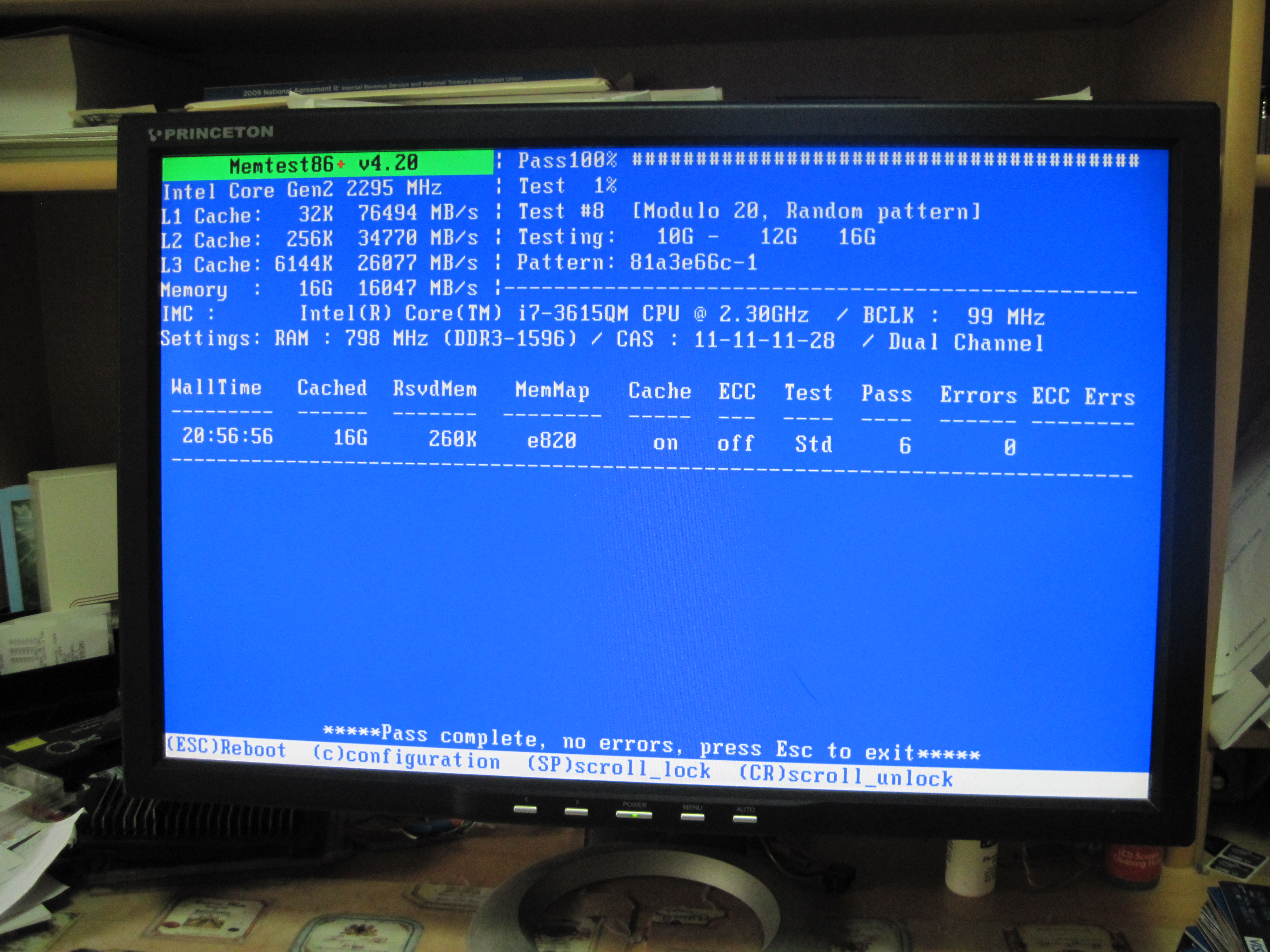

you can get timings you need to burn memtest 86+ to a dvd stick it in a dvd player and restart with your finger on options pick the dvd player and you get this. those are a pair of crucial 8gb sticks timings are
11- 11- 11 -28
I ran that test for 21 hours. It was a 2.3 quad 2012.. if you can get the 1866 to run better then 1600 during 10.8.x ML I would be stunned.
11- 11- 11 -28

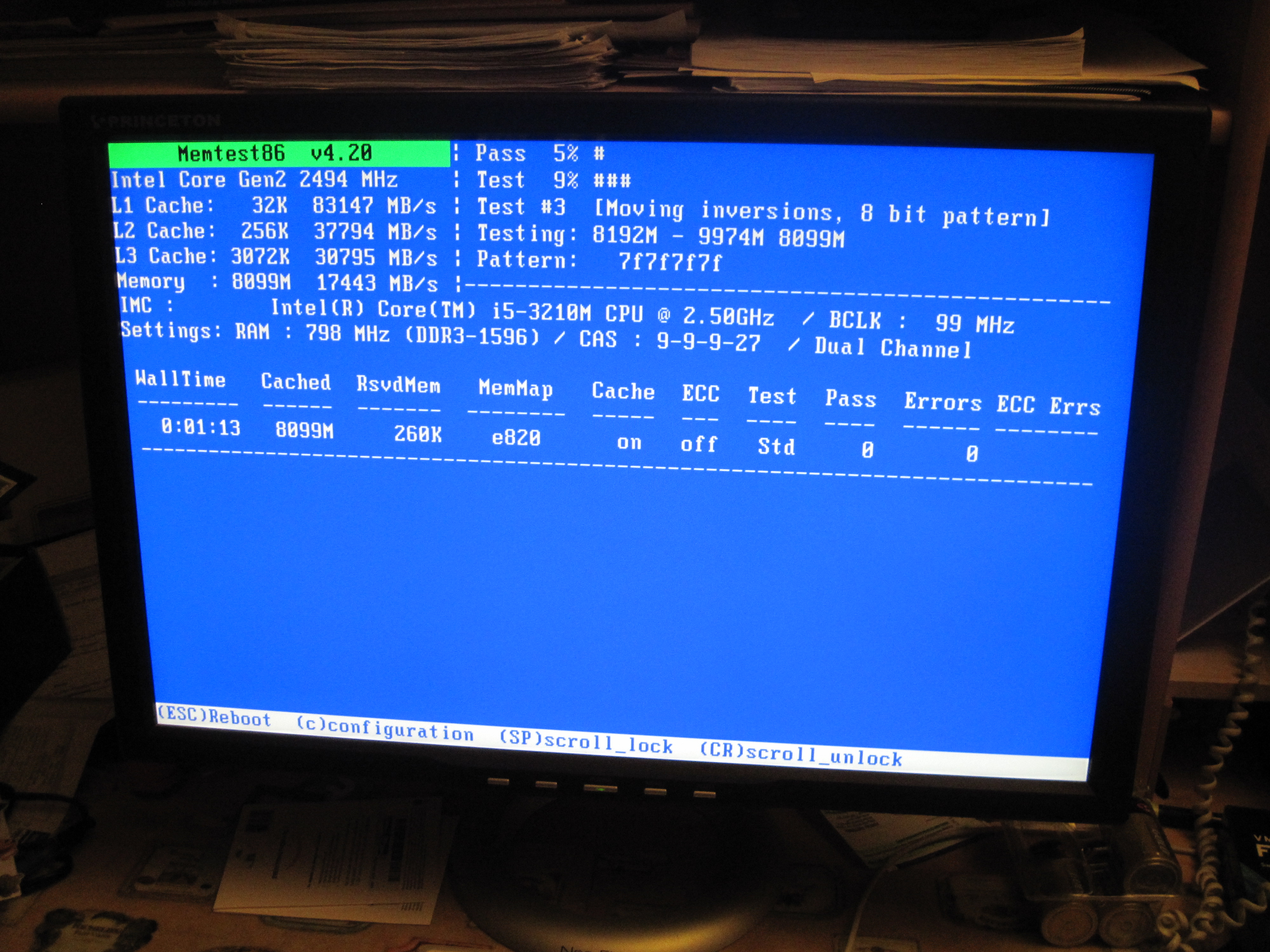

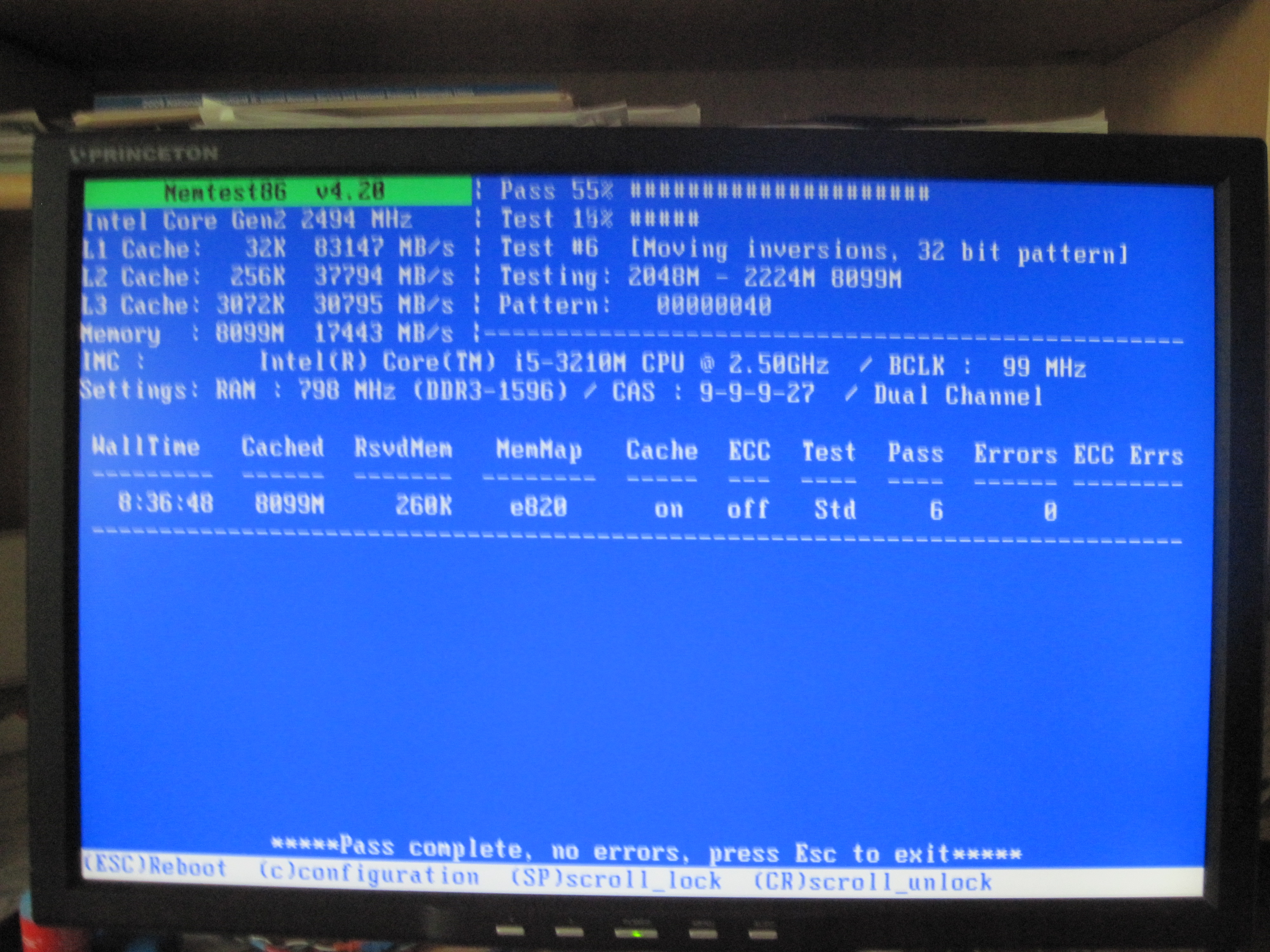

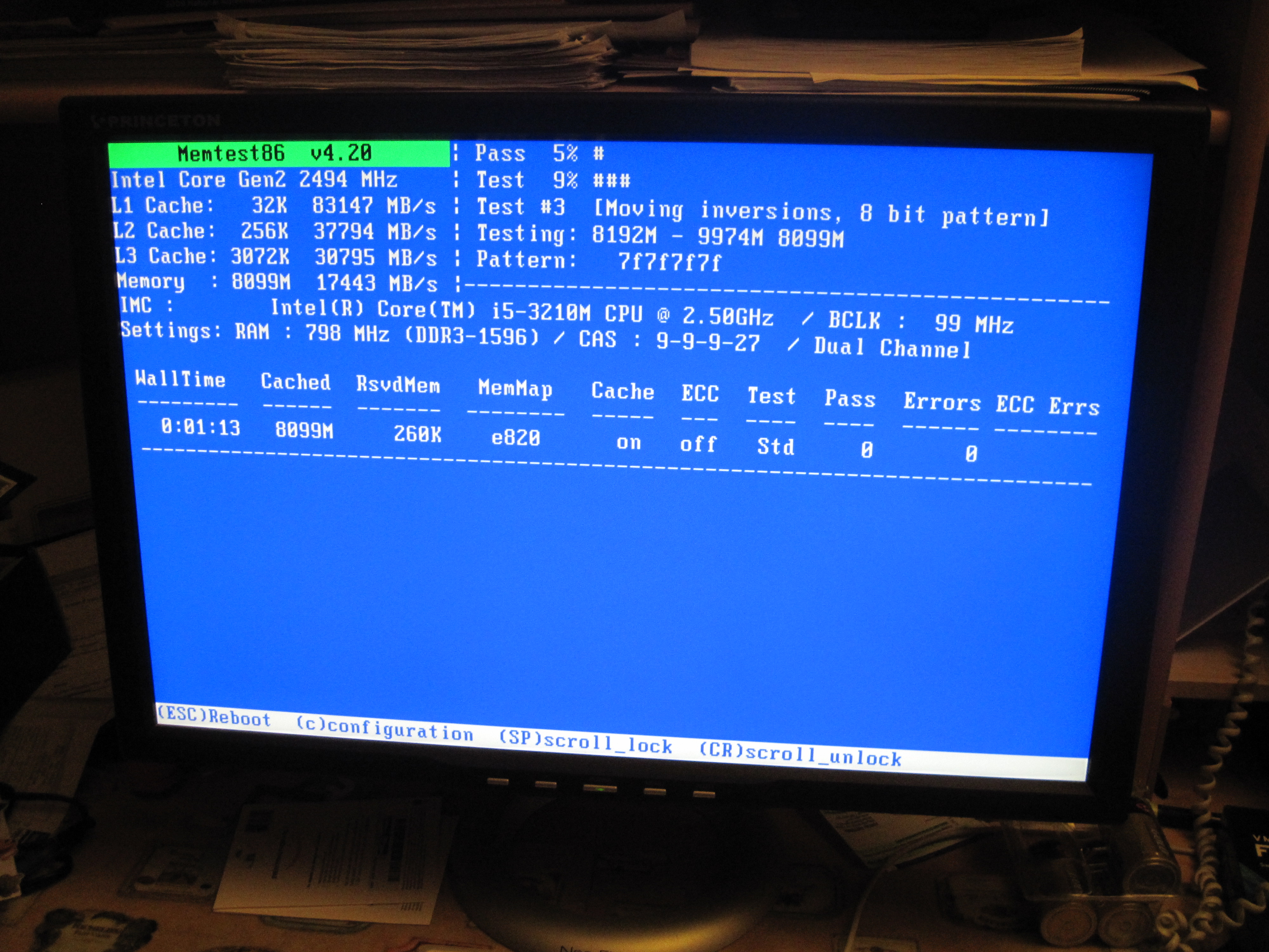

Last night I ran a test on a pair of 4gb kingston plug n play 1600mhz. these were in my base 2012 mini
better timings take a look. 9-9-9-27 the 16gb time at 11-11-11-28
so even thought these are only 8gb they should run faster the 16gb in
bootcamp as long as you use under 8gb for the program you are running
Great findings!
Now we have documentation that the Kingston RAMs with better timings at least can run them with the better CAS Latency when booting Memtest and/or BootCamp.
We still cannot be entirely sure that the EFI settings and timings will be identical when booting into OS X, and so far I've not seen any way to display them from within OS X. I will however go by the assumption that they indeed are running at the same speeds reported by Memtest, on the basis that it would be stupid to run the RAM modules at a lower speed. :)
For my sake, I will primarily be running OS X, with a potential BootCamp in a distant future.
Do you happen to have any other 8GB (2x4GB) set of memory with "worse" timings? Would be interesting to see how the good timings of the Kingston compares by doing som benchmarks from within OS X...

Great findings!

no i have the 1600 kingston plug n play in 4g sticks. i have the kingston 8gb sticks for mac. i had the crucial 8gb sticks for mac. the results above are all I can test except the stock 2gb sticks which don't help much since a pair of 2gb sticks are just too small for most users. kingston sells high end 8gb plug n play sticks that should test with the better timings but they are 129 usd for a pair. I don't want to pay that much. since i personally do not need the small speed boost they will offer over the 8gb sticks I got for 69 usd a pair.
squeezing that last bit of speed from ram sticks does not do a lot for my use of minis.

Yes, and no, I think you misunderstood me. :)
Your Kingstons are still faster, by having lower latency/better timings, than the 16GB kit available from Apple, or the standard Crucial kit which I get a feeling the majority of people get...
I haven't even heard anyone report that running the lower latency Kingstons could net them better performance, or that they've verified that it actually runs at those lower timings.

It is done! :)
Just wrote my initial test report for the 1866MHz Vengeance at https://forums.macrumors.com/threads/1528139/
Extended Memtest86+ runs showed issues with the RAM though, so I'm gonna try to exchange it. Maybe I'll even switch over to Kingstons CL9 1600MHz. Then we could have a comparison, even though the difference in timings between the Kingstons and the Vengeance (when running at 1600MHz) was minimal; 9-9-9-27 (as per your report) vs. 9-10-9-26...

A good recommendation to you, it is always a good idea to let new memory run over night using either Memtest86 or Memtest86+. I would recommend you to do the same.
If you have a Bootcamp partition or know anyone with a Windows machine, there is a easy tool to create a bootable USB drive for you at http://memtest.org/
When I used the 1866MHz Vengeance, I successfully completed all of the tests, and had no visible or otherwise detectable issues from within OS X. Running Memtest86+ over night did bring these issues to my attention however.
Running Memtest86 won't really guarantee that your RAM modules are okay, that is impossible, but it will be able to show you that they are at least not showing signs of failure over the period you run them (hence, the longer the better).
It might been possible to detect it with Apple Hardware Test in extended mode for a similar amount of time, but my weapon of choice is Memtest86+ due to the good information it provides.
