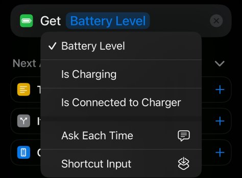

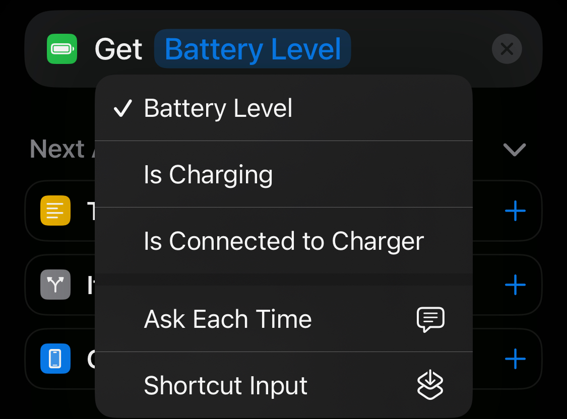

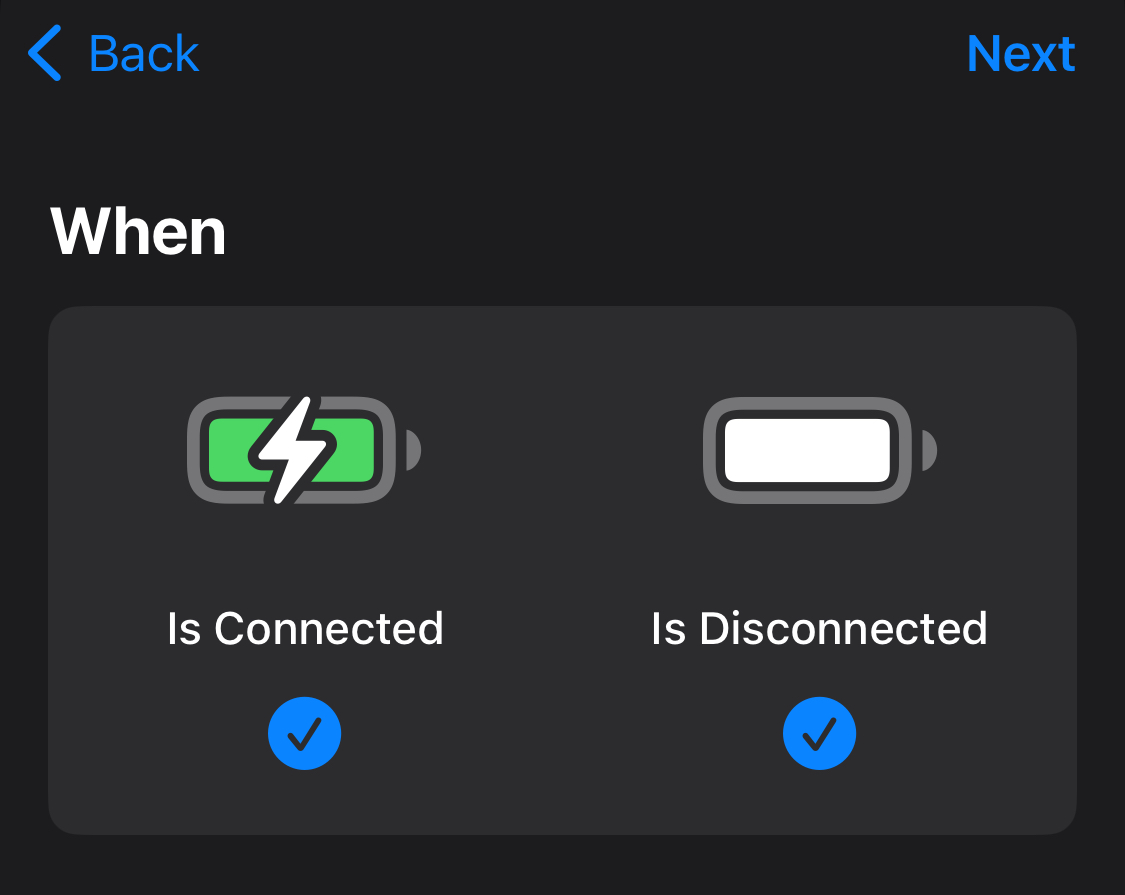

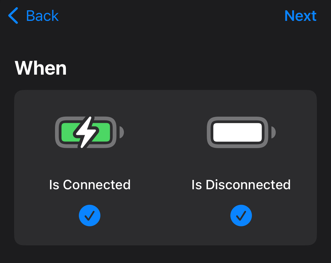

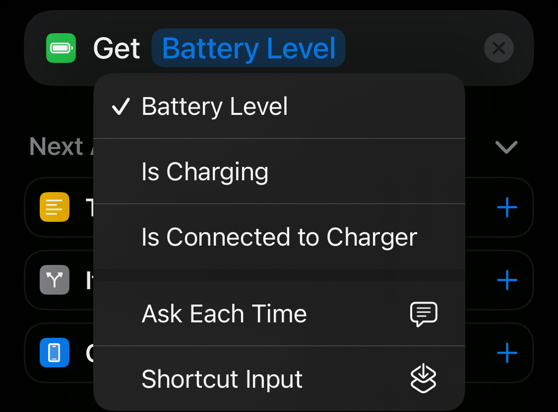

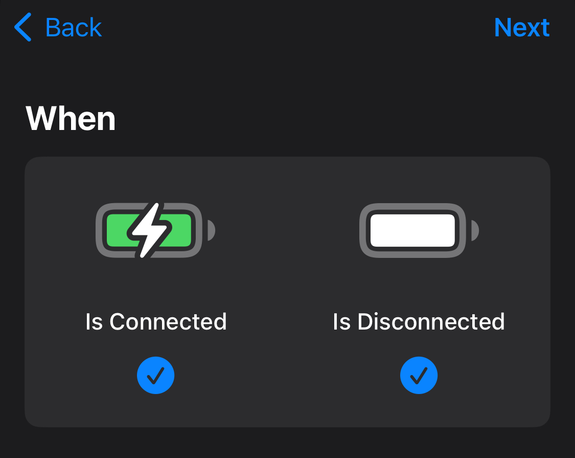

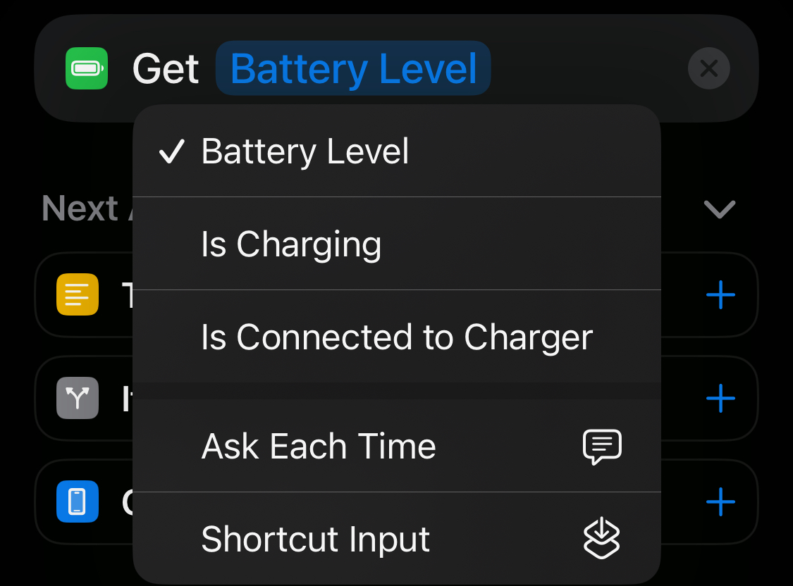

Can have one Automation as can have both connect and disconnect options selected.
But otherwise, as mentioned, the Get Battery Status Action is the way to go to determine status.
Oh I missed that both could be selected at the same time. Thanks for the information 😀
Thank you both for the suggestion. I knew about both the connect and disconnect options selected. I did not know the "Is Connected to Charger" option. I now have one automation paired with one shortcut.
