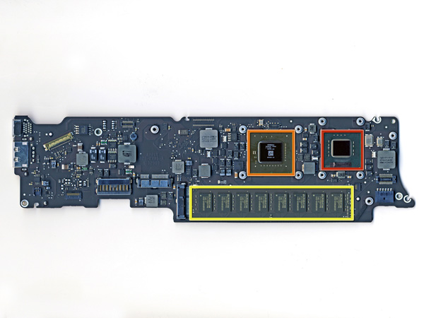

The current MBA Logic board looks like this:
(It's tiny).
There's no room for a CoreiX + Discrete GPU as others have stated, and Intel won't let Nvidia make chipsets (like the 320M) for the CoreiX processors.

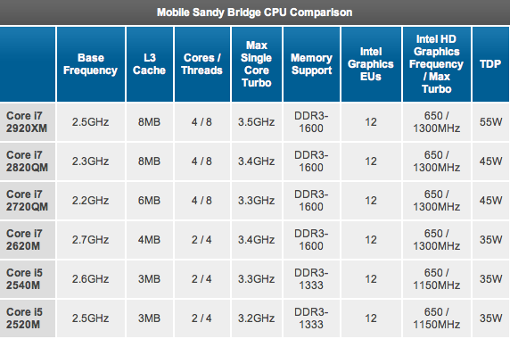

Regardless, here's Anandtech's chart of the upcoming Sandy Bridge Mobile Parts - so we know what's going to be readily available in January after Intel announces it:
attachment.php

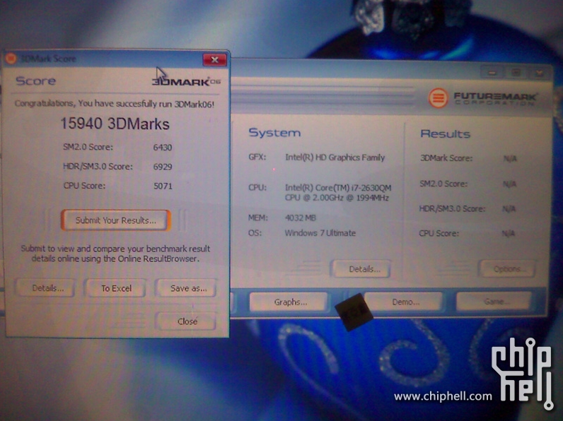

In other news today: Engadget reports that someone got their hands on an Unreleased Alienware Laptop with a Sandy Bridge chip in it (the i7-2630QM) and the integrated graphics chip scored a 15,940 on 3DMark06.
If this isn't a Hoax, and it doesn't seem like it is... and if the graphics chip in the i7-2630QM is clocked the same as the graphics chip in the i7/i5 destined for the MBP's... than the intergrated graphics chips of SB are AMAZING (and definitely *this* amazing when paired with an i7 CPU.

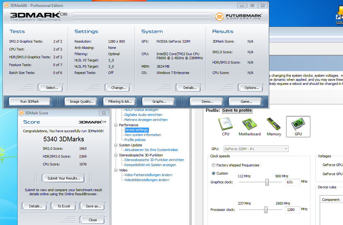

To put it in comparison... 3dMark06 scores for other Apple GPUs (links go to reference sites):
GMA950 --> 91
9400m --> 2,207
320M --> 5340
330M --> 6,746
That compares to a SB Integrated Chip score of 15,000! Wow. This seems much too good to be true...?
Look at these screenshots:
A 320M paired with a Core2Duo 2.4Ghz: 5340

A Sandy Bridge with IGP and an i7-2630QM: 15,940!

See the SB mobility chip table above in this thread. i5s should feature the same 650MHz clock speed for the IGP but i7s will have 150MHz better Turbo. So sounds pretty capable. Of course LM and UM chips will likely come with slower clock speeds due to heat
