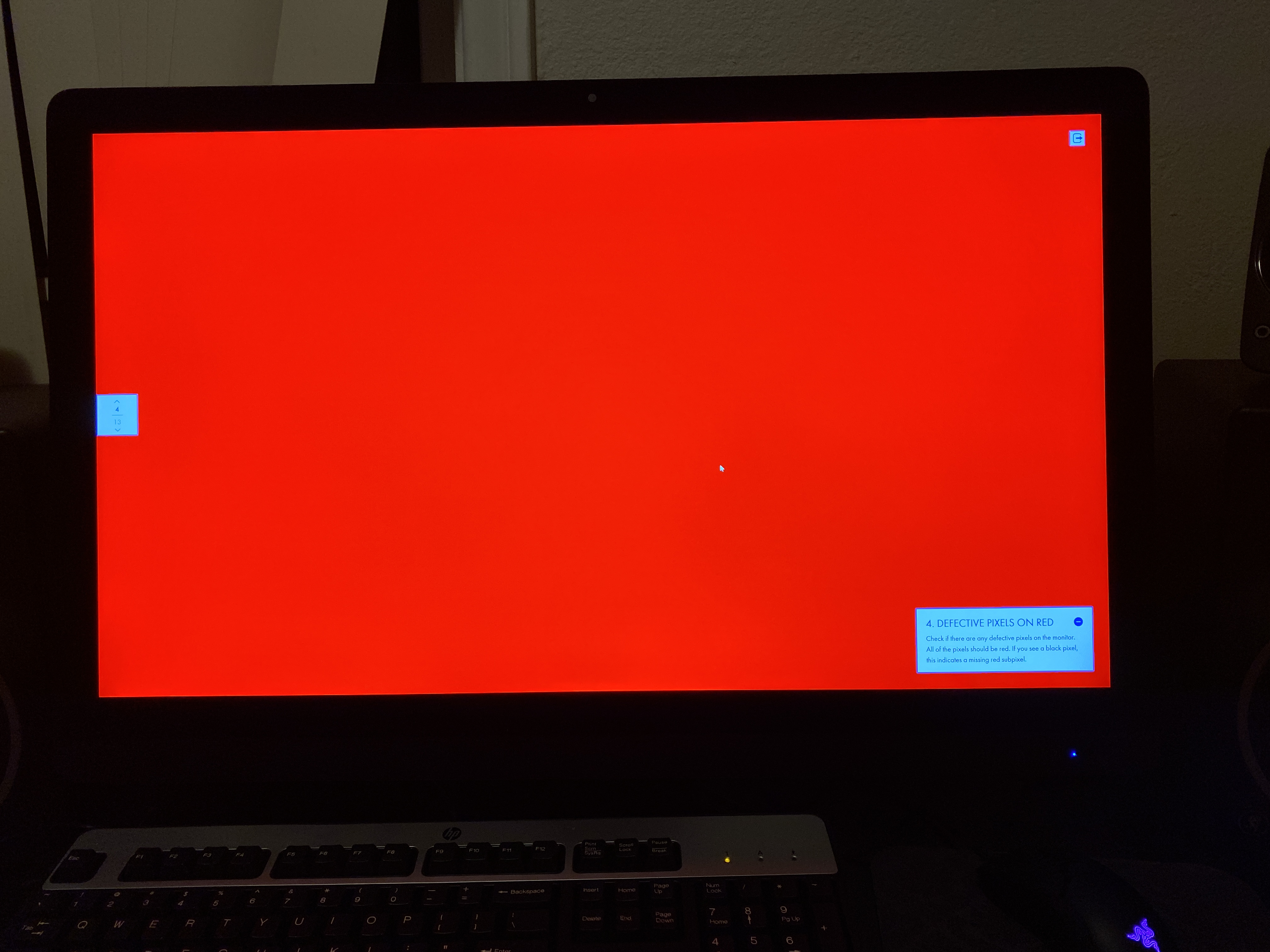

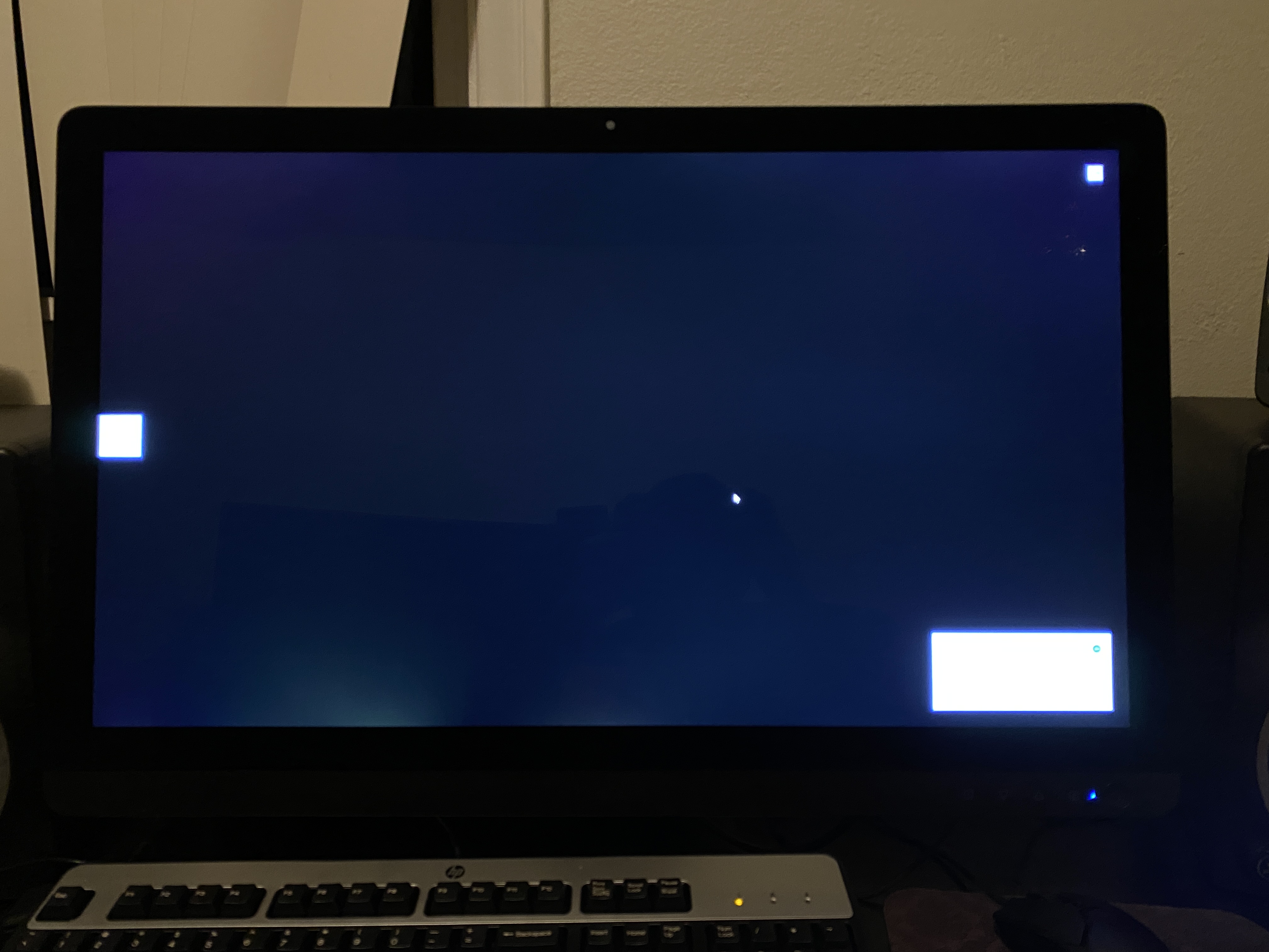

I do notice the light bleed at the top of the monitor, but I don't see it with bright colors. I do see green pixels when I have a black background. I see about 6 of them. I think those are the biggest issues I've encountered so far.

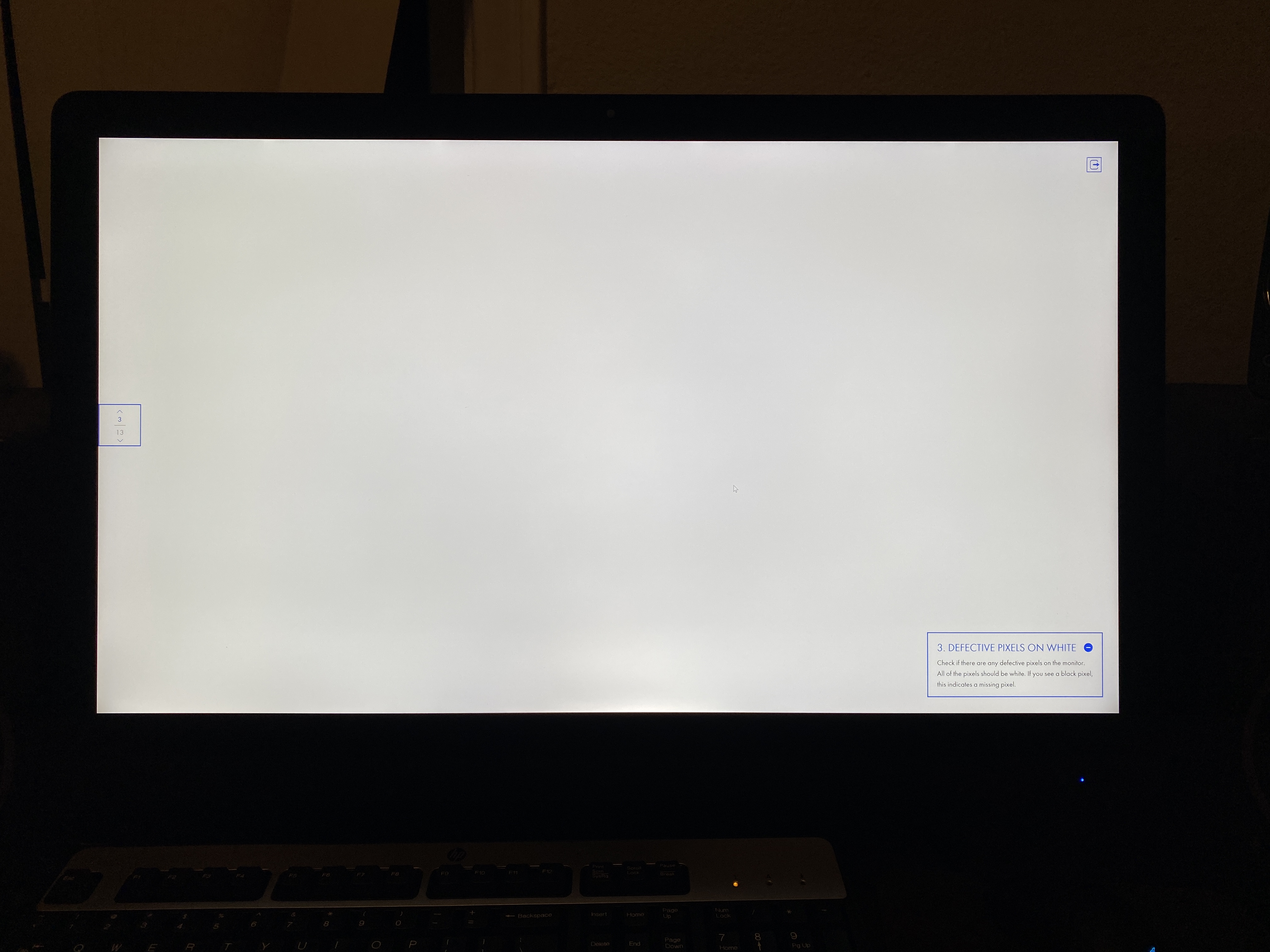

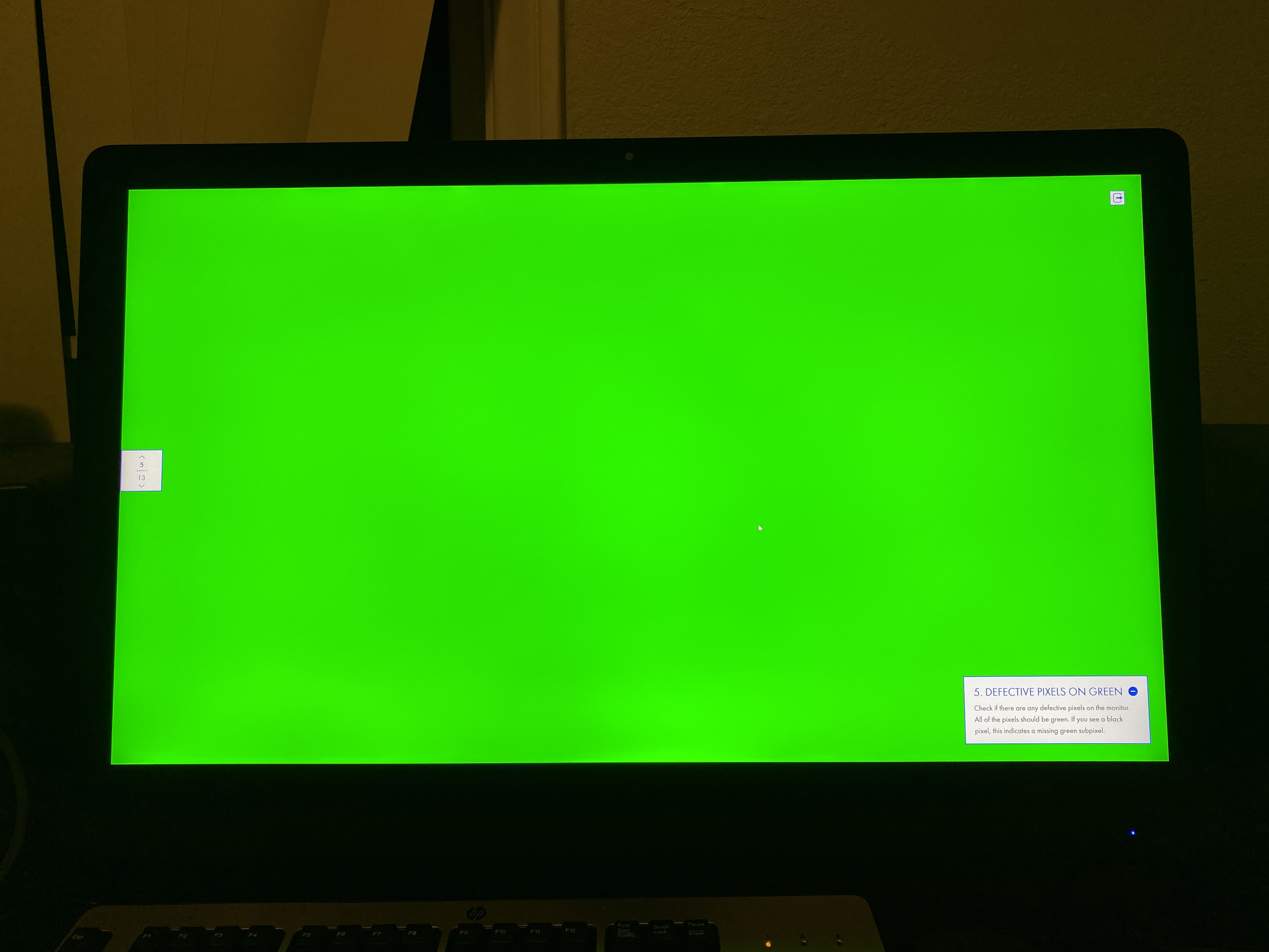

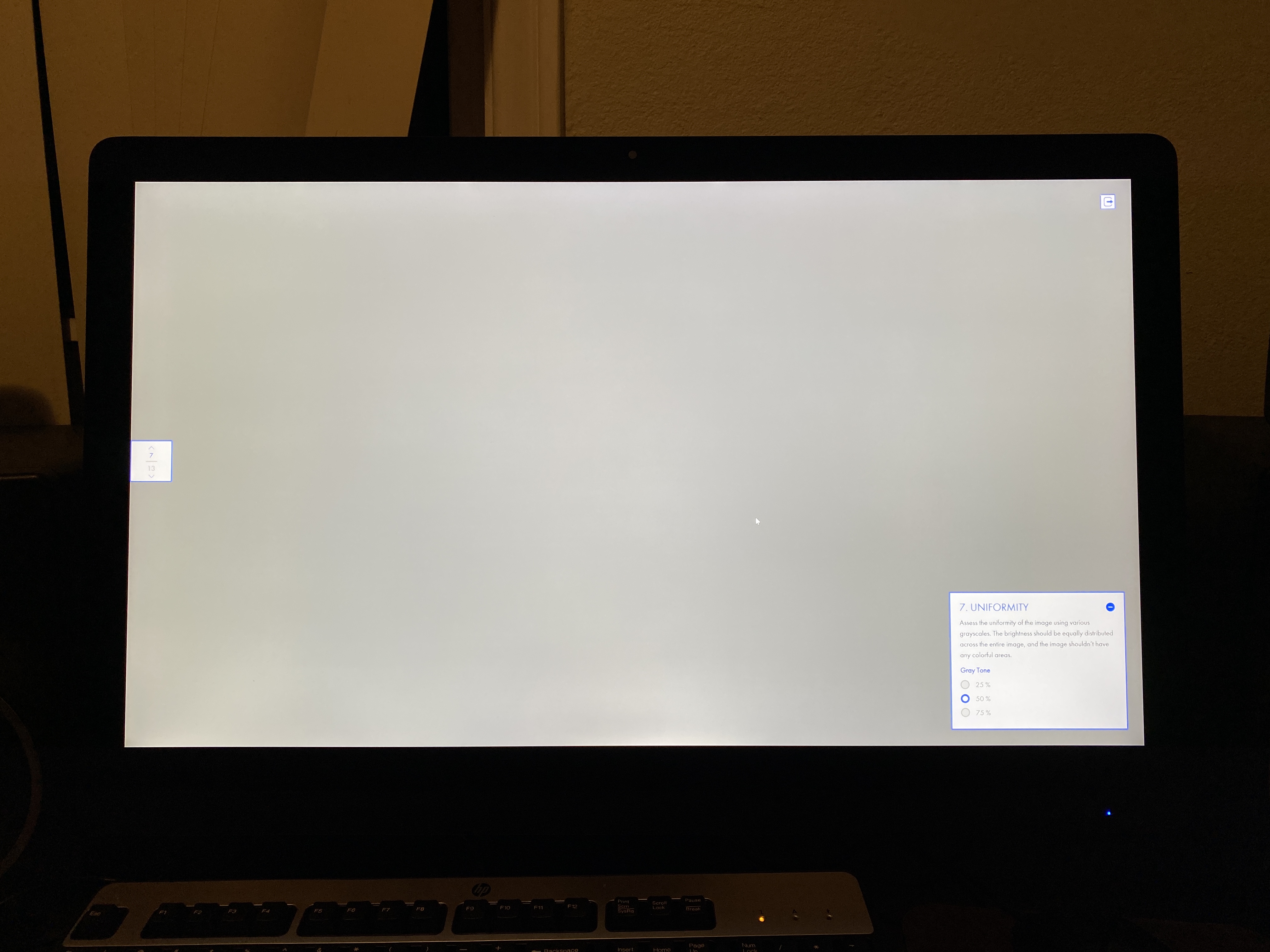

Would you be so kind as to take some photos of your monitor on a totally blank white screen?
Here's the one I just sent back
(see the splotching in the middle? was driving me insane when scrolling on websites)
It's really apparent on white/grays and the green background
I also had many stuck pixels/clusters - seemed to be well over a hundred (I stopped counting at some point)
Oh yeah! I see it. :/
Well they shipped the monitor, and told me to ship my current monitor once the replacement arrives. I guess I'll try it first and decide which one to send back.
Here they are.
Reactions: turbineseaplane
I think I might have kept my last one if it looked closer to yours.
(maybe - not sure - that top left corner on your photos is concerning)
When you're on white websites - like this one - do you ever notice that backlight difference when scrolling?
That was my main issue. Don't get me wrong - I don't like all the stuck pixels (at all), but they were more tolerable for me since it required very very dark things on screen to see them.
But - panel/backlight issues that I was noticing against white/light backgrounds (like my images) were driving me insane basically always.

Yeah, the top left is that light leak or I don't know what it's called. THat's what I showed Planar.
I don't notice any backlight difference when scrolling. I think this display would be amazing if it didn't have those issues. Other than that I really don't see a difference from the iMac display. Do you have your eyes on a different monitor? This would be a hit!! I wish it had a webcam. haha.

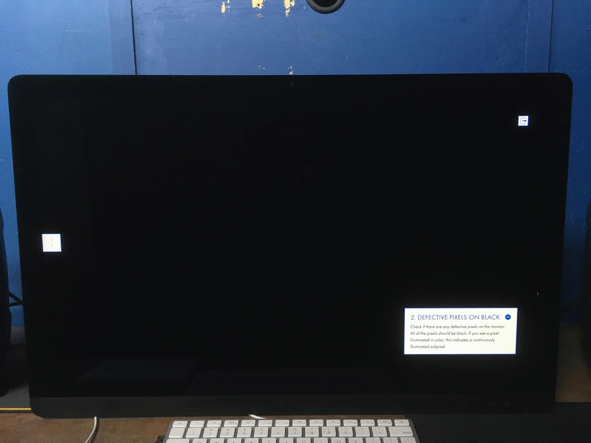

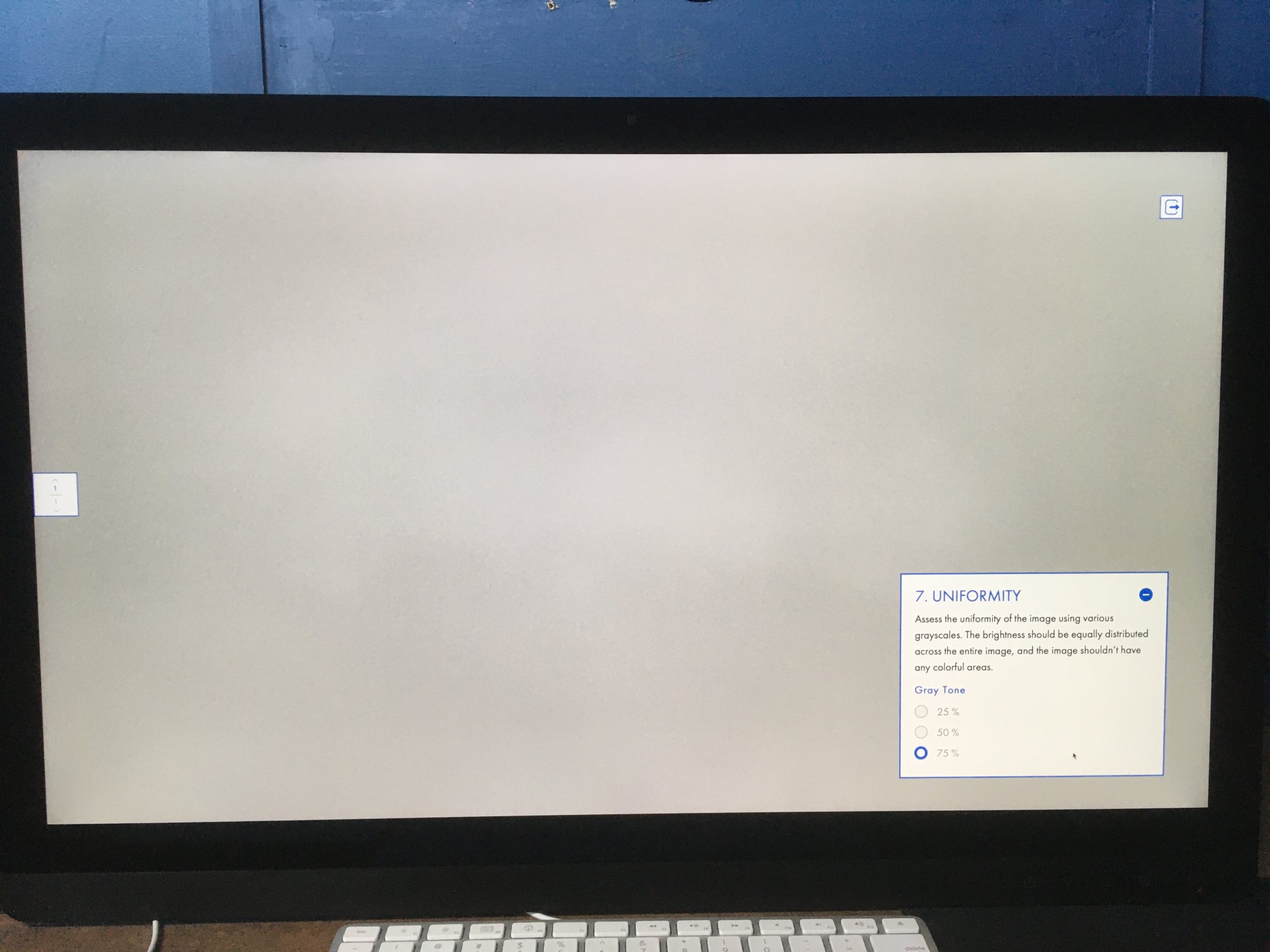

I think the last one has very good white uniformity. Overall, this is something that I had issues with on numerous LG UltraFines I’ve tested (N=5 to be precise, from different providers). Based on my experience, I don’t think these issues are exclusive to Planar.
Any stuck pixels on black background?
(look close haha)
[automerge]1590761364[/automerge]
The new display is not slanted
That's interesting..
I'm still amazed that the Planar quality control is so bad that it extends to the stand for the monitor.
I was going crazy when I noticed the first display was slanted. I was wondering if it was just me, but then you said it!
I did see stuck pixels. I think it had more than the first one. I'm not sure which one to send back. Based on the pictures which one do you think is best to keep?

My z27q arrived today
It has some physical issue with the panel (spots of almost dust or marks or something on the backside) in about 8 or 9 places.
It isn't dead pixels, but has the same effect basically.
Anyone know? Dust? Something else?
Pictures if curious

No "starfield" of stuck pixels or any weird backlight variations like the Planar's had.
The color looks really great.
Very balanced and really just beautiful.
It shows up as 10-bit and all that in Windows.
For me, it is nice to have it be not quite the full blown glossy of the iMac screen.
If it weren't for these black "things", this would be a total keeper.
The light bleed is more evident on the new screen, but everything else seems better on that one I think. I'm undecided.
