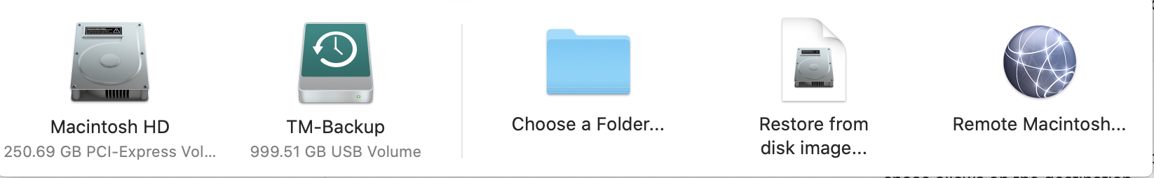

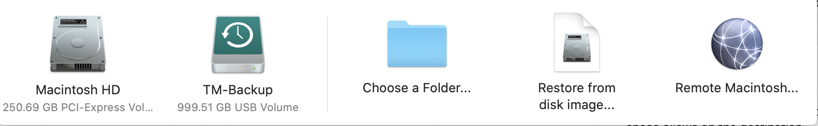

I'm not sure I follow you. In CCC you can pick a drive and it will clone all volumes on that drive if that is what you mean. But I see no way to clone two physical drives to one in CCC.
Here are your options when picking a source in CCC.

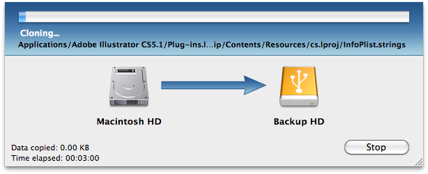

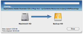

I'm trying Carbon Copy Cloner. I keep getting these large boxes popping up on my screen while it backs up.
Is there a way not to see these?

First, when you say "In CCC you can pick a drive and it will clone all volumes on that drive", does that mean all volumes of that drive/device would be backed up at the same time? SuperDuper! cannot do that, as far as I can tell (unless it is possible to develop a script to do that, which I have never done). In other words, if I have a device (typically an external SSD) that has 3 Volumes on it (A, B, and C), SuperDuper! can back up each of those Volumes one at a time, not simultaneously. Does CCC behave the same way?
I guess my understanding is that the op wants to do the 2 backups separately, ie, backup each volume separately, and thus that is what I based my post on. It looks like (as expected) CCC can do that also.
But as for backing up/cloning both physical devices at the same time, no matter how many volumes are on each device, SuperDuper! cannot do that.
I just did some testing and I was mistaken. CCC only does one volume at a a time.

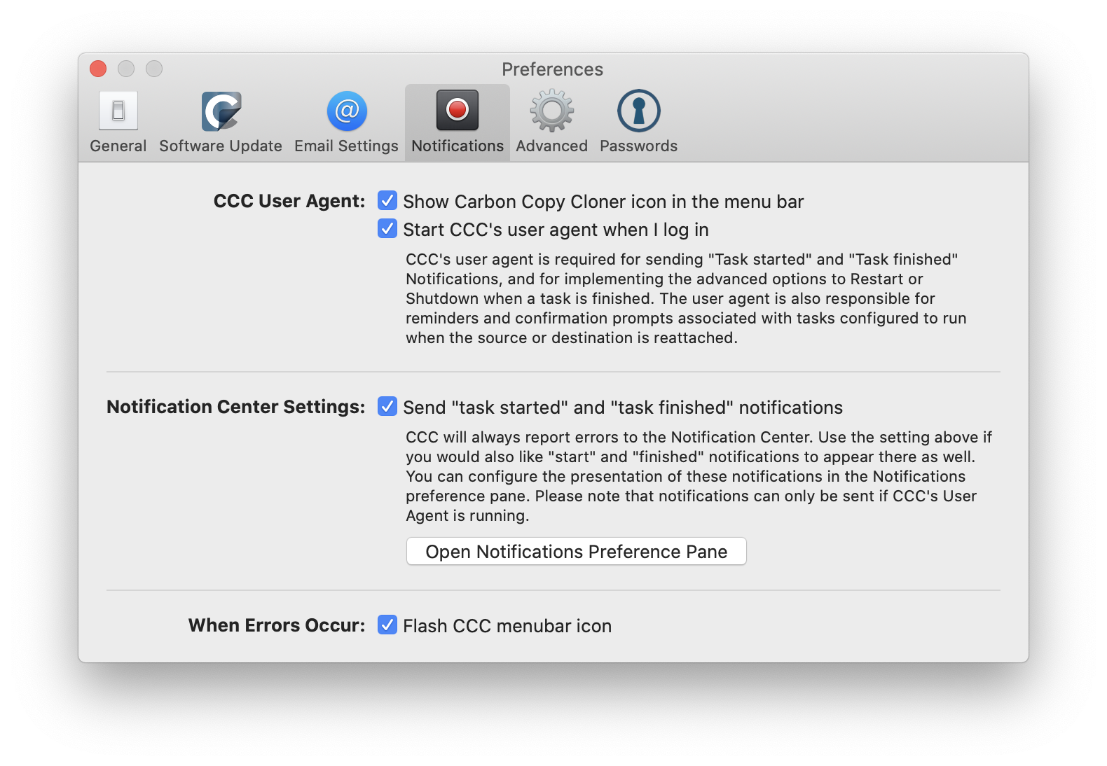

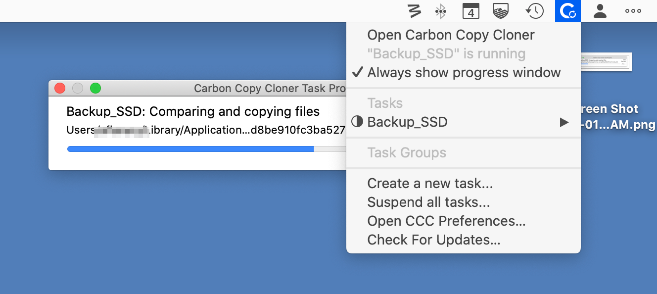

CCC has a background mini app you can enable. Set you backup to run automatically when the external drive is attached and you don't need the main CCC app running at all. It will show the progress bar you see in my screenshot. From the helper app menu bar you can uncheck to not display that progress bar at all.
I don't have the icon in the helper app menu bar so I can't seem to turn off the progress window.
