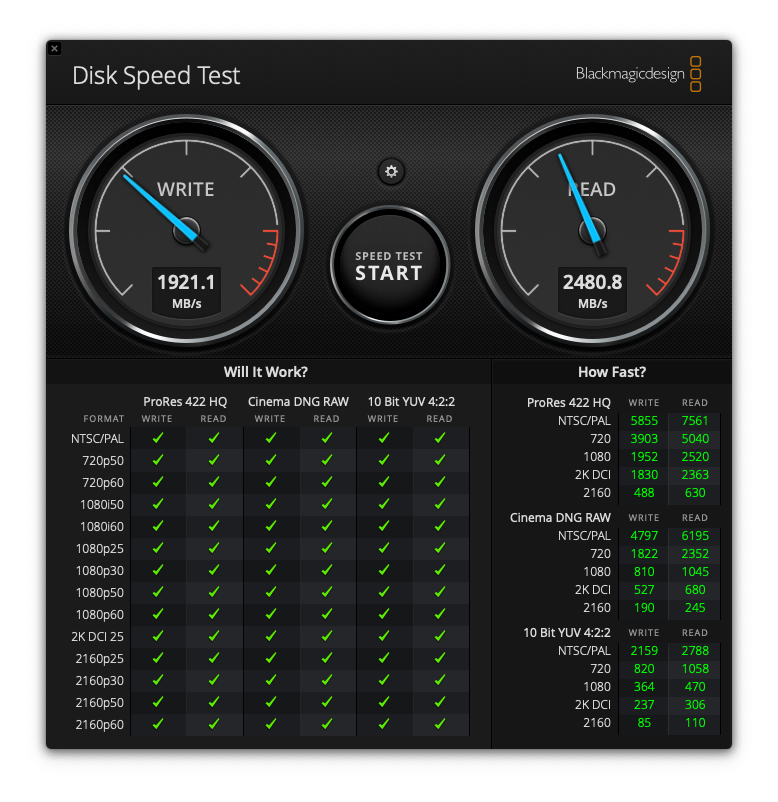

i am using an M2 board with an external cover that is great speeds for my Logic Plug-in. Saprient 2TB is the ssd
