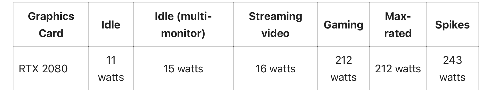

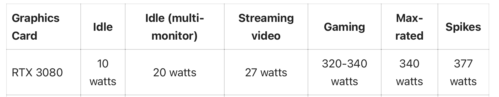

You can address that. From ecoenergygeek.com:
Suppose you do one GPU-intensive and GPU-limited task/day that takes 3 hours on the 2080 = 3 h x 212 W = 636 Wh; Plus 5 hours doing other tasks that don't significantly tax the GPU = 5 h x 16 W = 80 Wh. This gives a total of 716 Wh/day for the 2080.
FP32 TFLOPS for the 2080 and 3080 are 13 .45 and 34.1 respectively. Using this as a general measure of GPU compute, the 3080 should finish that 3 hr task in 3 h x 13.45/34.1 = 1.2 h.
This gives 1.2 h @ 340 W + 6.8 h @27 W = 590 W h/day for the 3080.
Yes, this doesn't account for CPU use, or the possibility that that your run time won't be as much different as shown above once one accounts for the CPU, but that can be built-in as well.
The bottom line is that if you actually do work that can make use of a more powerful but more efficient GPU, and you actually do make use of it, you can have a net energy saving.
And if the more powerful GPU was truly more energy efficient, including consuming less at idle (i.e., unlike the example above), then you would *always* save energy.

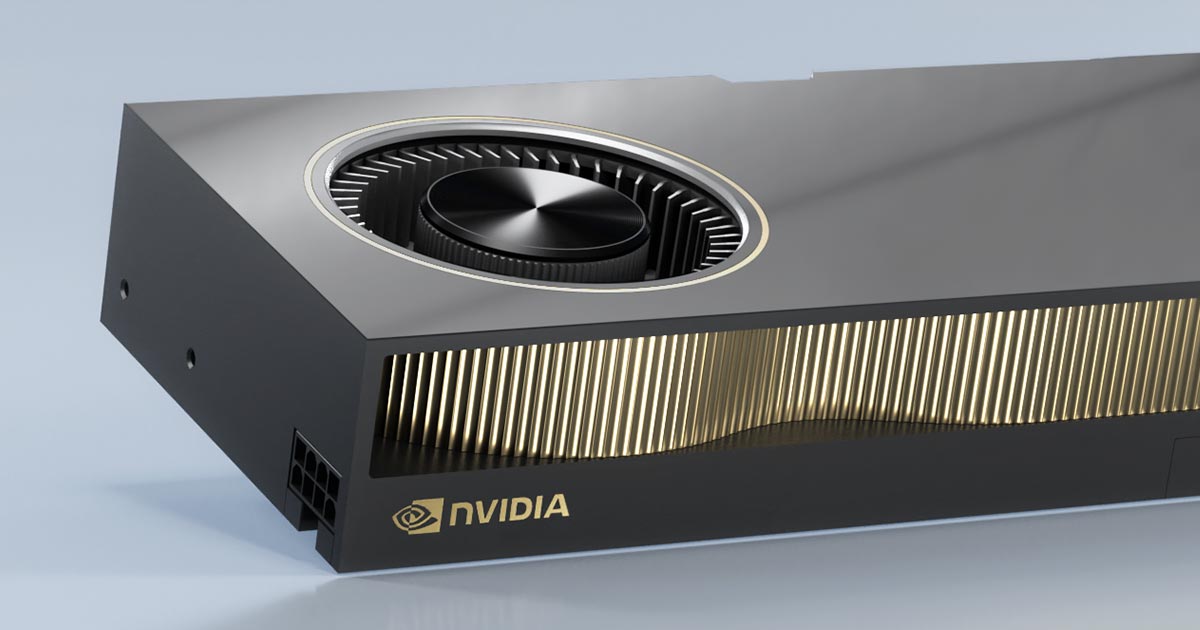

You should compare the Mac Studio GPU with the Nvidia RTX A6000 not with the RTX 3090. The Nvidia RTX A6000 is a more efficient version of the RTX 3090.
Feel free to do that and let us know what numbers you find--after all, it was your suggestion.

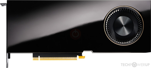

The RTX A6000 has the chip as the RTX 3090 Ti.
- RTX A6000 has 38.7 TFlops and consumes 300W
- RTX 3090 Ti has 40.0 TFlops and consumes 450W
And the 3090 Ti is ~$1200 vs the a6000 at ~$4600. Kinda ruins the PC-NVIDIA value proposition.
