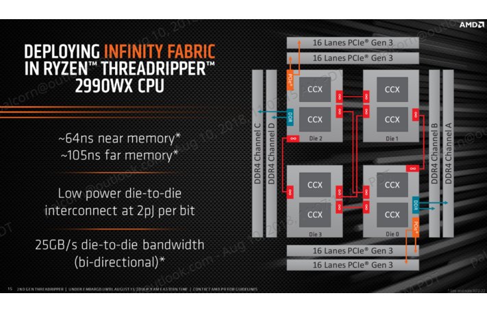

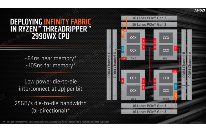

NUMA latency has nothing to do with gaming - it refers to latency in the memory system. (NUMA == Non Uniform Memory Access)
"Non Uniform" means that some RAM memory is fast, other RAM memory is slow. (The terms "near" and "far" also show up.) Depending on the difference between "fast" and "slow", it can be a big deal. (Actually, you get "fast" and "slow" with two NUMA nodes - with more than two nodes you can have intermediate cases.)
A simple case is a Xeon dual-socket system. Both sockets have memory controllers, so typically half the DIMM slots are connected to one socket and the other half to the other socket.
If one Xeon CPU needs RAM data that's on DIMMs connected to the other CPU, the data is fetched by the memory controller on the other CPU and transferred (via QPI or UPI) to the requesting CPU. This introduces latency over accessing memory local to the CPU's memory controller.
AMD's multi-die implementations make even single socket systems NUMA.
https://www.tomshardware.com/reviews/amd-ryzen-threadripper-2-2990wx-2950x,5725-2.html
Threadripper 2990WX borrows from AMD's EPYC server designs and comes with four active dies. The company fused off PCIe and memory control from two of the dies, creating silicon only useful for computing. Meanwhile, the other two I/O-enabled dies serve up two channels of DDR4 memory support and 32 lanes of PCIe 3.0 each.
Unfortunately, the compute dies suffer from increased latency on every request to main memory and PCIe-attached devices, as those requests always have to traverse the Infinity Fabric.
AMD added more Infinity Fabric channels to connect two more dies. Unfortunately, that has a tremendous impact on fabric bandwidth, which drops from 50 Gb/s on a 16-core Threadripper 2950X to 25 Gb/s in this implementation. And again, AMD measured performance with a 3200 MT/s data rate, meaning throughput at DDR4-2933 will be lower. Even with the benefits of tightly-controlled fabric scheduling magic, the combination of reduced bandwidth and 32 threads that must communicate over the fabric for I/O and memory requests has an impact on performance.
Since the title of this thread is "Why Apple don't use AMD Ryzen/Threadripper CPU?" - perhaps this graphic explains the reason.

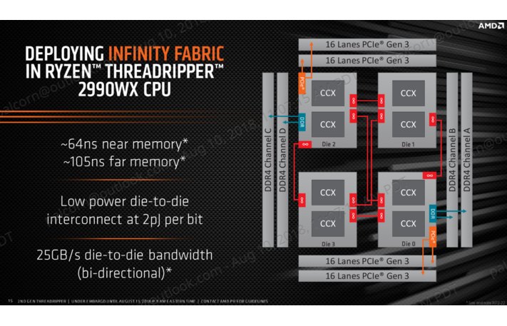

Is what Aiden posted wrong? NUMA vs UMA is an issue.
Ryzen only uses a 1/2 CCX so it is UMA. Threadripper has 4/8 CCX’s so it is NUMA. First gen Threadripper allows you to disable half the cores to improve latency and performance, not sure if Zen+ includes this mode still. I haven’t looked at the latest version of Ryzen Master as it kept crashing Windows so I uninstalled it.

If the CPU has "chiplets" and Infinity Fabric - how can it not be NUMA?

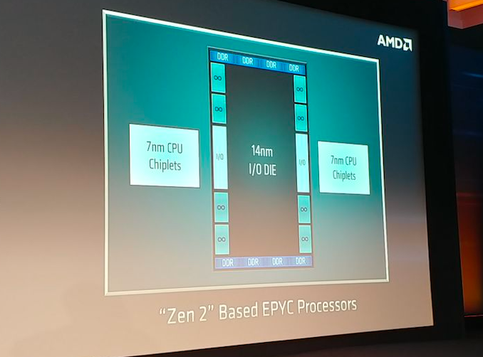

Technically, you can make all access "far" for every one of the chiplets; then it is uniformly slower. :)
For a subset of the problem this is the path that AMD took.
https://www.anandtech.com/show/1356...n-approach-7nm-zen-2-cores-meets-14-nm-io-die
All the memory is hung off the I/O chip in the middle. ( this is slightly drifting back to "front side bus" days of yesteryear ... and the same bandwidth problems.). The chiplets all come in through the 'infintiy' links (where the infinity markers on on the I/O chip in the middle. There is either a large crossbar switch or token ring to multiplex the access of all the cores to the DRAM segments of the I/O chip. Passing through that is probably uniform ( depending on the internals of the I/O chip. If the I/O chip has a "top' and 'bottom' half then may be some non uniformity there. )
What that image doesn't really cover though is is cache swaps. If the latest data is in the L1/L2/L3 cache of chiplet A and chiplet B now needs to get it then the swap will have to traverse the I/O chip to get it. if the data is in a L2 cache of another core in the same chiplet then it will be a 'local' transfer. Hence, still have NUMA if looking at the whole memory stack instead of just the RAM DIMMs.
Finally, there is a presumption here that inside the AMD chiplet access to the Infinity link to the I/O chip is uniform. Pretty good chance that it isn't uniformly a "1 hop" jump to the I/O chip from every single core. So still have NUMA.

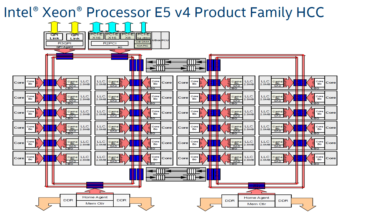

Xeon E5 had NUMA with just a single CPU package. NUMA isn't necessarily precipitated by sockets.
https://www.anandtech.com/show/10158/the-intel-xeon-e5-v4-review/2
The 12 cores on the left have even access to the two DDR channel/memory controllers on that are also on the left (all sharing the same token ring network). However, to get to the other two it is a non-uniform hop to the other token ring and the other two memory channels.

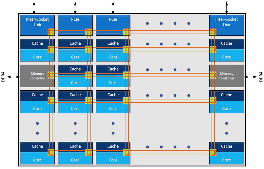

The SP ( and Xeon W and Core i9 ) has a mesh instead of a token ring with even larger non uniformity.....
https://www.anandtech.com/show/1155...-core-i9-7900x-i7-7820x-and-i7-7800x-tested/5
So there the core in the lower right has to jump through multiple of those yellow links to get to the memory controller on the left versus the other three cores on adjacent to the memory controller on the left.
The upside of the mesh is that if get to a point where only 1-3 cores are active then shrink down to a subset that are not the farthest away from any one memory controller (e.g., the far , four corners). Still is NUMA, but control the scope and impact.

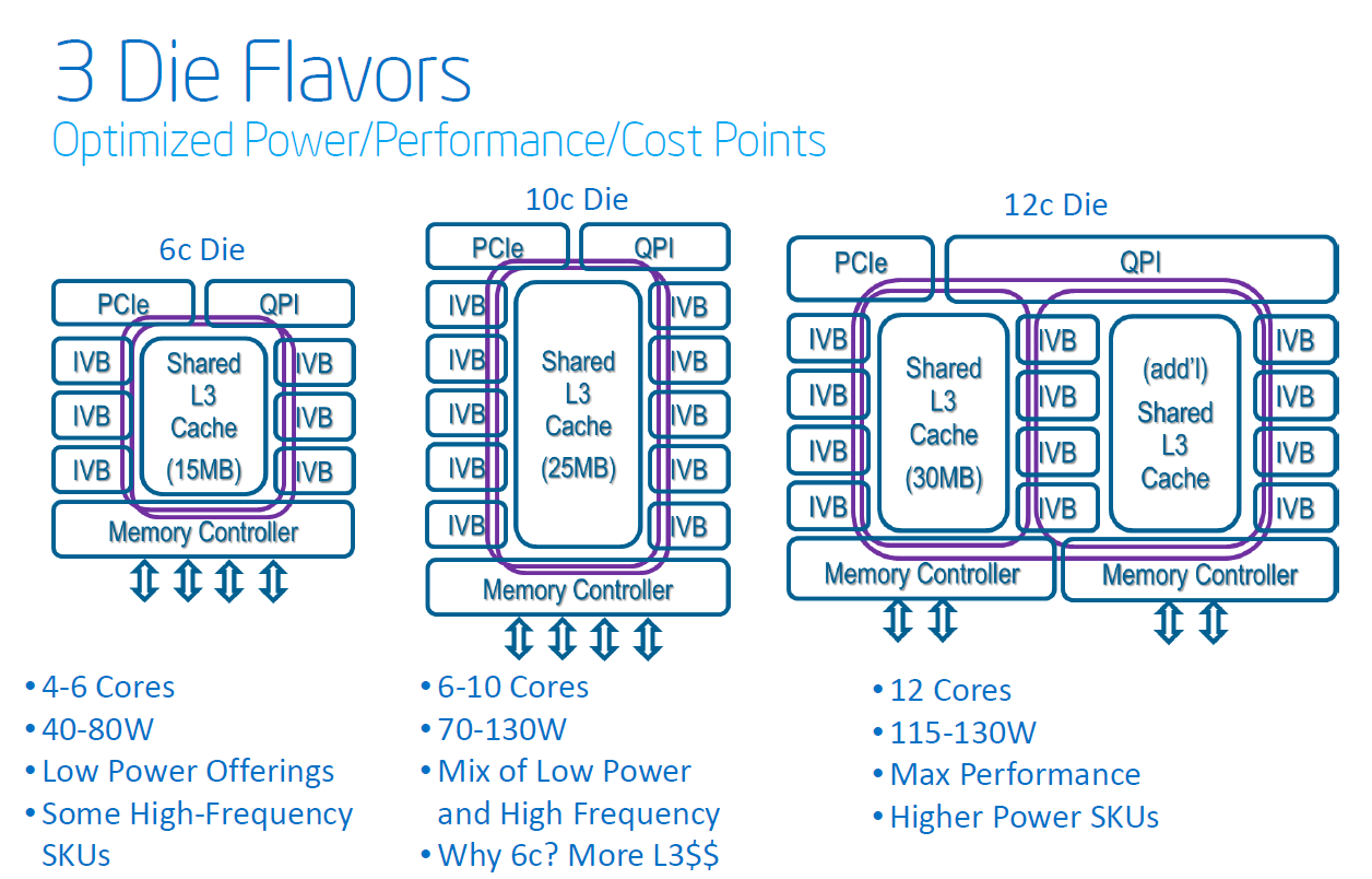

NUMA just about sockets. The 12 core Xeon E5 v2 has NUMA.
https://www.anandtech.com/show/7852/intel-xeon-e52697-v2-and-xeon-e52687w-v2-review-12-and-8-cores
Depending upon how much L3 synchronization traffic kicked up may not get uniform access to memory. The 12 core has token rings stretched a bit thinner than the lower core count variants. NUMA was still around in the MP 2013, but Apple could afford to mostly ignore it with a very limited impact.
