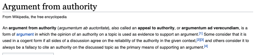

30 plus years in the semiconductor industry I think I have got it thank you.
Well, then please, by all means, explain the VLIW issue so that everyone here understands one of the two reasons why M1 is so fast using very little power.
