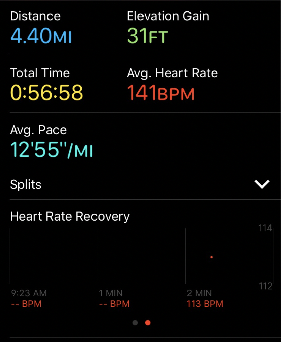

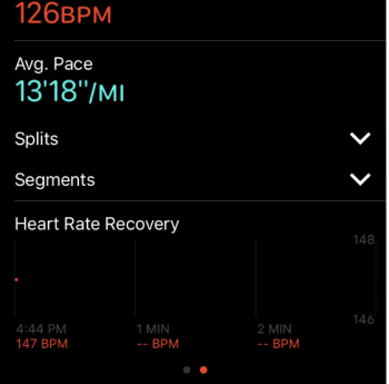

This has happened on multiple outdoor running workouts. I'll start the workout, run for 20 minutes, click "end" the second I stop running.
When I go to the 'recovery heart rate' chart, theres always a single red dot as if it took only 1 reading instead of many readings as my heart goes back go resting.
It's happened multiple times... am I doing something wrong? My girlfriend's recovery graph works great.

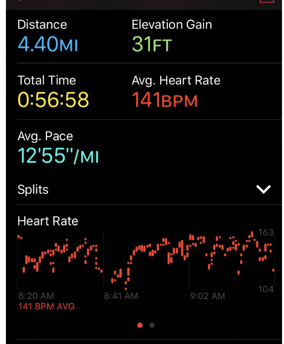

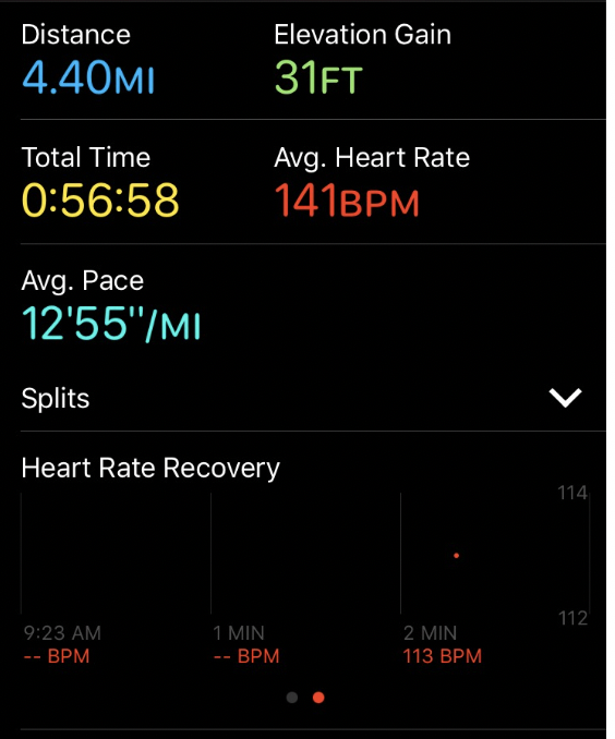

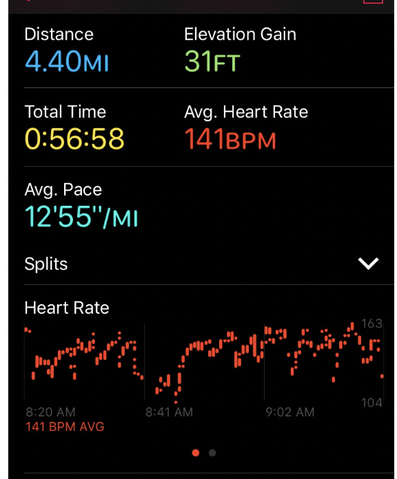

[doublepost=1507408903][/doublepost]Here's data for 2 separate runs (one heavy, one easy), you can see how the heart sensor works perfect and then it takes a crap during recovery...

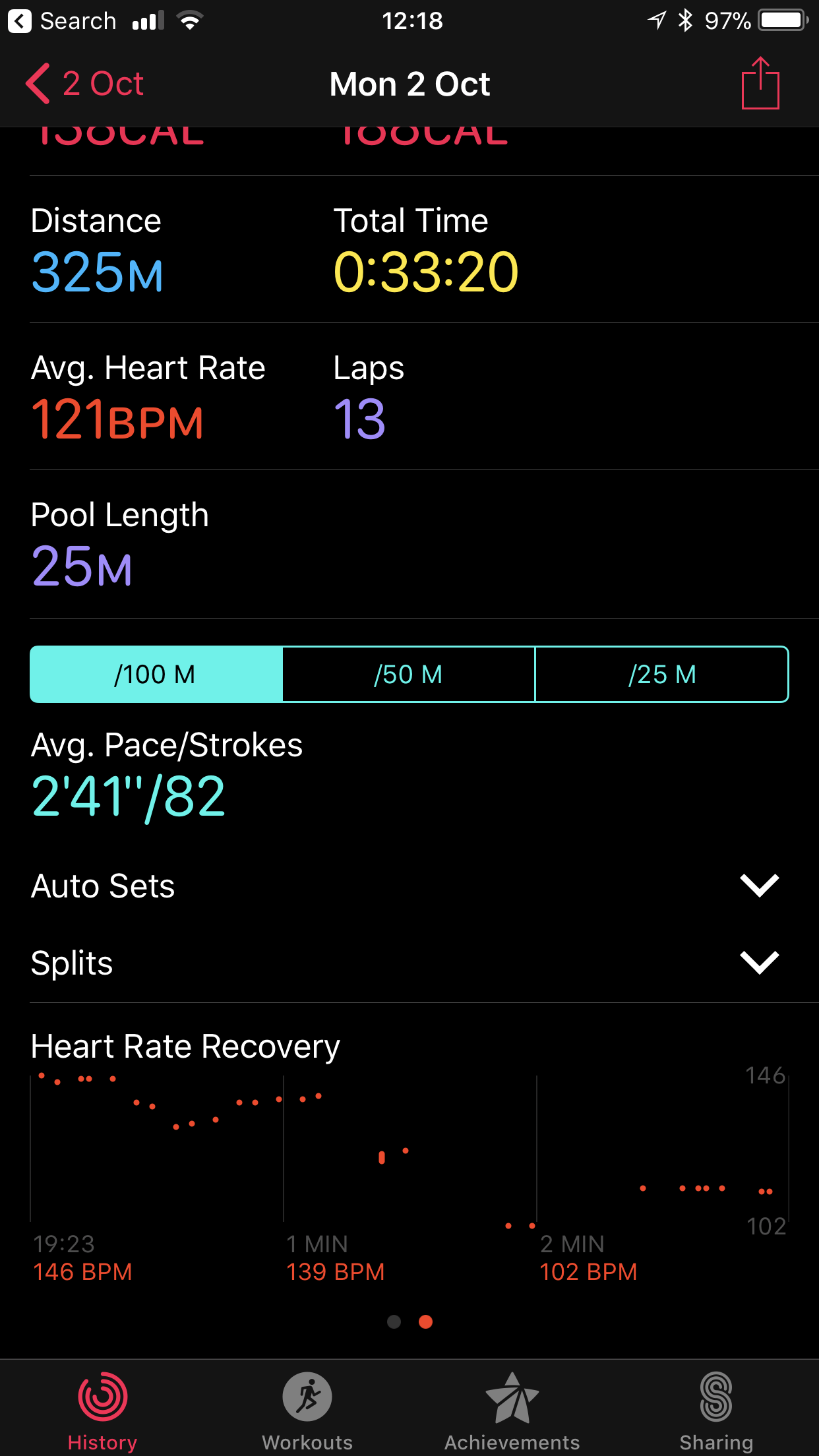

I think it's 2 mins max that will be recorded, but do you see lots of red dots on it, or do you just see a single dot?

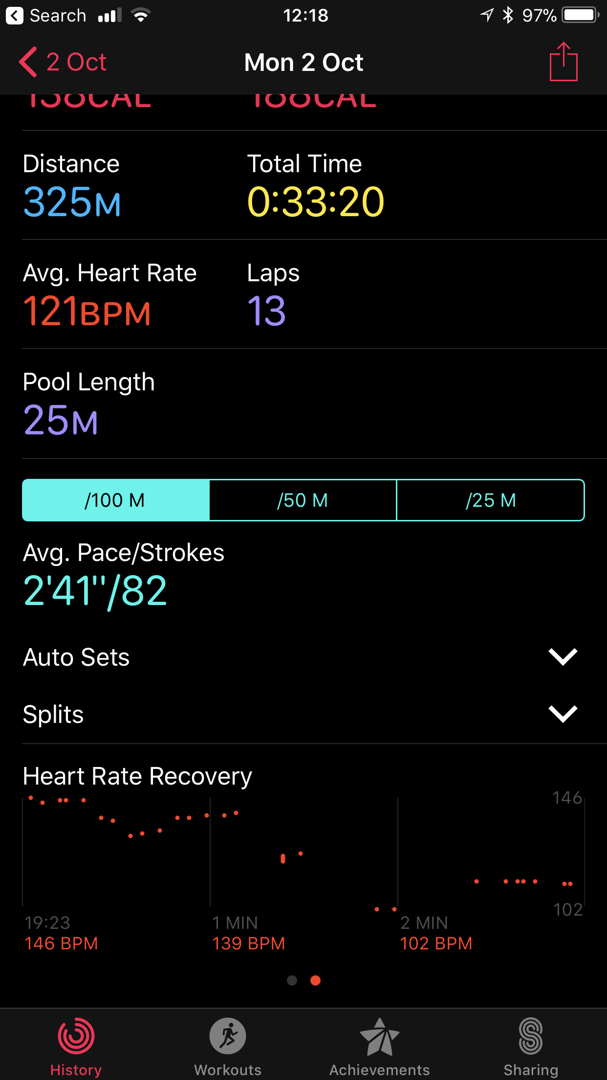

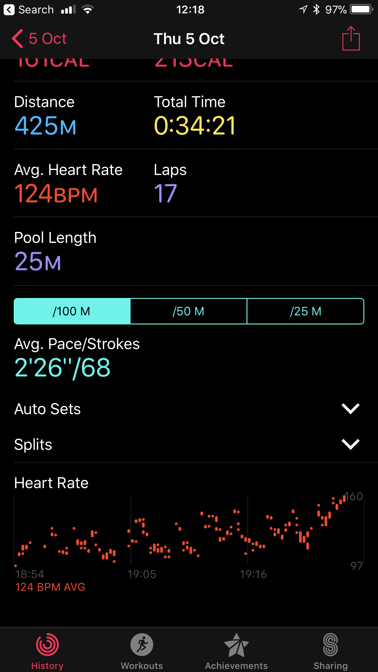

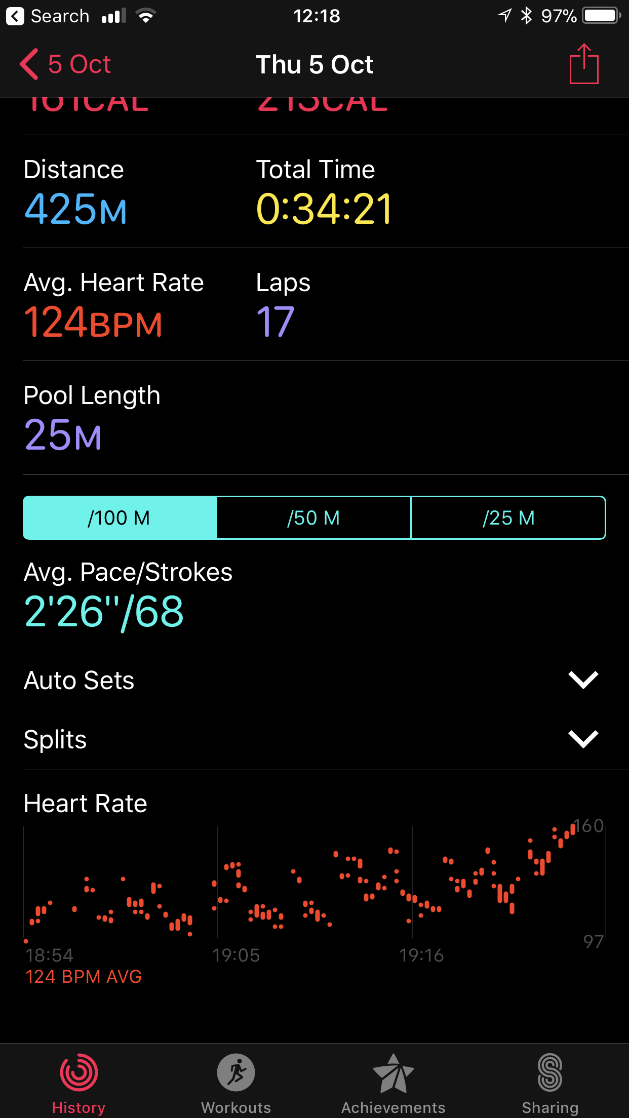

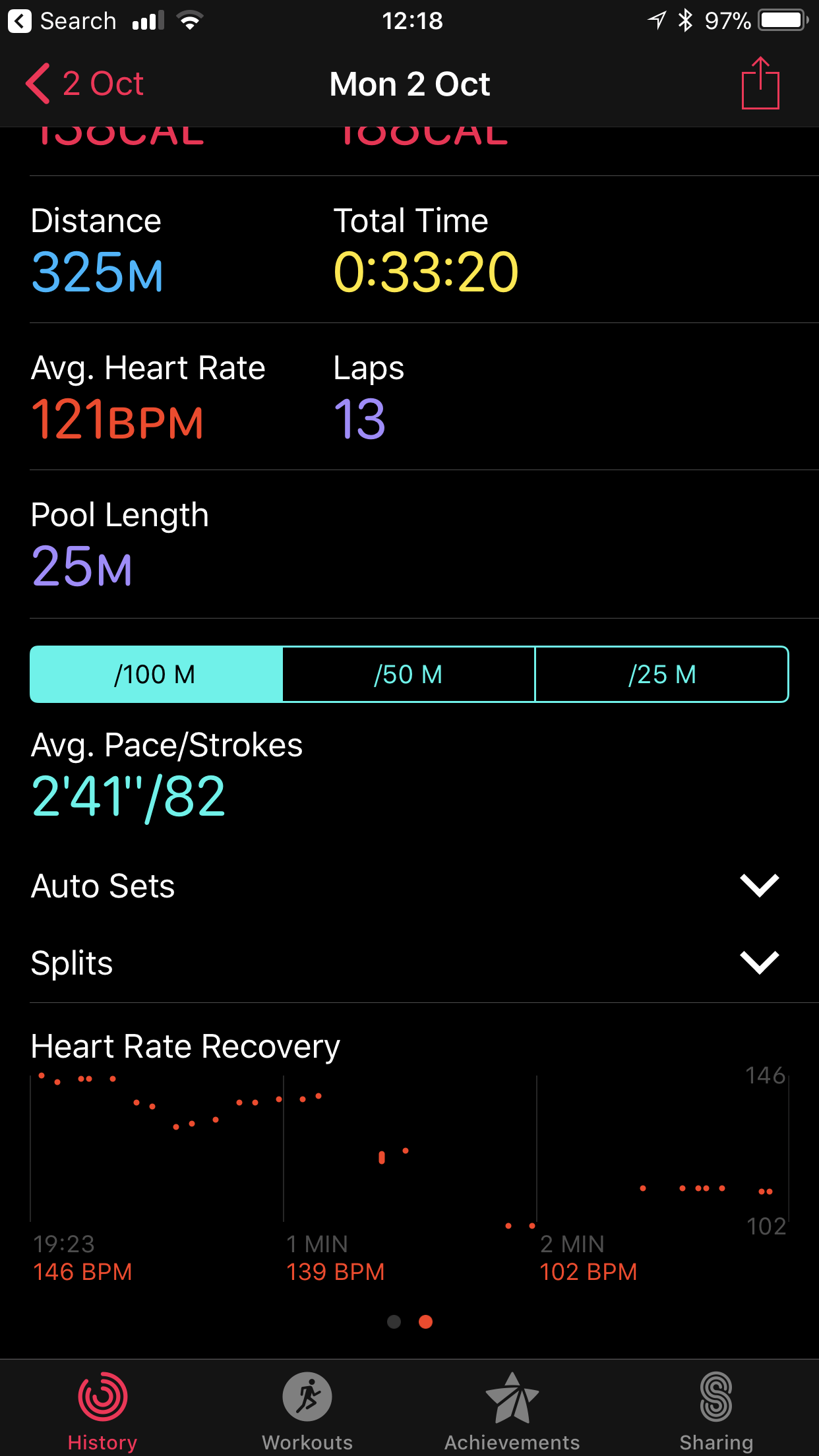

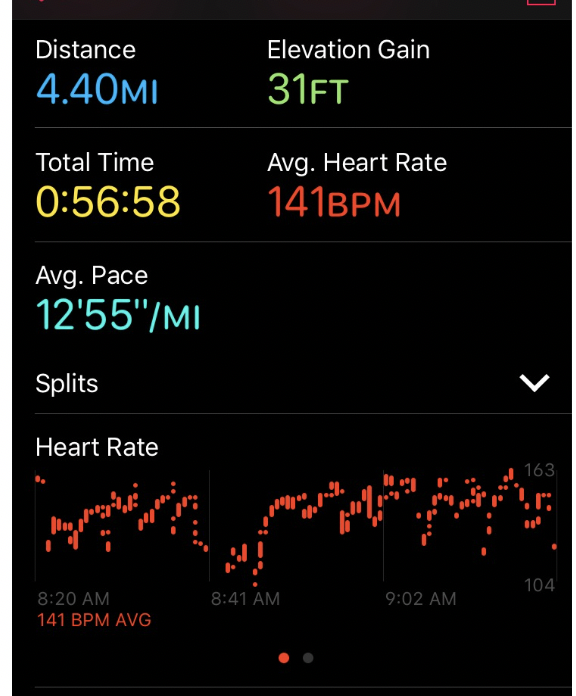

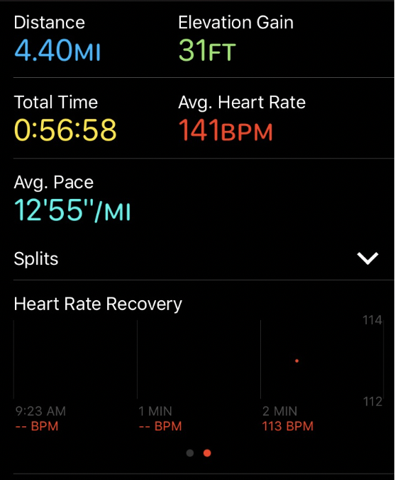

Strange. I’ve done two workouts this week. One has recovery data, the other doesn’t even give me the option to look at recovery data.
386432CC-52AA-41D1-A880-36F9EEC17AF6.png EEEAF4D6-B84A-4921-9007-D7FBA6812AB5.png
View attachment 724319 View attachment 724320
Ditto. This must be a bug or sync problem of some sort.
Some workouts I will have substantial recovery data showing in the Activity app on my iPhone, other workouts will show nothing at all - can’t even access the recovery screen on the phone - it's just blank when I swipe right. And as a previous poster said, I know the HR monitor is working because I get full data during the workout (and all day long, and with my sleep app, etc.)
I also just noticed this today - in my workout this morning, there is no recovery data showing in the iPhone Activity app. But if I go into the Heart Rate app on the watch itself and scroll down, there is recovery data from my workout, including the graph if I tap on it. So again, it's clear the HR monitor is working properly.

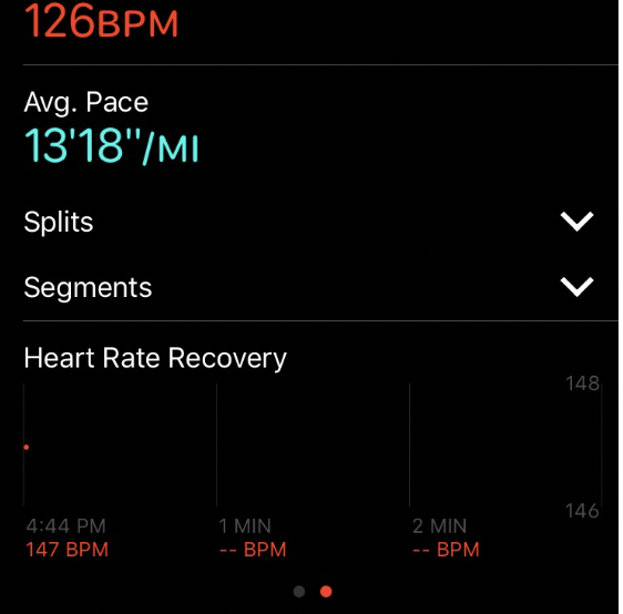

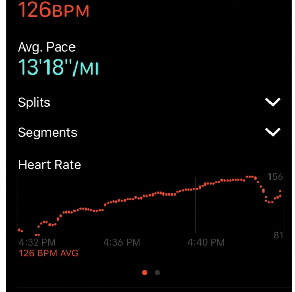

Interesting... Let me ask you this, because this is my current prediction (I have yet to test it).
On my workouts where it didn't work, I remember I hit 'end workout' the very second I crossed the mile mark (I was still running hard). After I hit end is when i sat down, got in the car and drove off (no walk-down)
My other workout, I hit end workout the very second i was done running, then i worked about 5 minutes to warm down (I hit end before I walked)
When you did your workout, did you include the warmdown IN the workout itself before you hit 'end'?
If you did that, (and its required for the warmdown to be in the workout), that seems like a very bad bug/feature because that will throw off all the times/distances/pace....
