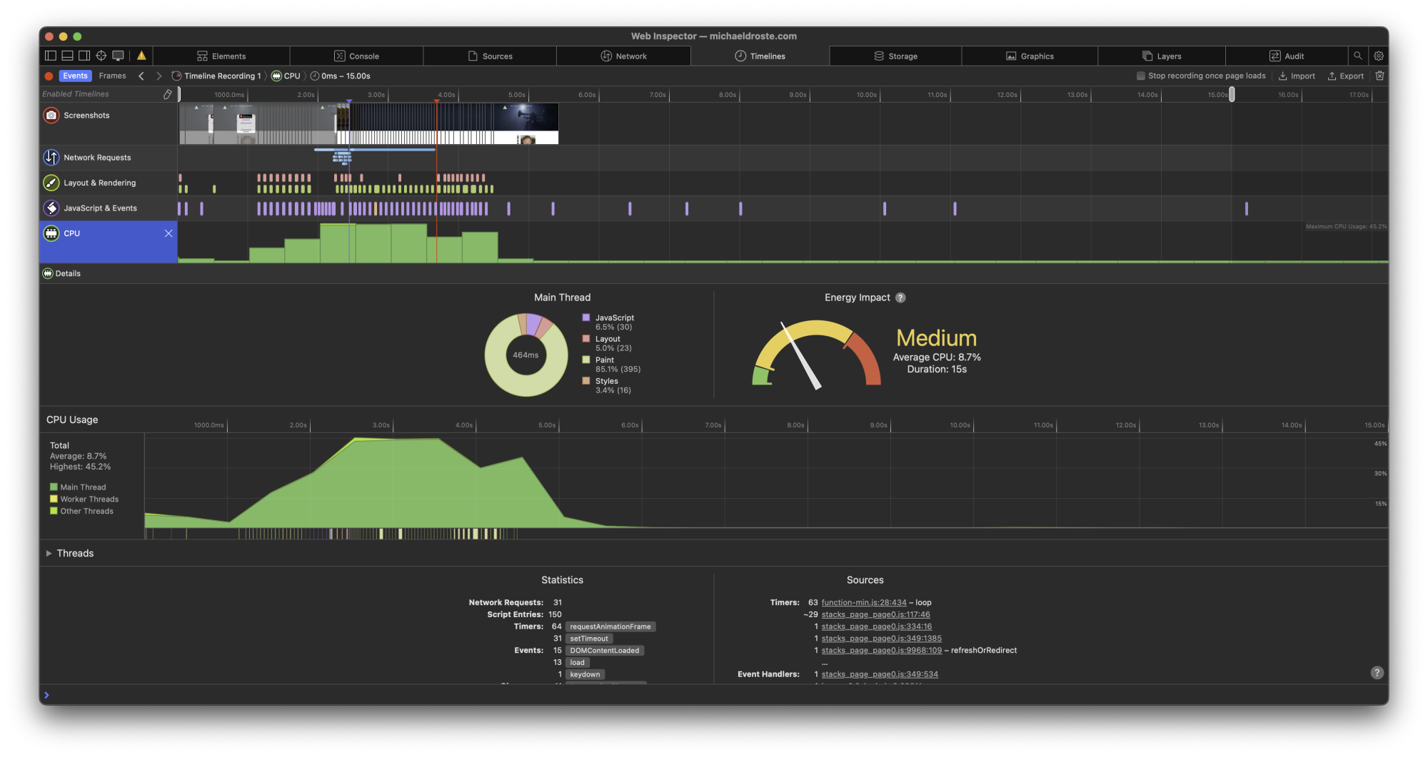

So, beyond the amount of active tabs, we’ve seemingly narrowed down the other culprits.
I’ve tried restarted the computer - did not change the swapping or usage - these are my sites … what would be causing runaway memory? Auto playing a header video?

You've got some runaway stuff on your website. In the course of 10 minutes of having a few copies of your homepage open in Firefox, I started getting high CPU utilization alerts and the fans on my new M4 Pro started spinning. Once I closed out, everything returned to normal.
I don't know exactly what it is on your site that's doing this, but there are some scripts there that are not behaving. LOL, did you just cryptojack us and use us to mine for Bitcoin?
Also, having lots of Google Drive pages open to MP3 players eats up more than a typical page in resources. You've got lots of heavies and baddies hidden throughout your inventory of content.

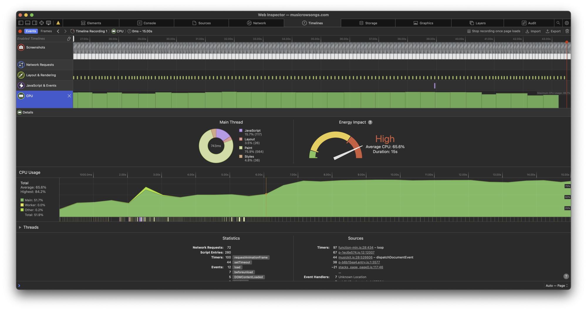

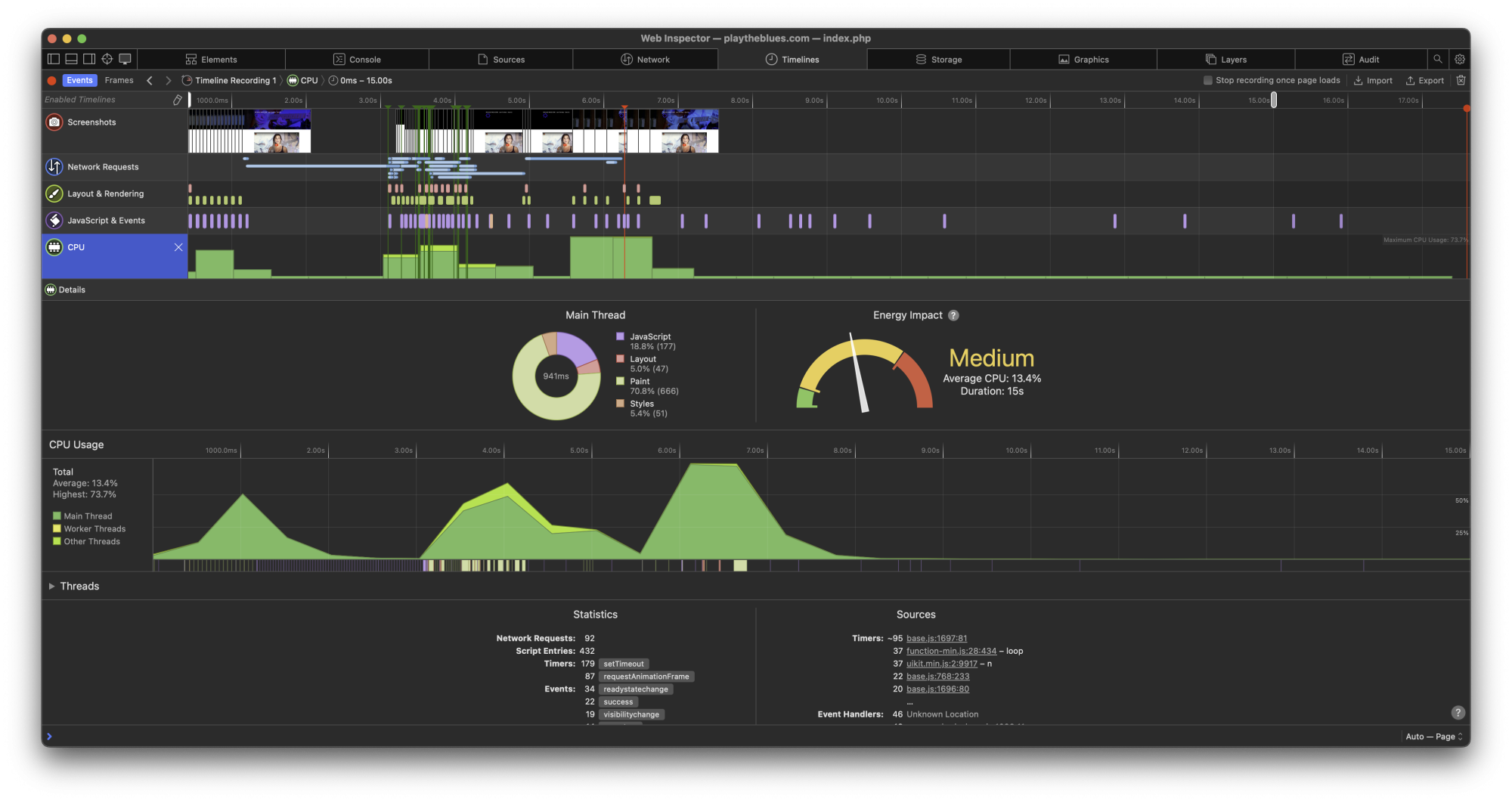

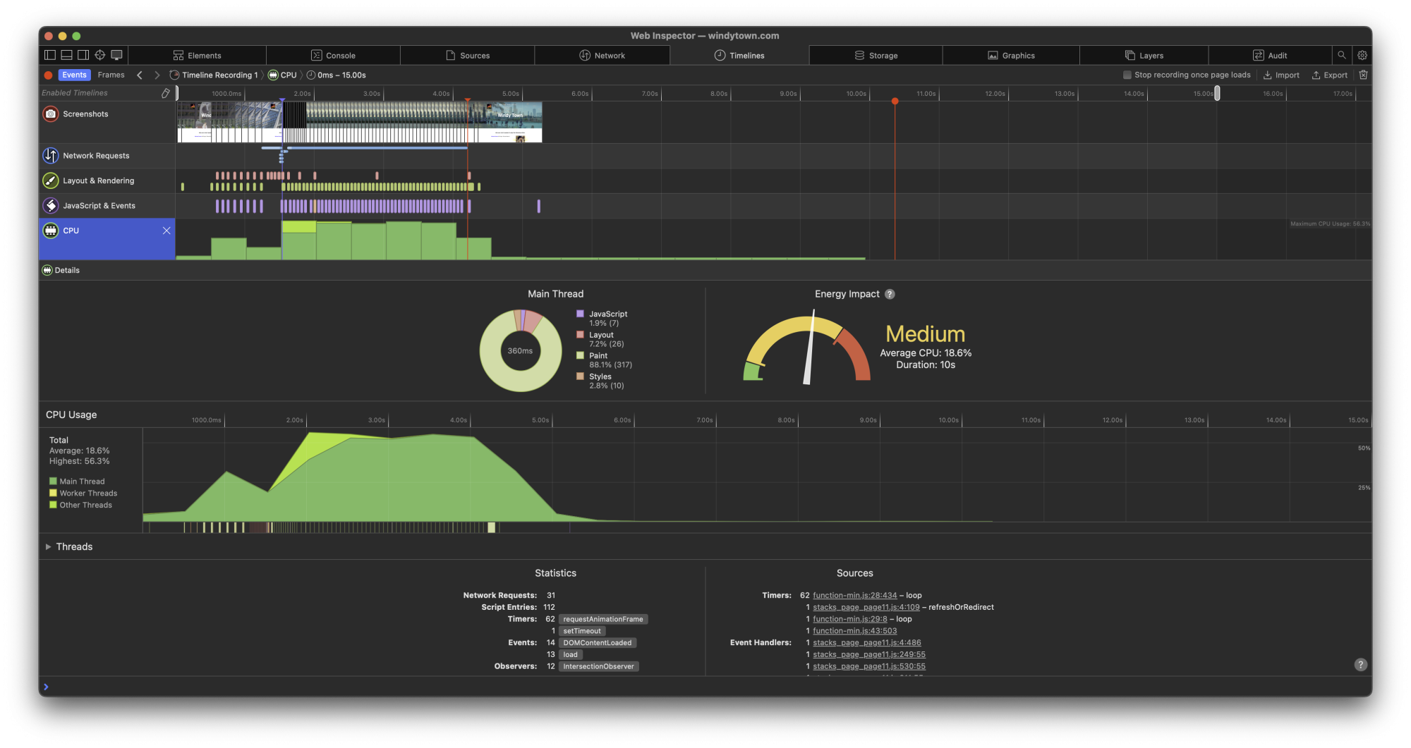

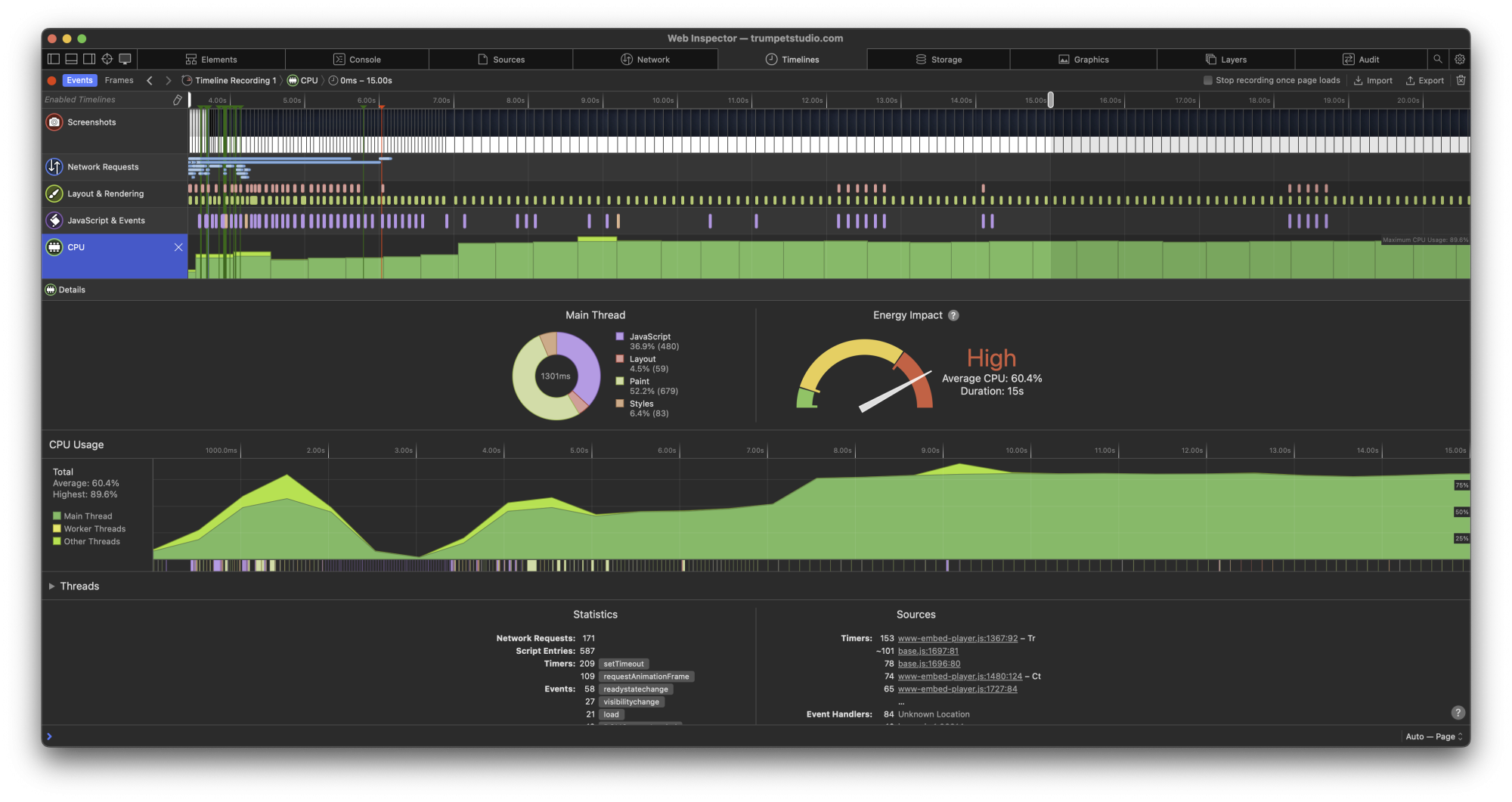

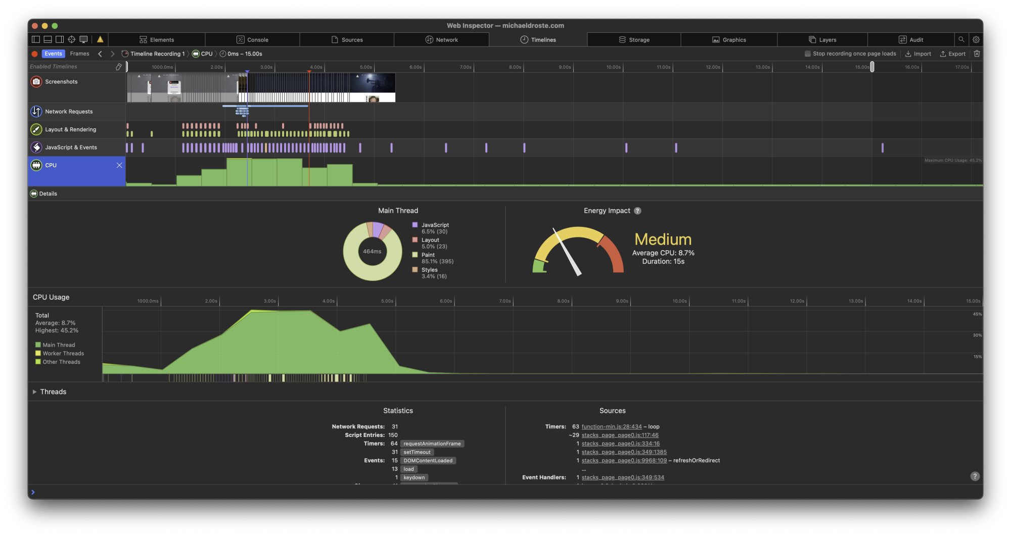

In which, we appear to be going down another path. With that said, I’ll provide these final notes:
Safari_Inspector-Timeline_MichaelDroste.pngSafari_Inspector-Timeline_WindyTown.pngSafari_Inspector-Timeline_MusicRowSongs.pngSafari_Inspector-Timeline_PlayTheBlues.pngSafari_Inspector-Timeline_TrumpetStudio.png
So, at least a couple have runaway events.
