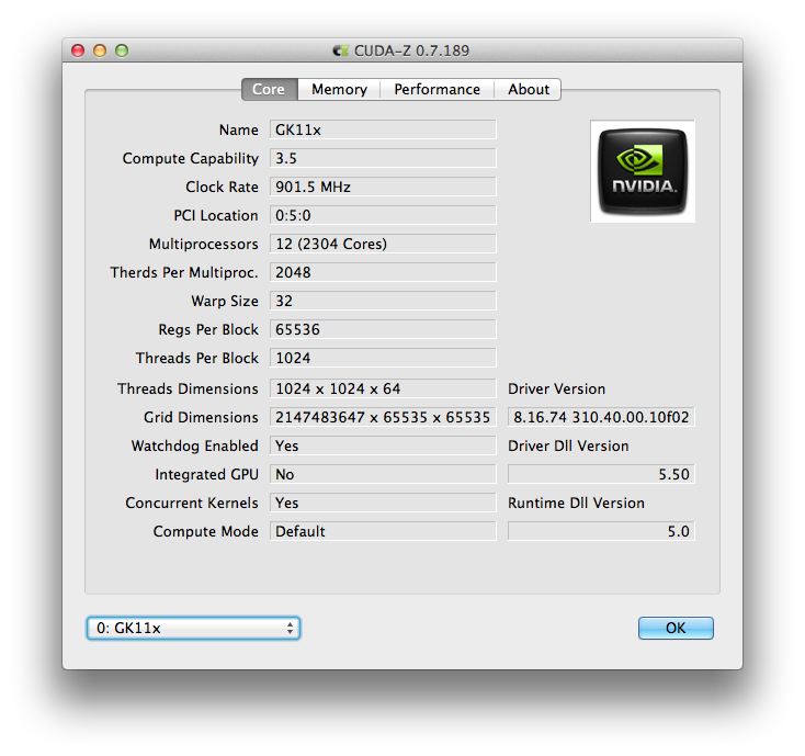

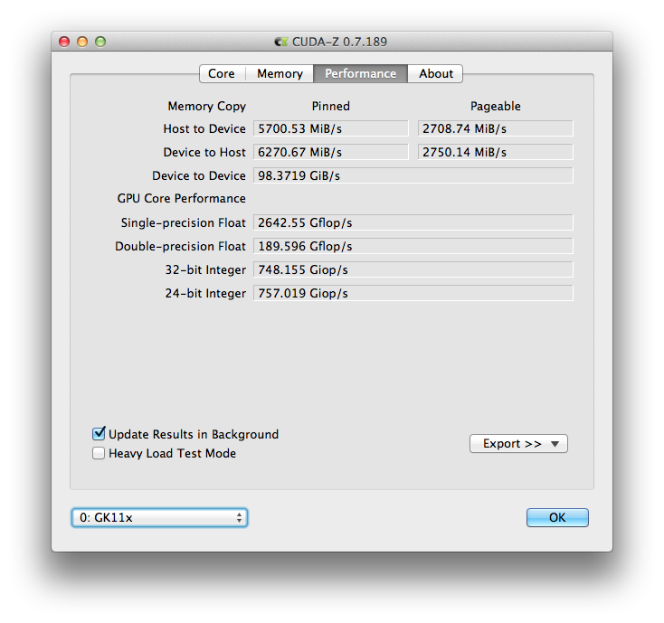

Based on your first posts' Furmark score and Cuda-Z, your card is running as it should. EFI firmware will not help you improve your performance. Save your money and upgrade your CPUs.

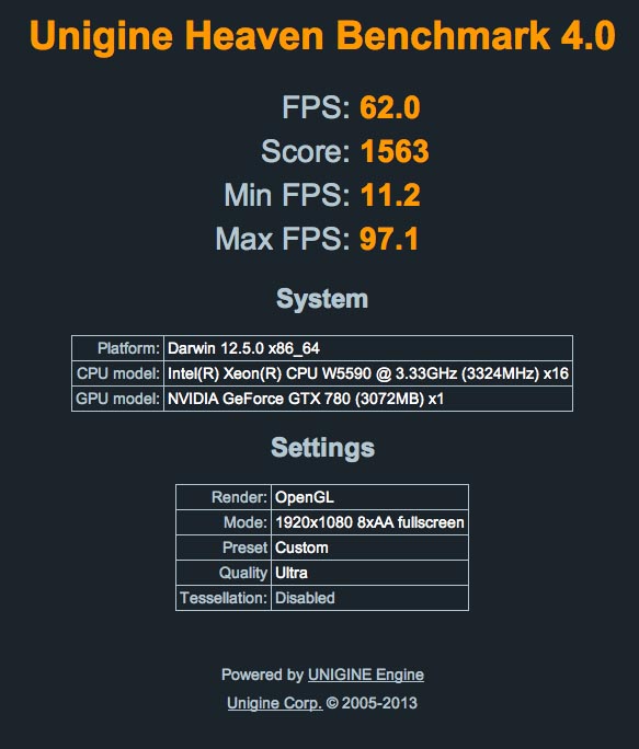

Notice how jetjaguar's results are better than flowrider's? The only primary difference is his 3.47GHz vs. flowrider's 3.33GHz. 140MHz was enough to knock 5 fps average and 20.3 fps on max fps off the score. Acceleroto is only at 2.40GHz...
I didn't think that was right, so this morning I reran using the same settings, but in ML with Apple drivers.
Lou
I don't think so in this case, since your baseline (jetjaguar) is running 10.8.5, as was everyone else. I think I was the only one on Mavericks. I was just trying to equal the playing field.
Lou
These results muddy the water a bit. flowrider's results are a bit better than jetjaguar's with all things being pretty much equal except CPU, where flowrider actually has a slightly slower CPU. Unless one of them has background tasks running, I can only deduce that with these settings, the GTX 780 begins to show its limits and where CPU is no longer the bottleneck.
Not definitely. To get full view we'd need to know what clocks jetjaguar's card has. Lou uses Gigabyte Windforce OC with Boost clock 1006 MHz and RAM clocked @1502 MHz. If jetjaguar's card is stock clocked one (i.e. 900 MHz Boost) it would explain why Lou results are slightly better despite the CPU clock difference.
