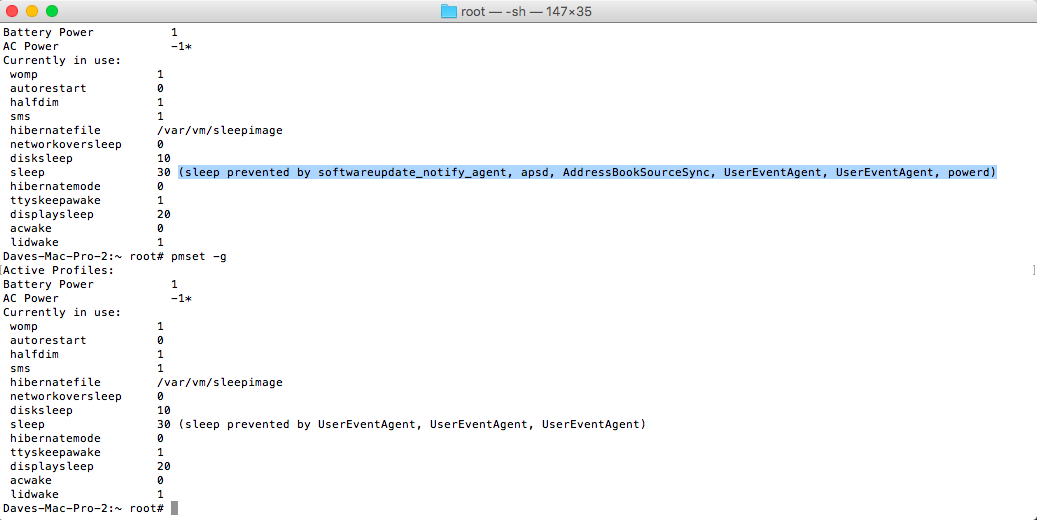

Ok thanks, that actually helped to find out the possible culprit. Sleep showed 30 and said there was a "user eventagent" as the culprit. Where are they located? I get different results from each use of the command

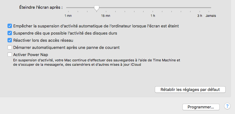

I've modified ( yesterday ) my prefer. System.like this

Now, all seam to be correct...... wait and see!
waking looks to be okay at each time.

Always take a look at the logs first as they usually reveal what's going on. Sometimes apps get stuck (due to being incompatible with the OS X version or because of a bug in the app) and prevent the machine to enter the sleep/hibernate state. This will be reflected in the log as you've already found out. Other things that are notorious for preventing sleep/hibernate: usb devices and network (doesn't matter if it is OS X, Windows or Linux).

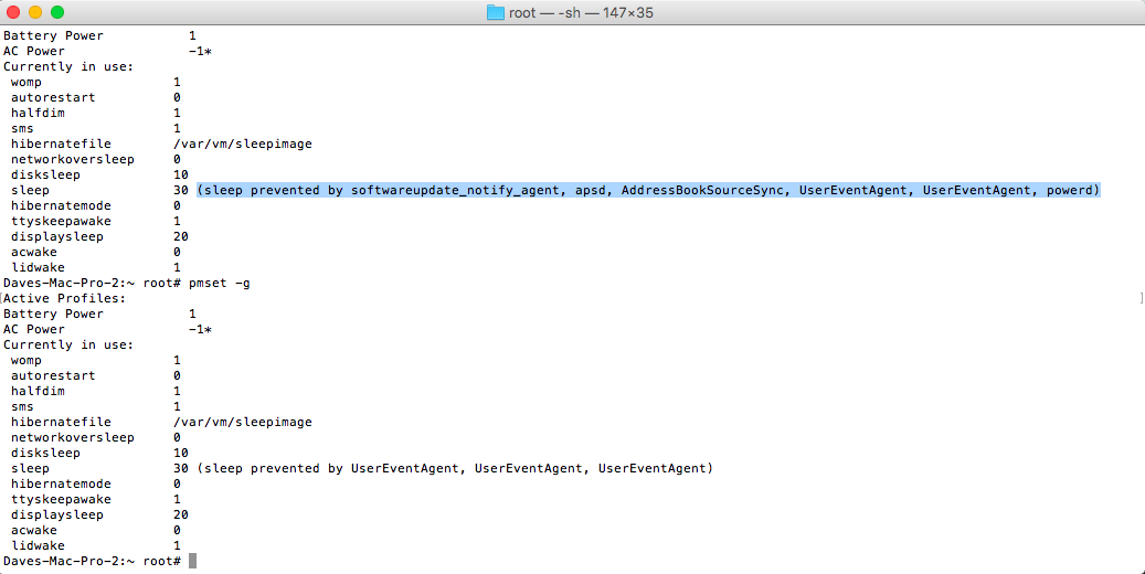

software_notify_agent is self explanatory. Do you have any software or updates waiting to be installed from MAS?
apsd is the Apple Push Notification Service
AddressBookSyncSource is also self explanatory.
UserEventAgent and powerd alone aren't going to provide that much information on their own.

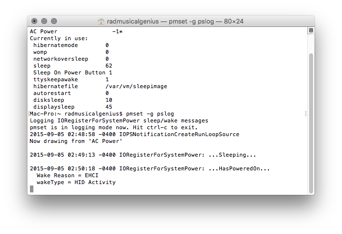

You could also run pmset -g pslog to get real time logging. When you have run the command sleep the computer, then wake it again and review the information.
You'll also need to cross-reference what's going on in Console.
Did you try a different user account? If not, create a new user account and completely logout of yours. Sign in to the new user account and try and sleep again. Does it still take 30 seconds?
Tried a different user account with the same result. Now it's actually saying 62 for sleep. I just recently installed the latest beta. Can I post the console log for you to take a look at? I have no clue about this stuff
