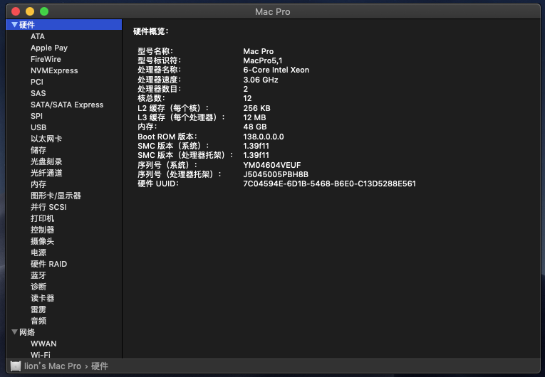

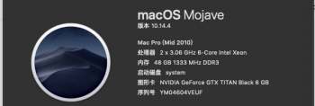

I started to upgrade the system from 10.13.6 to 10.14, the bootrom showed 138.0.0.0.0. Later I clicked on the mojave upgrade, the system became 10.14.4, but my bootrom still stayed at 138.0.0.0.0. I need to manually upgrade. Bootrom?
Thank you for your help.
You must download and run the full Mojave 10.14.4 installer to install the new BootROM. If you installed 10.14.0 and then updated to 10.14.4, the update installer will not contain the new BootROM.
To download the full installer, you must delete the file "Install macOS Mojave" from your Applications folder. After you delete this file, you can use the App Store to download the 10.14.4 full installer.
When you run the full 10.14.4 installer, you will be prompted immediately to install the 141.0.0.0 BootROM. After this BootROM is installed, you can cancel the Mojave installation.
