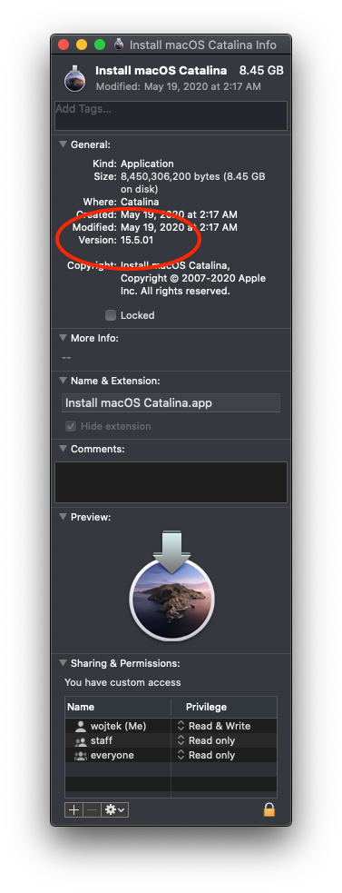

I believe if you used dosdude1 Catalina Patcher it downloads 15.5 anyway:

Try with
Code:
open "x-apple.systempreferences:com.apple.preferences.softwareupdate?installMajorOSVersion=10.15.5"
Thank you for that, it downloaded Install macOS Catalina. Still not sure why the MAS still only shows 10.15.4.
