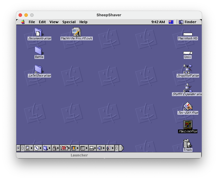

I tried a 4k, 3840x2160 monitor, and set it to 2560x1440. Because it wasn't a neat fractional scaling, everything looked a bit fuzzy. This has also been mentioned in various places on the Internet.
So I saved some money and bought a QHD, 2560x1440 monitor. It looks better than the more expensive monitor scaled down to 2560x1440.
As said above, it's what suits you.
If you want to use a 3840x2160 monitor, set to 3840x2160, then you will get the best setting.
If you set to it 2560x1440, it will look fuzzy. Get a native 2560x1440 monitor, you will save money and it will look better.
Anyway, some of remember when all you could get was 640x480, and we were all happy with that.
BTW, the reason I am quoting resolutions explicitly is that around here, the advertising is a bit fuzzy about what UHD, 5k, QHD, 4K, HD, 2k, etc, all mean.
