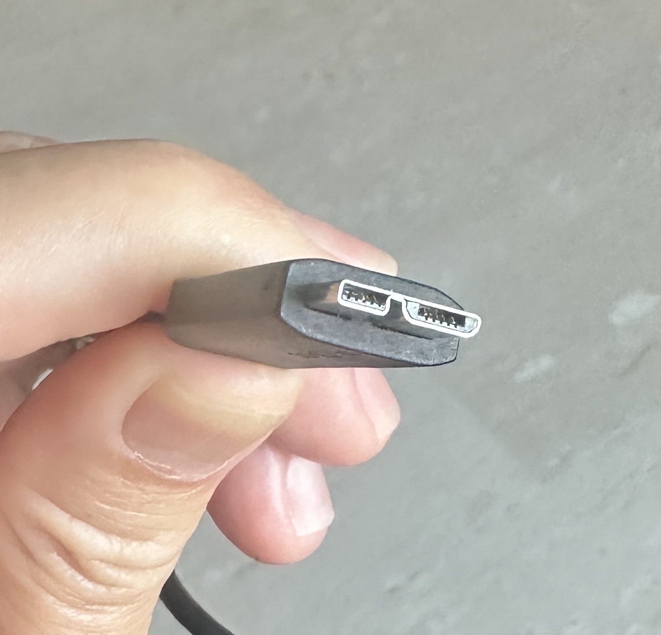

Micro B comes in two variants, the small one that does up to USB 2.0 speeds (480Mbps) and the wider, two-part one that is USB 3 (5Gbps). A USB-C cable can be anything from USB 2.0 speeds up to USB 4/Thunderbolt 4. I agree that the cable that came with the SSD in 2024 should not be a slow USB 2.0 cable, that would be weird and crazy and stupid.
Tks for all the info and help. Its very informative. This the micro B cable. Whats the carrying speed?

EDIT: The connector in your photo is USB 3.0 = 5 Gbps
Hey Tks,
Since you can verify my adaptor is not the issue, it narrows down to the C-C cable. I hv written to the agent and awaiting for his reply. I hope he will say the C-C cable is merely a charging cable and not meant to transmit data. Otherwise it opens a can of worm again and I'm gonna pull my hair out.
