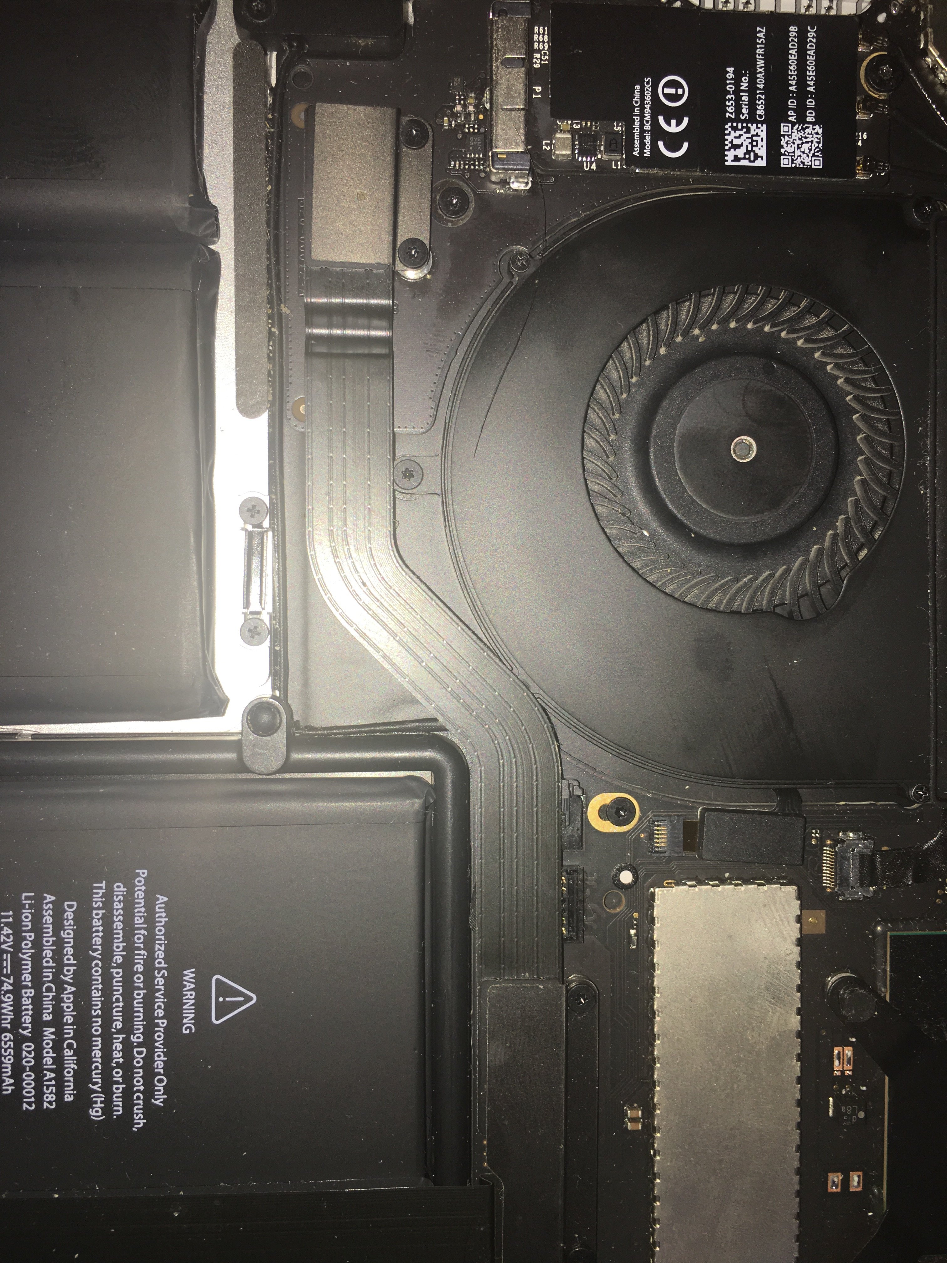

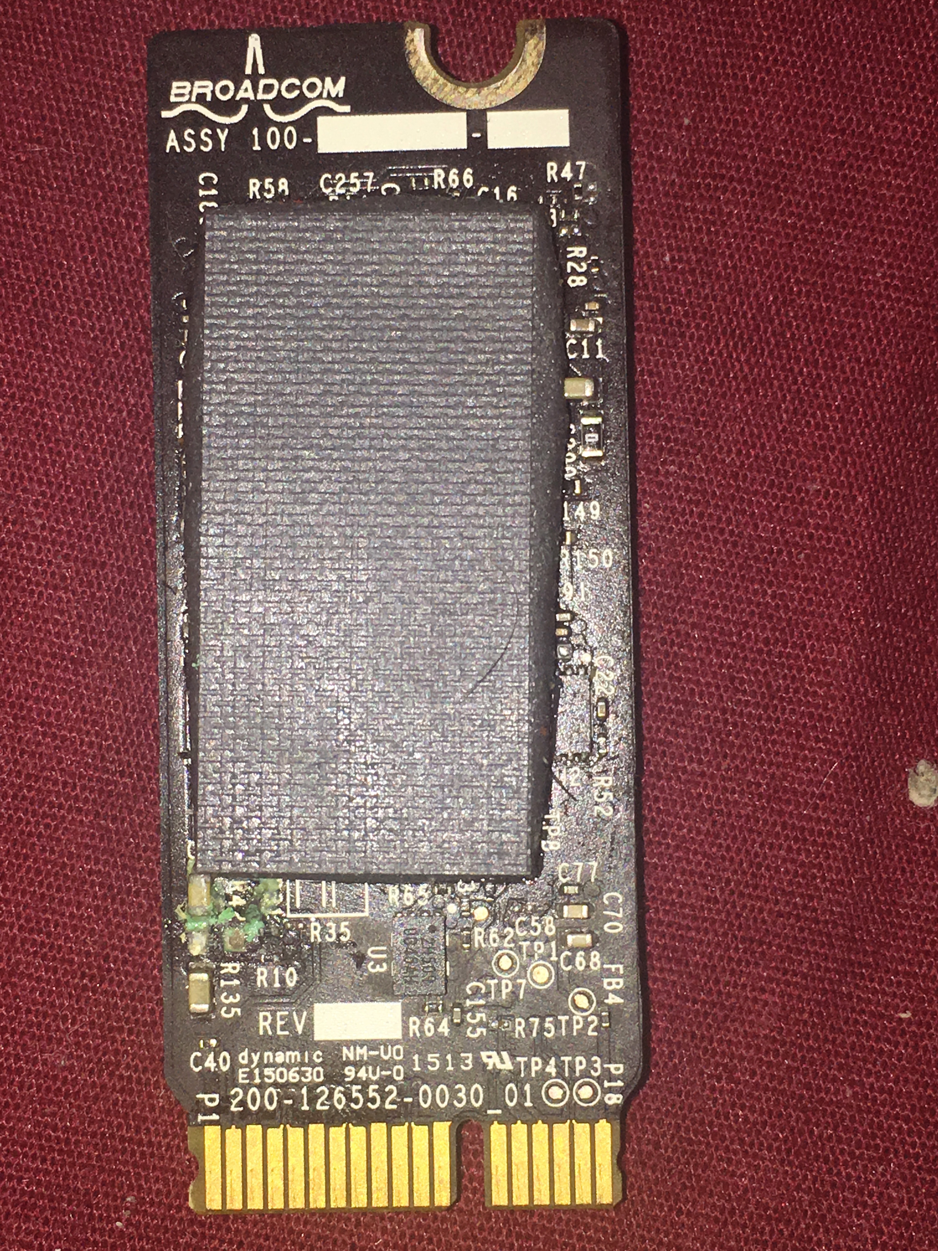

Okay so I open my MacBook pro up.
All the wires seem to be fine but the Airport card has this minute green substance on the bottom. Should I remove it?
Here's the picture.

Possibly, either way it's very likely you'll need a new wireless card.
Alright, I'll try to get a new one now. Thanks for your help.

The ribbon cable is there, but the wireless card has corrosion on it. How that got there, I do not know. But it has damaged it to the point were the WiFi part of it no longer works.

I would like to thank you all your suggestions (both demotivating and motivating) guys but literally all I had to do was clean it and place it back. Although it was still not working last night, I tried running a diagnostic today morning by pressing the D key after powering the device on. The diagnostic completed with zero errors which I really found absurd. I restarted and Voila! Wi-Fi was back just like magic. So at the end of it, looks you can add cleaning corrosion to the endless list of solutions too. It may even be my good luck but at the end of the day it saved me from a expensive trip to the Apple Store where they would probably ask me to take out 700$ to replace the entire motherboard. LOL

I would advise you to be really careful, for one simple reason:
You don't know where the corrosion came from.
And there's nothing in there that ought to be able to produce corrosion like that if it hasn't failed in some way. So maybe a capacitor blew and leaked goo, who knows. But something happened. And it may happen again, or it may cause other damage. Downside, if you don't have applecare, checking it out will presumably cost money. But I'd be pretty concerned.
