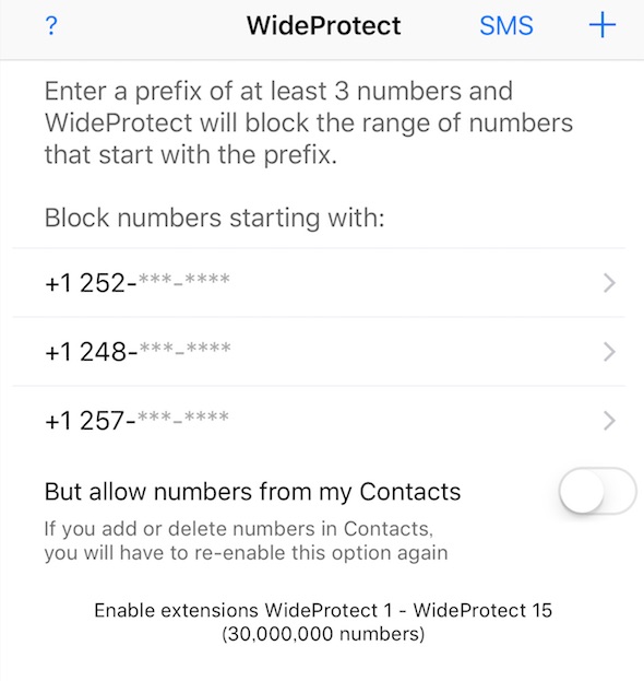

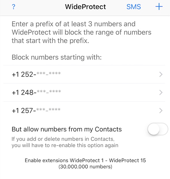

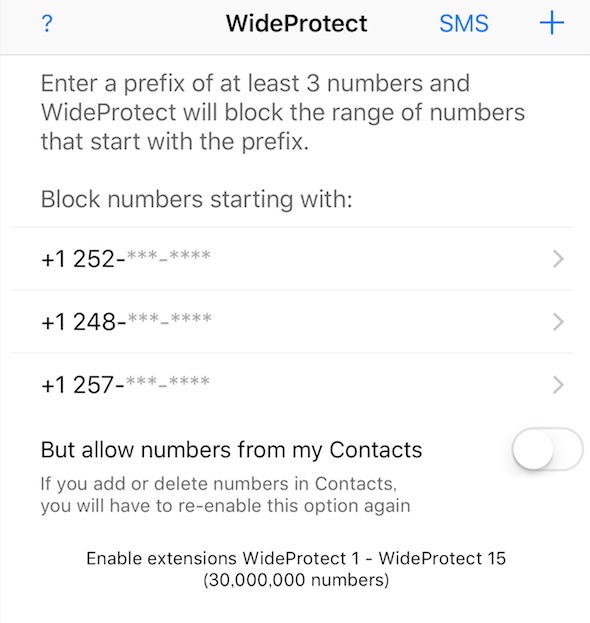

For the past few months, I keep getting calls from numbers starting with 252, 248 and 257. Recently, the calls are more often 5-10 per day. Usually the last two digits are different but sometimes same numbers. They ring once or twice and then hang up automatically.
The settings I have in WideProtect are:
Block numbers starting with:
+1 252-***-****
+1 248-***-****
+1 257-***-****
The +1 were entered by defaults. Do I need to take off the 1s? They are there. I can't remove them.
+1 252-***-****
+1 248-***-****
+1 257-***-****

Did you changed prefixes as I suggested? Could you provide current screenshot of WideProtect?
And, do you use DND mode?

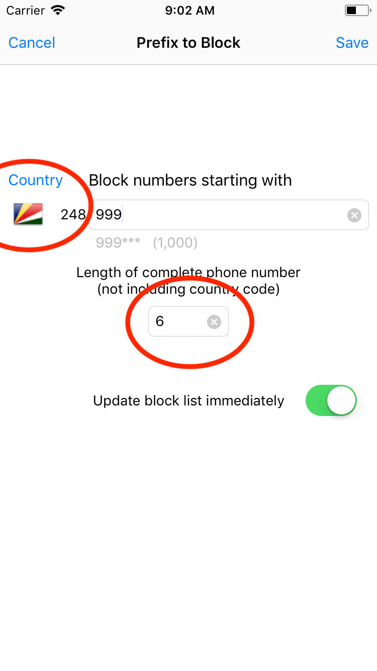

Hi valerii, enclosed is a screenshot of WideProtect. How to change the prefixes? I cannot find your suggestions. What is DND mode? Today I received a call from +248 999908. Yesterday, I received calls from: +248 999901, +248 999909, +248 999910, +248 999903. Do I need to remove the "1"? I cannot remove it.

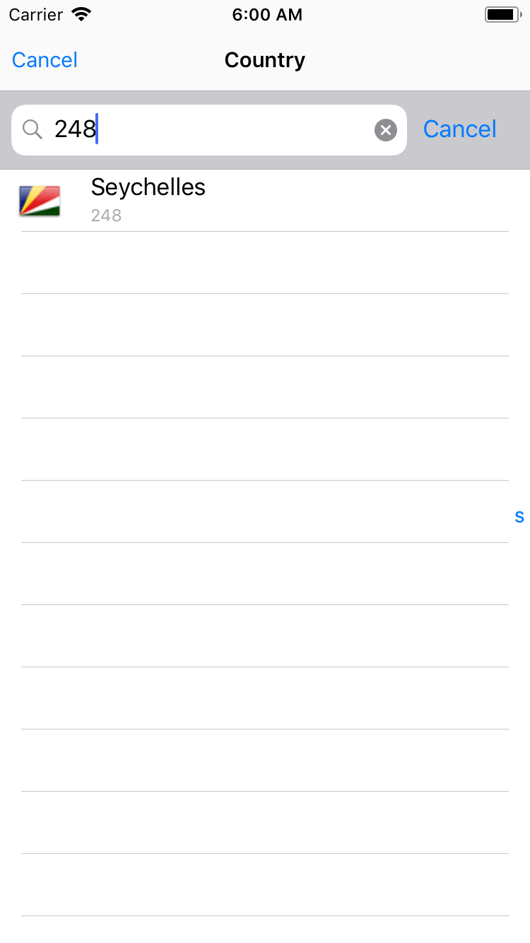

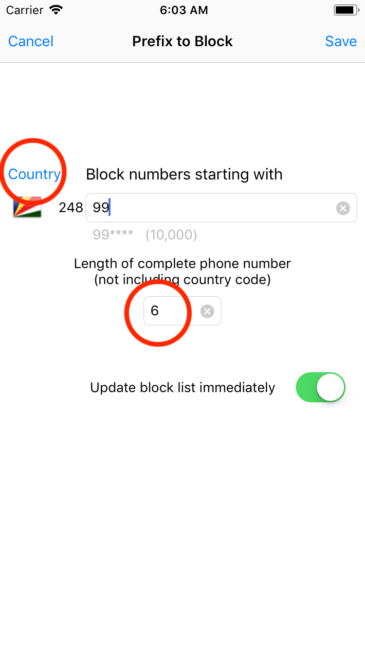

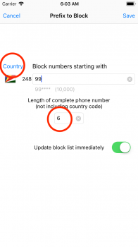

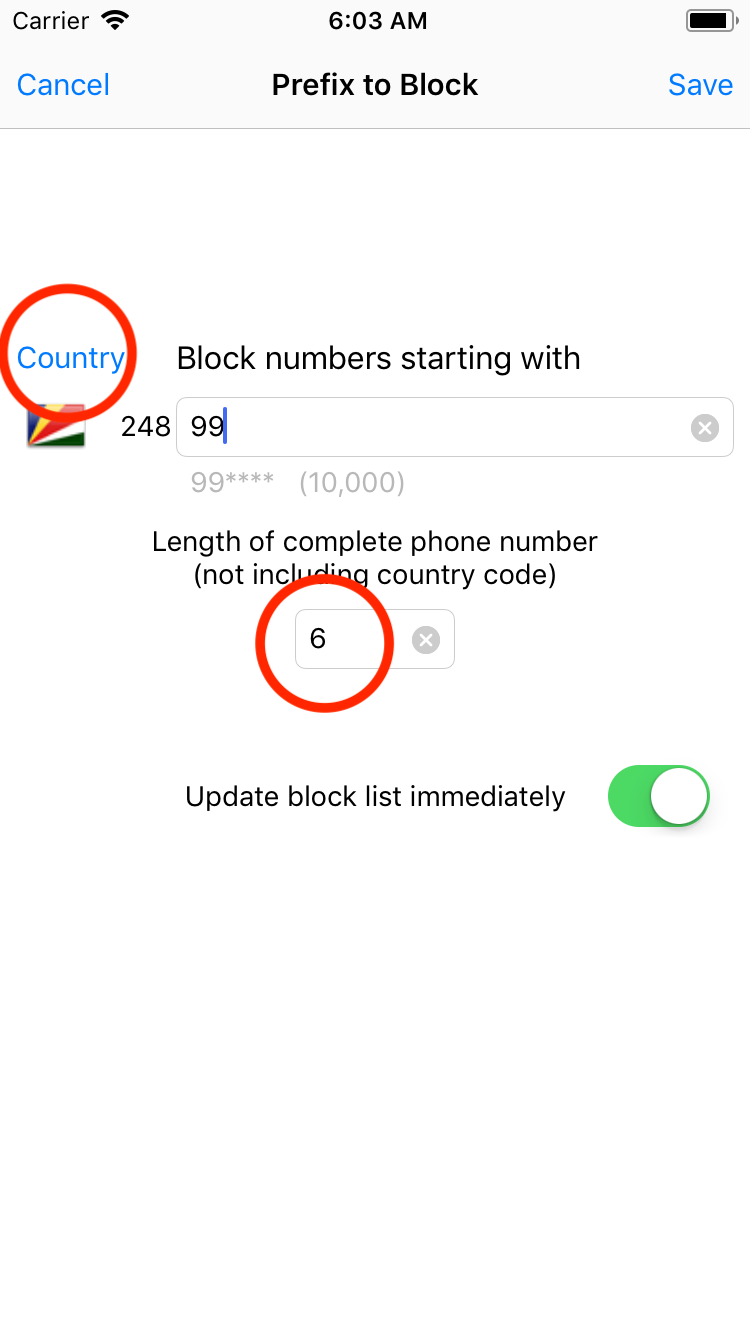

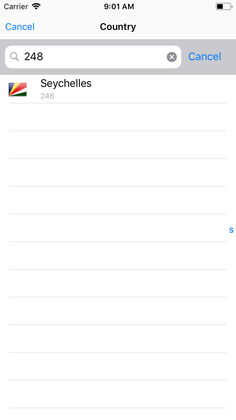

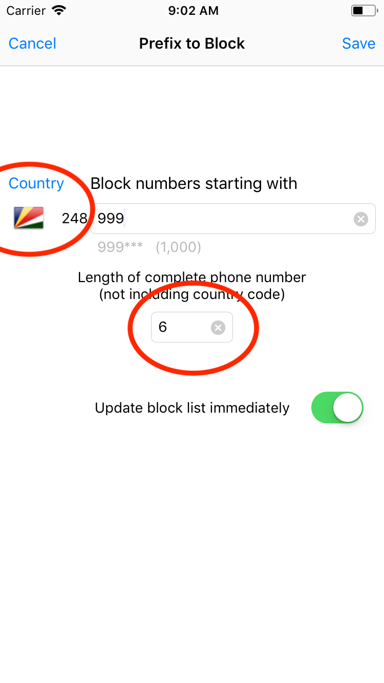

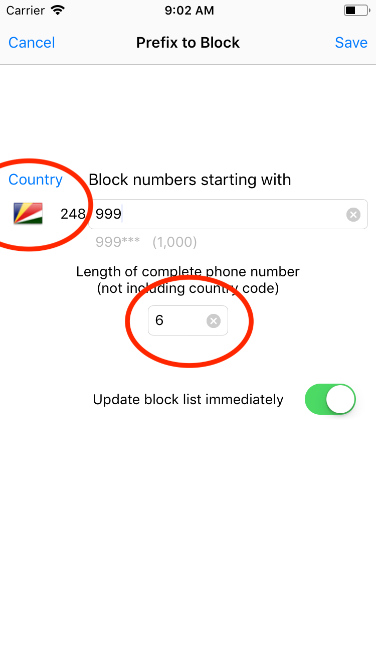

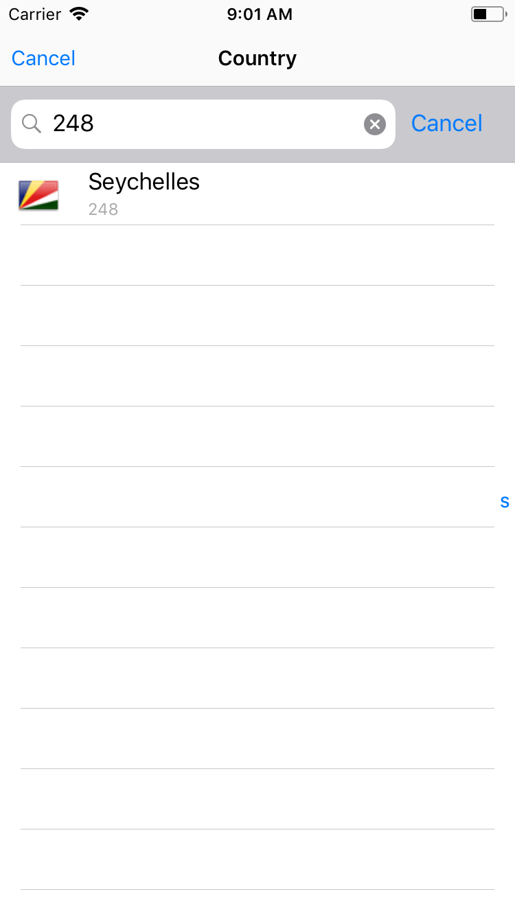

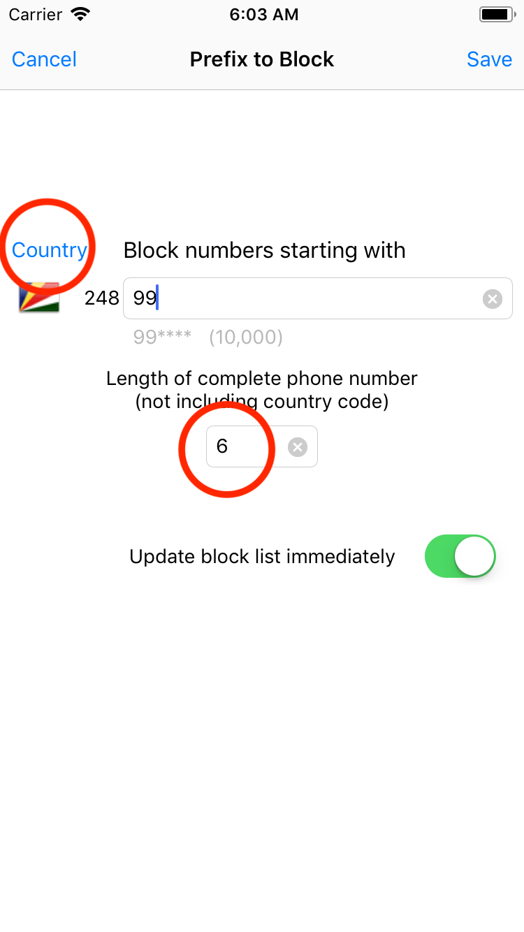

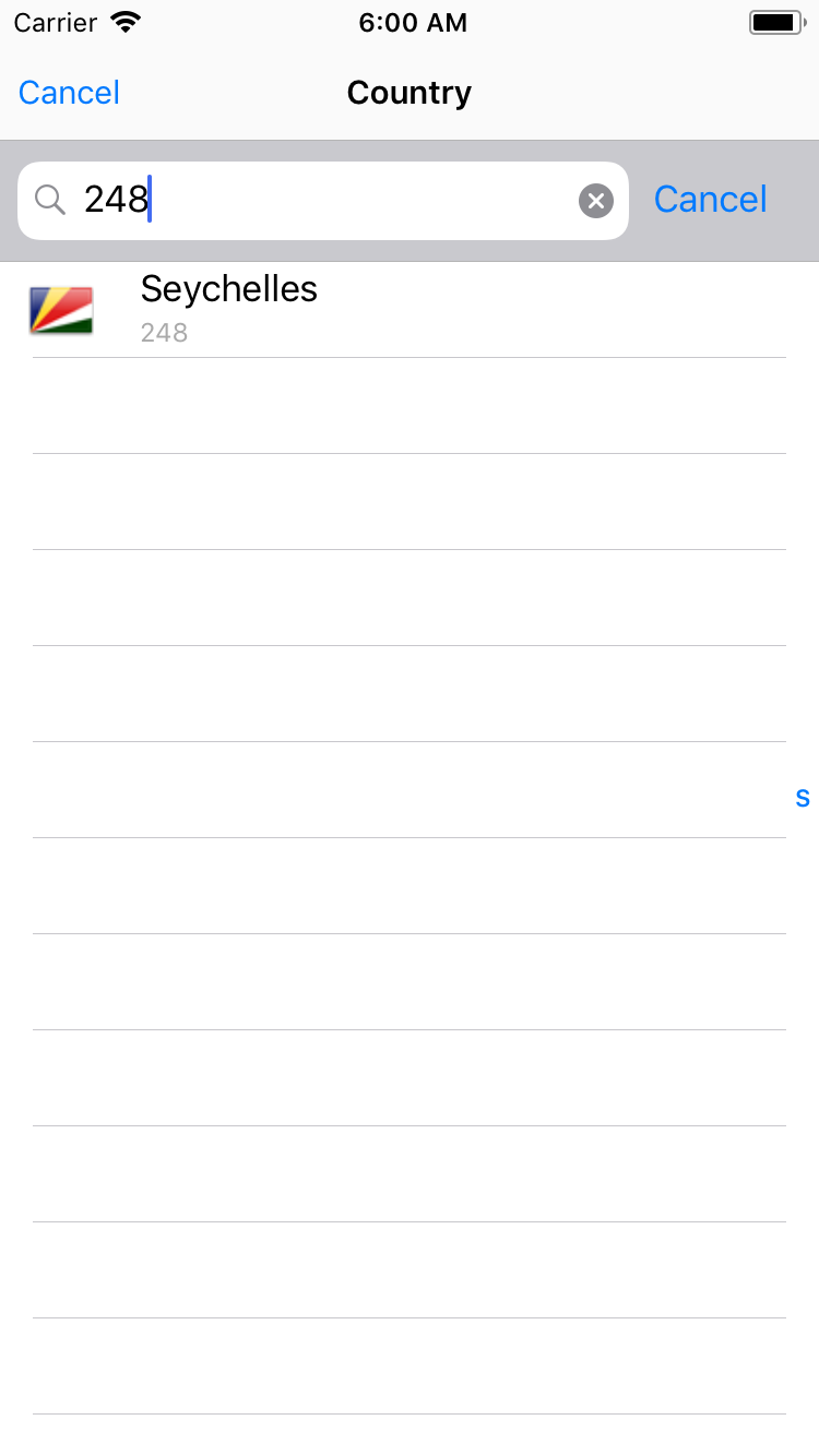

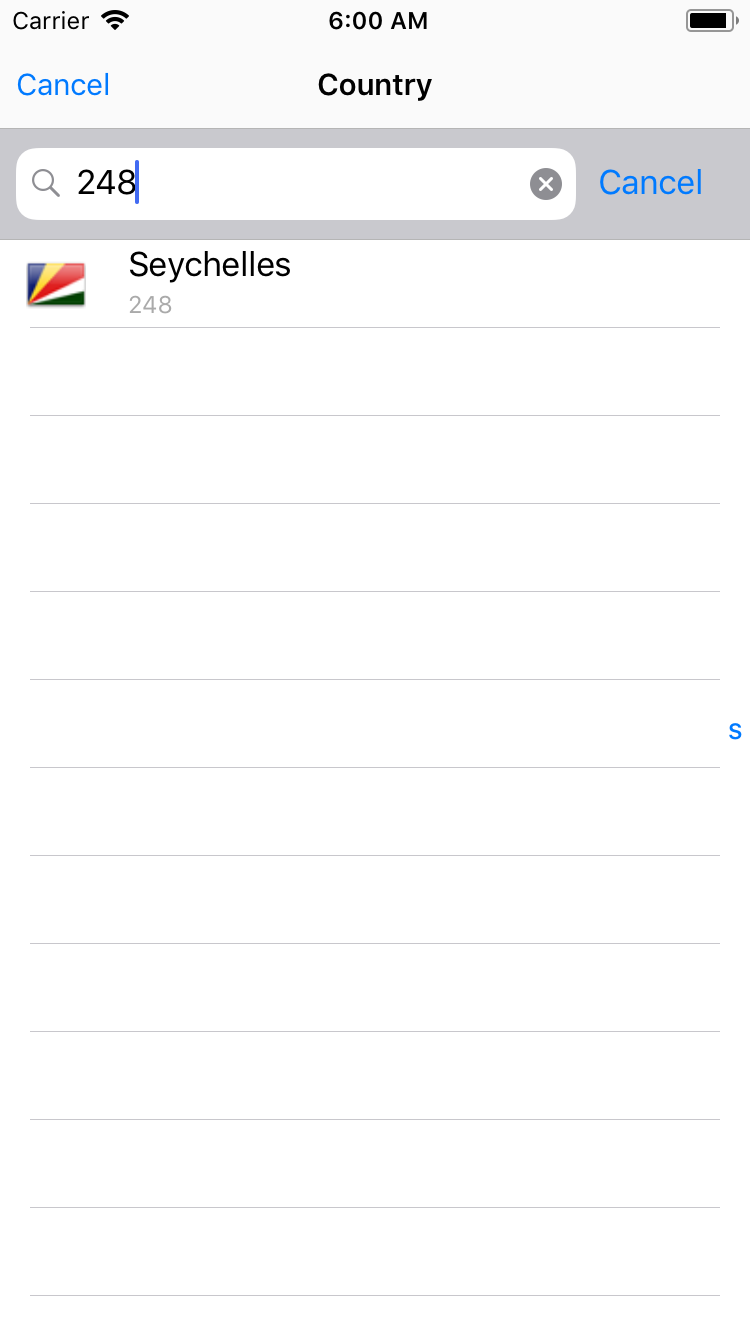

Hi hajime,
Incoming calls have "+248" country code and 6-digit phone number after that, so you need:
1) remove prefix "+1 248 ..."
2) add new prefix:
- tap on "Country" button and select "Seychelles" as country (see ex01.png)
- type 6 in field "Length of complete phone number" and type 99 in text field (see ex02.png)
And check other prefixes in the same way.
